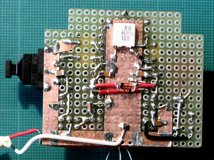

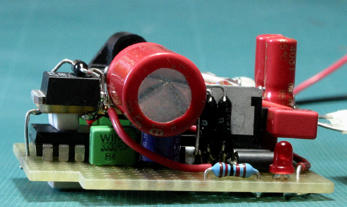

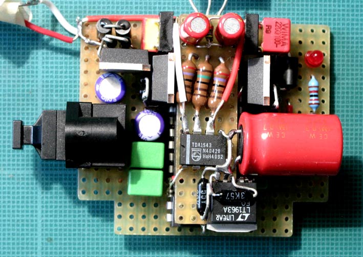

I built my first nos 'DanDac' [sorry Peter😉 😀 ] over the weekend.
It is designed for portable audio use and therefore intended to
be permanently connected to an amp and enclosed in a single small box.
I first connected it to my Stax 4040 /Arcam CD23 rig........
And it worked!
Powered by a tired pp3 9v battery and using a crappy string of
plugs tacked to the outputs, the sound was...surprising.
Compared to the Arcam I thought it lacked a little in dynamics
but hey!
When connected to a small op based headphone amp [a design
called the Pimeta..check out head-fi] and supplied a signal by
a Sony dj925 pcdp ,listening through Beyer 931s, the sound was
far more dynamic .
A system synergy thing I guess.
What to make of the sound?
I don't know yet.
I had consumed a couple of fine ales and it was rather late when I
auditioned it.
Initially I found myself wondering about the treble levels not being quite there.[My stax setup has a quite well lit sound]
But there was also something rather nice about vocals that grabbed me too...
Definitely something different from the norm here..
On the whole a thumbs up thus far.
Thanks to everyone here who has given advice and steepened my
learning curve😀 😀

is there a contest underway for who can build the smallest DAC?
This is the second tiny layout posted here in a week 🙂
You seem to be using BG N caps. You probably know it by now, but polarity on those caps is quite important. My preference is for Non Polar (marked) lead to be on pos. supply and on the input signal (from DAC).
If you are missing highs, Rikens are the way to go. They were the best of all resistors that I tried.
Very nicely done, BTW😉
PS: Those are not OsCons in receiver bypass?
Hi Peter
I am pleased you like it.
As you can see, it was inspired by your 'ultimate dac layout'😀
The caps have their long lead acting as 'positive', I used the
polarized BG caps as a guide here, hope this is correct?
And yup, those ARE Oscons you see...
As for the Rikens, I would love to try them but availability in the UK is zero.
Ordering from the Netherlands is a possibility, but it can
be costly for just a few resistors!
The resistors I have used are a tantalum variety from a company in the UK called HI FI Collective, they now stock Audio Note's range
of discreet components.
I have not compared them to any thing else though,just stuck them in there on blind faith...much like the rest of the project..hehe
On the whole I am pleased with the sound of this unit😀 .
And that sound certainly has 'something' about it.
Cheers

Bricolo said:Nice looking board!
I see you're using the LT1963, have you compared it to other ones?
Hi Bricolo
Thanks.
I have not done any comparisons as yet.
If I recollect these are the quietest ldo regs available.
I am listening to the dac [or should that be listening to music] at the moment, it sounds great😀
This is is going to be one killer portable setup😀
Cheers

setmenu said:The caps have their long lead acting as 'positive', I used the
polarized BG caps as a guide here, hope this is correct?![]()
guzzler said:sorry for my ignorance, but what advantage does putting the Black Gate Ns with one side to positive?? Surely by definition the N is non-polar? I've just finished something using the N-types and didn't bother worrying about that, and it's got different orientations in different parts of the circuit:
Well, although BG N are non polar, they are still directional, and short lead, or NON POLAR print, marks the start of the foil.
It is only my personal experience, but in my setup the caps sounded better when short lead was on positive supply. Also, for coupling, I prefer to connect output from the chip to shorter lead. The difference in sound is quite noticable. It is also in line with shielding properties of outer foil, which is recommended to be either connected to ground or to be on the output.
As to the OsCons, if those are the cheap ones with magnetic leads, I recommend you replace them by BGs N type. On the receiver, I don't see a need for anything bigger than 4.7u and smaller caps actually sound better, providing more presence. Those OsCons were far from sounding right. (This may not apply to the better, for audio, grade).
If you do all those changes, your highs should improve😉
Hi Peter
Well it seems my BG caps are connected oppositely from yours then.. hmm. [not really practical to change them now....on to the the next dac then!]
As for the Oscons they are the non magnetic audio grade SP variety [22uf].
The minimum cap values I can use are in part dictated by those
LDO regs, the data sheet states min 10uf.
I was intending to put 33uf BG N caps into the next model,
I am a little reluctant to use exactly 10uf [besides space considerations] due to tolerance allowing values to fall below
the regulators required minimum 10 uf.
As for the sound of this unit, It does have it's own signature of
course.
Sometimes I find there to a little excess energy in some of the mids.
As to how much this bothers depends on material.
At times I can find it the devils own job assessing the sound of audio equipment.
I look forward to hearing the next dac with those few component changes [whatever they ultimately may be]

setmenu said:The minimum cap values I can use are in part dictated by those
I wouldn't be that much concerned with reg datasheets. One way to decide on the best caps is to mount sockets and switch caps conveniently. I tried 33u BG N at the receiver and the sound became too thick and with less presence to my taste. I believe that 10u might be actually the best choice (in BG N caps of course, as other caps may behave differently).
My experience with AN tantalums is that they lack high frequency extension (very good midrange, bass and body, but lack of air).
My experience with AN tantalums is that they lack high frequency response (very good midrange, bass and body, but lack of air).
You hit the nail on the head with the tant description!
