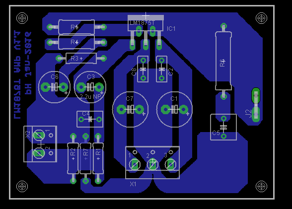

My First LM1875 amp

Updated layout, position of C5 and R6 swapped
@kcray,
about your layout:
I'd recommend that you align your e-caps on one line and also change the positions of the C3 and C6 caps (because the input cap should be further away than the power line, i.e. C7 and C1).
You should also rotate the input terminal by 90° counter-clockwise, then reduce the width of the input line, and finally surround it by the ground line (so as to shield the input line from disturbance).
