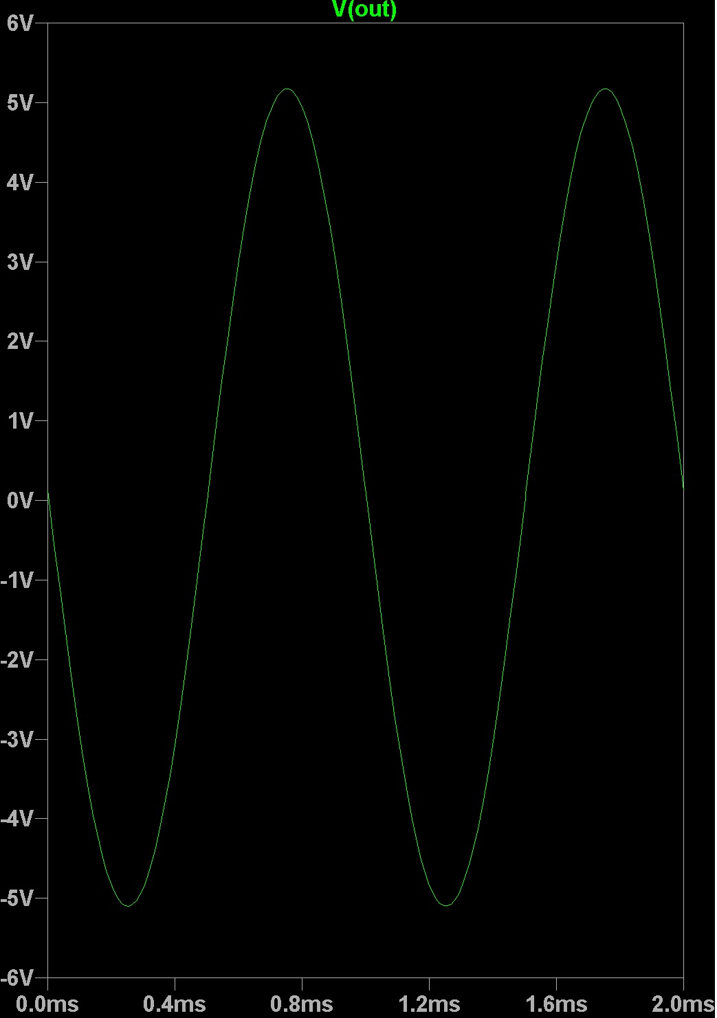

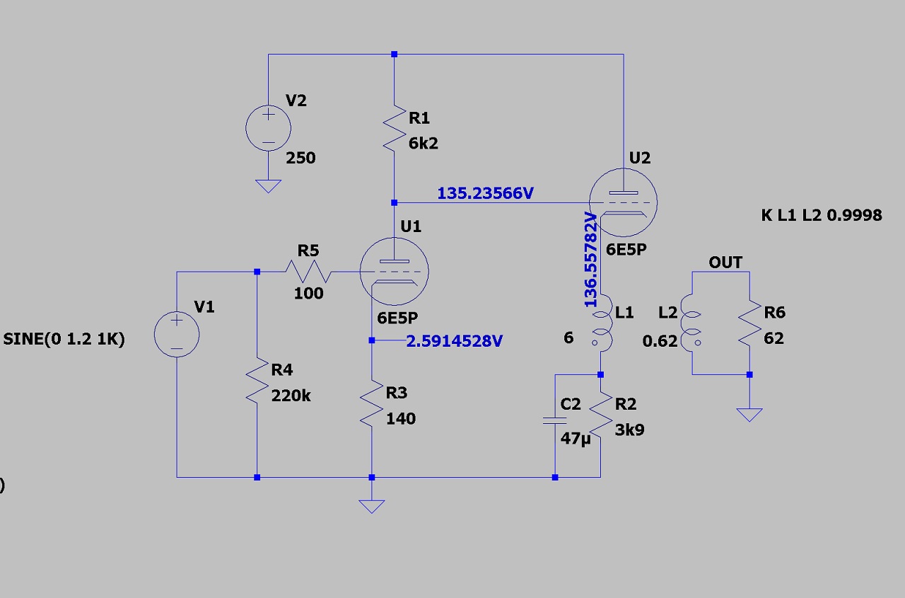

A few months ago, I became the proud owner of an AKG K-701 headset. However, I do not have an amplifier. I would like to make my first headphone amplifier. I am attaching the scheme and I ask you for your opinion.
Simulation shows THD less than 0.2%
