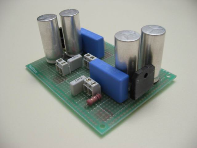

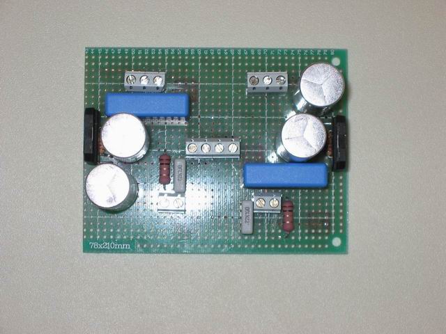

My First Gainclone have background noise
This is my first DIY project . I am happy with the sound . Except, I have a constant si--si--si sound if I put my ear near to the speaker unit . The background noise do not go up with the volume ,but I still think it could be a problem when listening . Any suggestion to kill the background noise ? Please .
I used LM3875TF and followed Greg's NIGC design . The 50K pot is omitted as I use pre-amp to control music volume . I built it with cheap componets and hardwire them together . all carbon film resistors, NCC 1000uF and philips MKT box capacitors . I am using single Airlink 300VA dual 25V AC toroidal for both channels .
Felix,
Looks very nice. I hope when you tryed the amp you used a heatsink .
First check if the noise is there if you disconect the amp from the preamp, but connect a resistor of 47k or so paralel to the input (you can connect the input to gnd too). It could be that the preamp is noisy and this capable amp amplifies everithing that shows at its input.
I didn't get that kind of noise level.
After you are sure it's not the preamp, make sure it's not the amp oscilating. Do you have the RC network paralel to the speaker output?
Last:
Try 10k/220k or 4.7k/100k FB resistors. It may decrease the noise.
Let's see if it's the preamp first that's making most of the noise.
My guess is for the preamp.
Greg

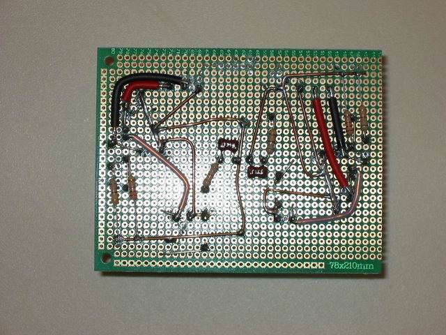

Could you take a picture of the solderside too?
This IC is a high current device and care must be taken how you design the current paths. I suspect that you have a ground/decoupling problem or problems with the output filter (oscillations). Have you carefully read the datasheet and the AN-1192 ?
Don't forget to check these too.
http://www.national.com/appinfo/audio/files/Overture_Design_Guide13.xls
http://www.national.com/appinfo/audio/files/Using_Overture_Design_Guide.pdf

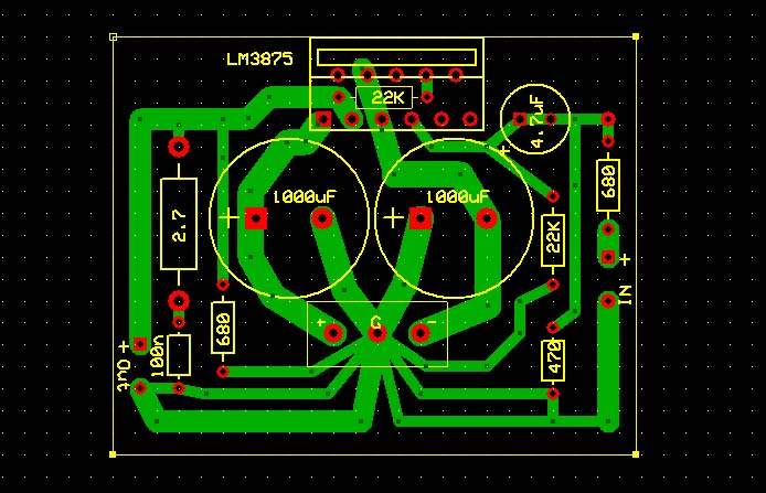

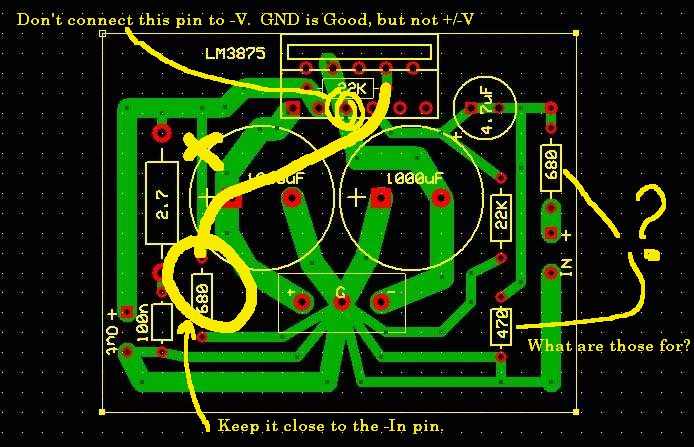

Looking at the downside, where do you connect the power ground from the single(?) transformer? have you tried to test one channel at the time? As we have pointed out earlier you must or at least ought to, add 10-100 nF close to the power pins. One from V+ to ground and one from V- to ground, close to the IC. Try to implement the "star ground concept"
I hooked up one channel after another . Both channels have background noise. I will get some .1uF box cap for power rails and hope it will solve the problem . I am not sure if I understand 'ground star concept '. I am going to make a PCB that connect all ground to one point . Is this correct ?
Yes, that is exactly what a star ground is.
Remove the bridge to the left of the 100n capacitor (near "Out"), and remove the bridge under the 470R resistor. These both have the possibility of creating a ground loop; the grounds should connect only at the star, not at any other point.
The wiring is wrong. What are the input resistors for?
Hope that's not the way you wired the hissing amps.
Keep in mind that there always some noise level in an amp.
Opps ! It seemed I have done somthing pretty wrong . :dead: Okay. Let's try again :D
Greg, I copied your schematic , but omitted 50K pot as I do not need it for power amp . There are resistor of 680Ohm and 470P ceramic capacitor at input . Should I omit them as well ? Can you suggest a schematic for power amp without volume pot .
Macboy, thanks for pointing out the ground route . It is very useful .
Thanks everybody for your support . You are so friendly .

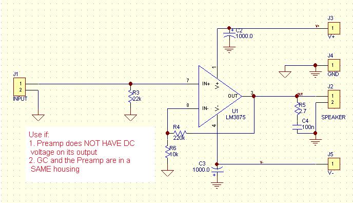

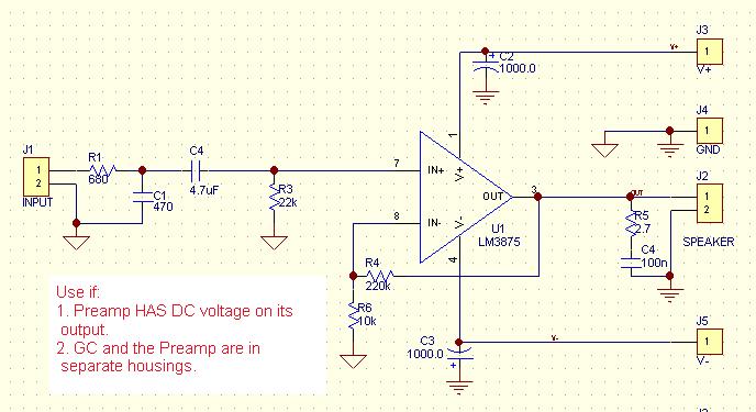

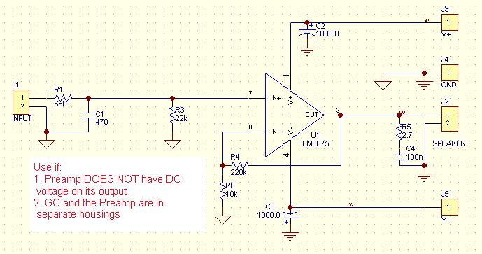

Depends a lot on what kind of preamp you have.
1. The gain of the GC you need?
The best to be between 20 and 30. In the setup below I used 22 (10k/220k NFB resistors R6/R4). You can use diferent res values here: 1k/22k 2k/47k; 4.7k/100k, 6.8k/150k. Pic the lowest res values with reasonable DC offset at the output. I think 10k/220k should be the optimum, but if you want to go with lower noise level, try the other ones too (4.7k/100k), though I don't think you'll get any less noise.
2. Does your preamp have a DC present at the output?
Measure with the DC voltmeter. If you build it and you know you have a cap at the output of the preamp, then don't use the input cap (4.7uF in my case).
3. HF noise.
If your GC has a separate case from the preamp I would add the input RC (in my sch. it's 15k/47pF in your case should be 680/470pF) just in case the the interconnects pickup some RF. The RC network should be as close as possible to the RCA, so that it kills the RF before it enters the housing of the GC.
If the housing of the preamp and the GC are the same one, then ommit the 680/470pF.
I'm posting 3 dif sch. for each case.
