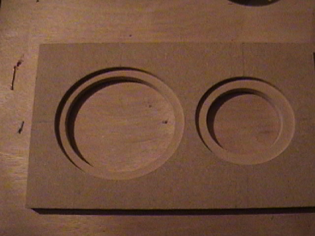

So. I decided to use the plans for "Sparky" and off I went to order the parts. Unfortunatly, I wasn't able to get ahold of a sheilded tweet, and PE wasn't expecting anything until sometime in March. I wasn't willin to wait that long, so I selected a driver that was as close as possible to the one specd' in Lou's design -- I chose the Peerless 811966. I can't say as the swap has made a difference, but not knowing how the originals sound I can't be sure.

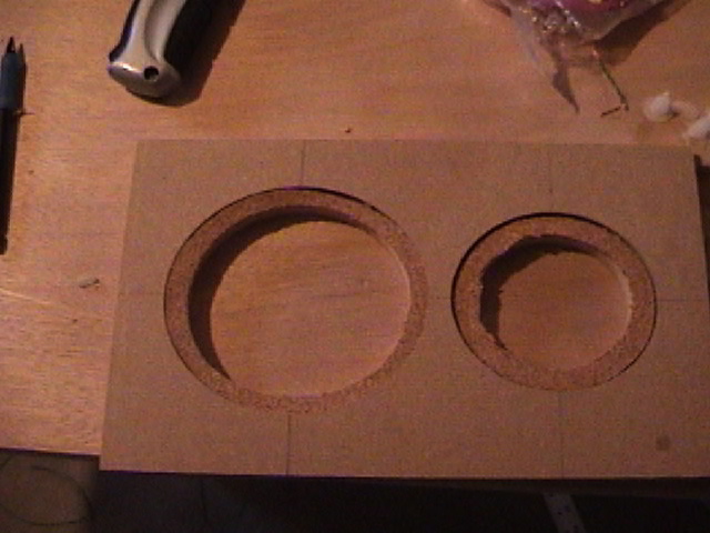

To keep things nice and sealed between the speakers and the baffle, I decided to use some cork sheets, cut to size.
Works kind of like a Gasket. The cutout for the tweets haven't been cleaned up yet.
I used a hot glue gun I got at wal-mart for 97 cents to attach the cork. I noticed that hot glue does't stick to MDF very well, which is fine since I'm only using it here to keep the cork rings in place until the drivers get mounted.

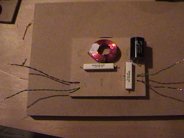

Woofer XO. I used some melamine that I found on the floor of Home Depot to mount the XOs to. The melamine was orig. used to seperate bundles of plywood or wainscotting. Since the strips were beat up pretty badly, I wasn't charged for them. I only needed a few small sections anyway.
I actually used the same stuff to build a tremmell for the router to make the circle cut outs. One thing I think that the newbs ought to know is that if you plan on cutting your baffles with a router, you really ought to go out and purchase a Jasper Circle jig or similar circle cutting guide. It would have saved me so much work had I done this. Cutting circles with a home made jig is easy, it's making the jig that sucks.

Those woofer XOs are almost too damn big. If I was thinking, I would have test fit the drivers on the enclosure before I glued the XOs down.
Of course, I wasn't thinking.
The drivers and the XO had some space issues, I ended up needing to mount the baffles on "upside down" to get everything to fit. When the speaker is complete, with the woof sitting near the floor, the XO is actually "hanging" from the top of the cabinet.
I used some small strips of 3/4" MDF to act as "Risers" that both the Woof and Tweet XOs sit on. Since I did some rather... ugly wire wrapping and soldering on the back side of the XOs, I needed a little extra clearance so the XOs would mount nicely. The MDF was perfect for this.

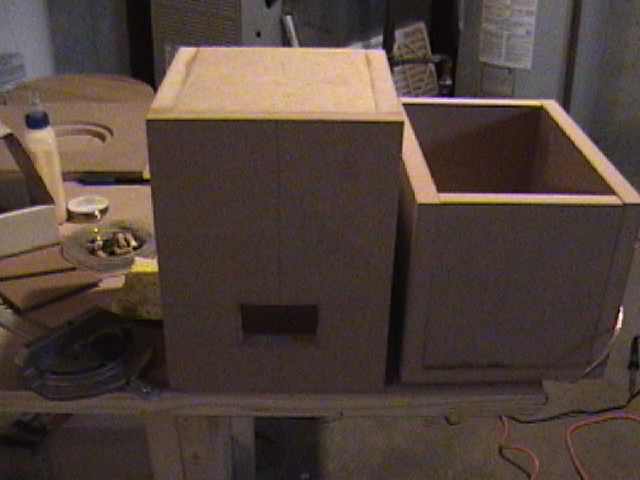

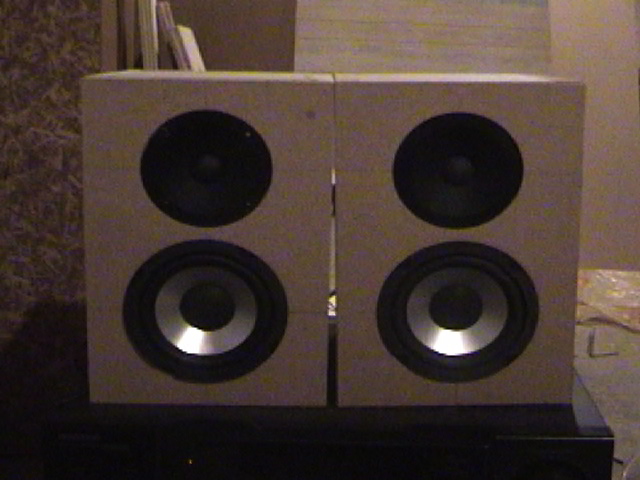

That's about it. Obviously, I need to sand/finnish the speakers. they sound great, comparable to some I've heard that cost a few hundred bucks. The cabinets aren't sealed entirely yet, as there are some small gaps that I need to close up still.
I also need to re-do the connections inside the boxes, as I used wire nuts to test fit-every thing together, and to make sure that things were sounding OK.
