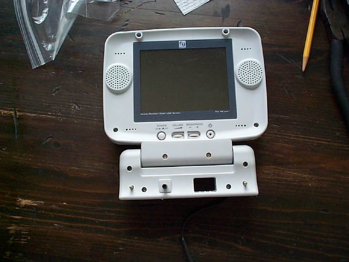

Ok time for the LCD step by step.
My screen was very simple to strip. A few screws, a snip of the cutters and I was done!
These instruction were for my PSOne screen, your screen may differ…This is for info only…so if you screw it up don’t blame me!

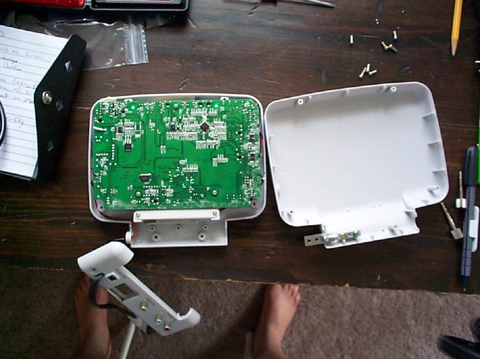

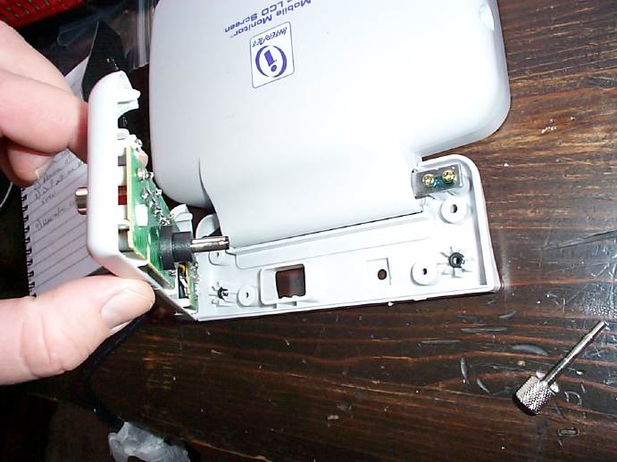

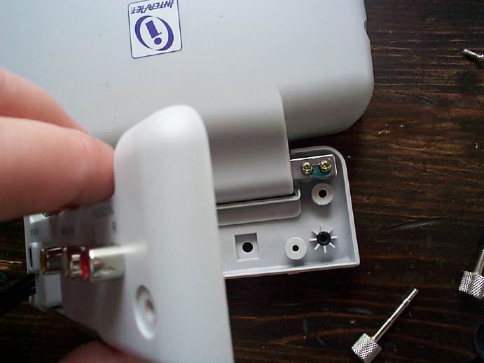

There were 6 screws holding the screen parts and 4 screws on the bottom inter-connecter.
There were 2 locking screws that attach to a PSOne.
First remove the locking screws
Then remove all the screws holding the housing together
I ended up stripping a screw head, so I had to drill it out…Oh what fun.

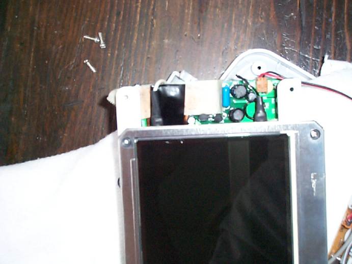

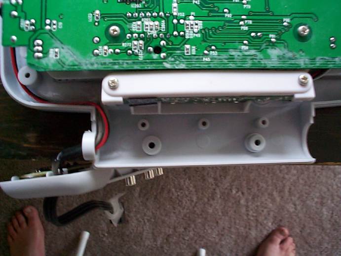

You want to start with the bottom interconnect section (the part with the power, A/V jacks and the PS cable.
From the back separate the interconnect section, there are two small hinge screws that need to be removed.

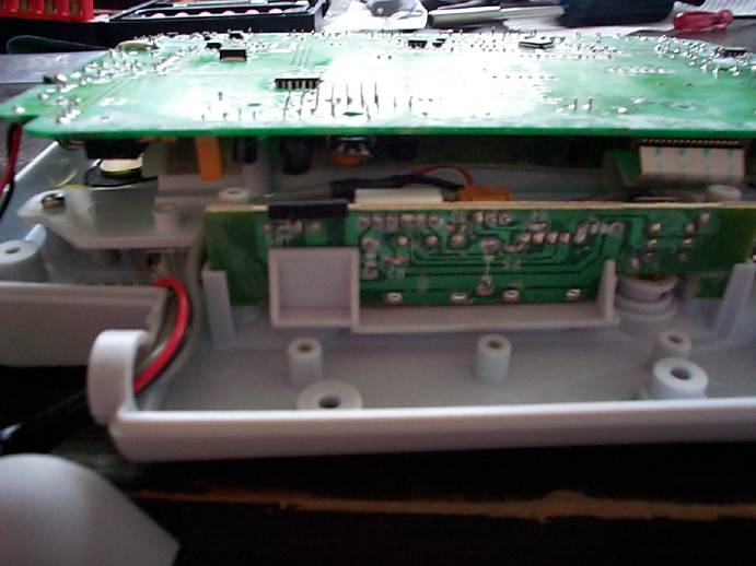

Next is the small mounting board for the front controls (Power, Volume, and contrast), there is a plastic holding bar that has two screws holding it in place, remove them and the front control board slides out of its holding bracket.

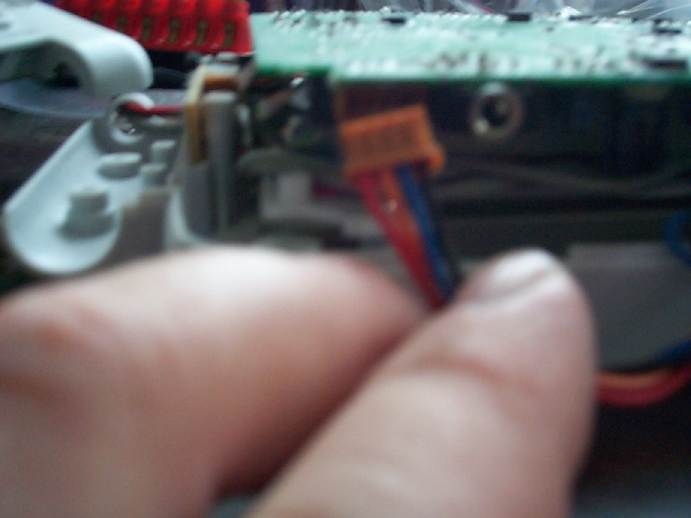

Remove the speaker interconnect jack (don’t need it) Just follow it from the speakers to the main PC board, it will terminate to a small plug that you just pull out.
I know the picture is bad 🙁 but oh well!

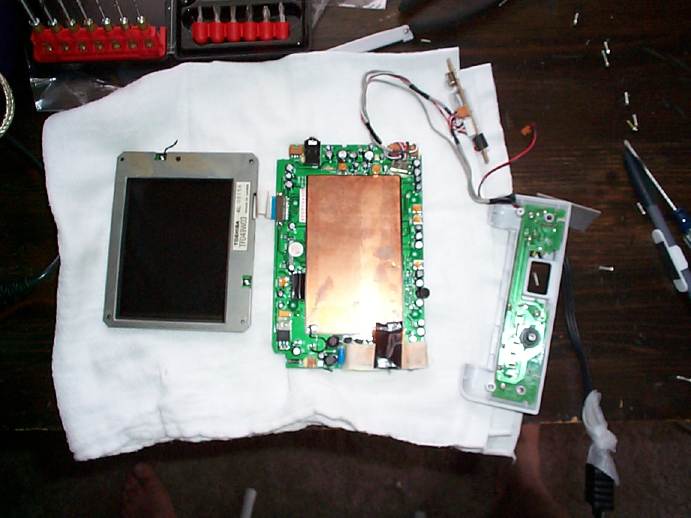

Now we move on to stripping the LCD itself. Don’t worry it comes apart very easy!

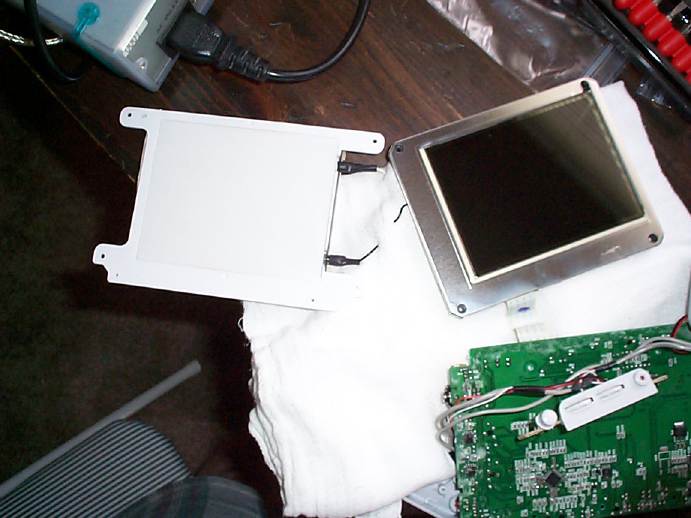

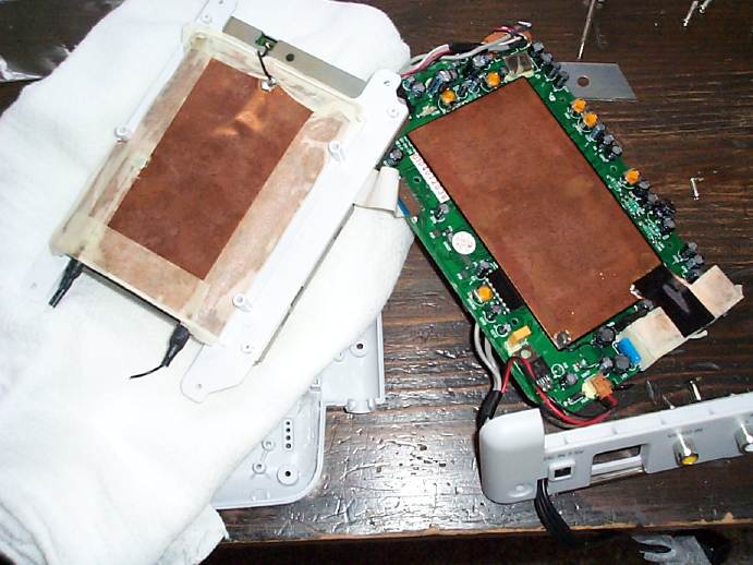

There are 4 screws that attach the Main PC Board to the LCD remove those, now you can remove the LCD…it will still have the backlight attached to it.
There are two wires going from the PC control board (the one that was attached to the back of the LCD) to the backlight, these need to get cut. They are the ones with the rubber boots on them.
Then you will see some small screws holding the back light to the back of the LCD, remove them, there will also be a ground wire going from the LCD frame to the copper EMI shielding, you need to cut this also, now gently pull off the backlight, you might have to use a little force because of the double sided tape
