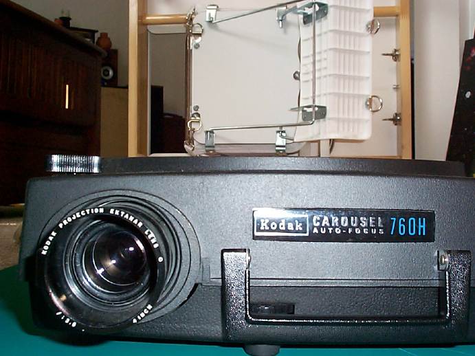

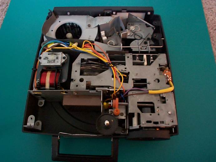

Ok…Here we go! I got the DIY bug some time ago while searching the web…I fought it for some time (no cash, no time, and the WAF). But I got a PS One screen for free…so the bug grew and took me over…I stopped by the local Salvation Army store to look for a projector of some sort. I was in luck... just what I was looking for…a nice looking Kodak 760H (with auto-focus) for $20. I plugged it in and it powered right up, bulb worked and the lens looked good, no scratches or cracks!!! So I got them home…now time for destruction…HAHAHA…
next

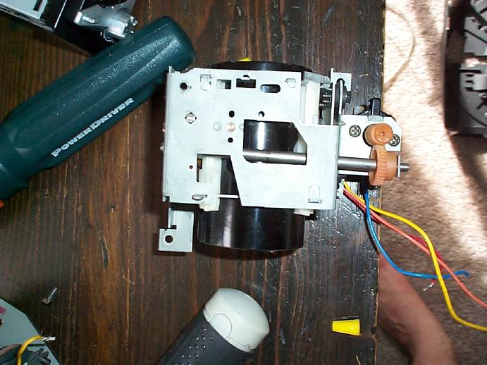

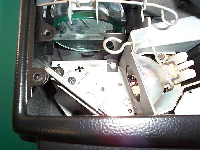

The first thing I did was to remove the light, heat absorbing glass and the condensing lens. Then I unscrewed the 4 screws (all screws are 1/4 inch hex screws) holding the bottom on (you have to remove the little rubber foot on the height adjusting foot to get the bottom off). Then I stood looking at it and wondering what I had gotten myself into.

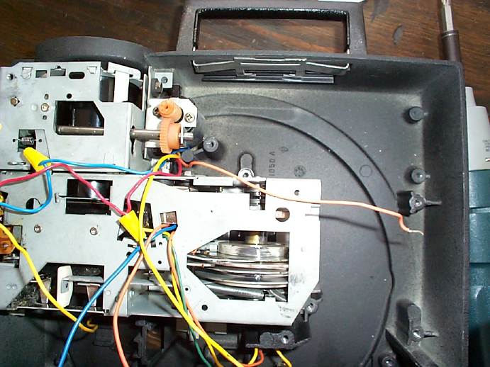

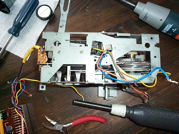

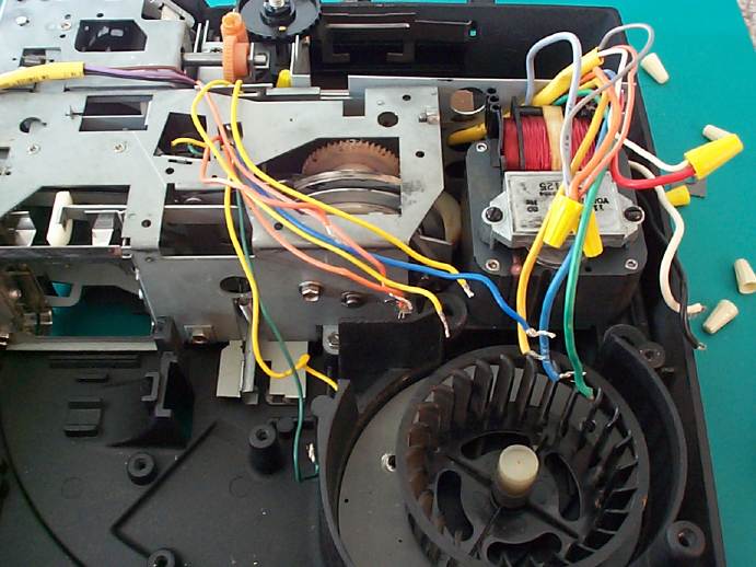

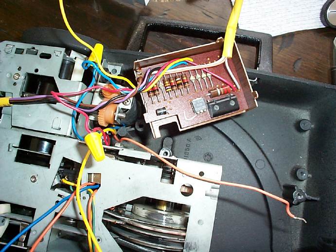

I started by removing the light housing and the holding brackets for the glass and lens. Then I moved onto removing the screws for the fan housing. I also was diagramming the wiring so I know what went where. I continued to disconnect the wires going to the light and fan and removed the fan motor, fan cover, fan wheel, and belts (yes it is a belt drive fan system).
Now once I had that out of the way it was time to remove the main lens system…easier said then done. First there are two arms from the lens harness to the slide mechanism that had rivets that needed to be popped out, then a second control arm to be removed. I had to “think outside the box” because some of the screws were in very tight spaces where my 1/4” hex drive wouldn’t fit…I resorted to using a multi-bit security driver without any drives in it; it had a thin shaft that could fit in the small spaces. After some finagling the lens harness came out. Finished!!!
