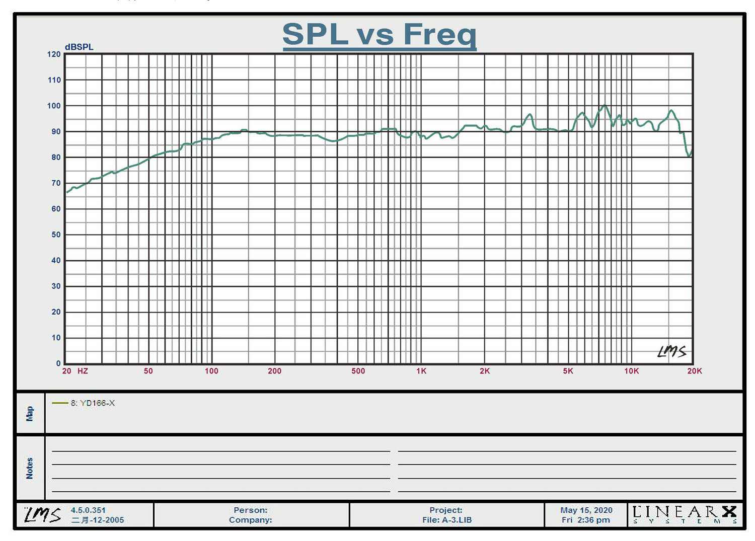

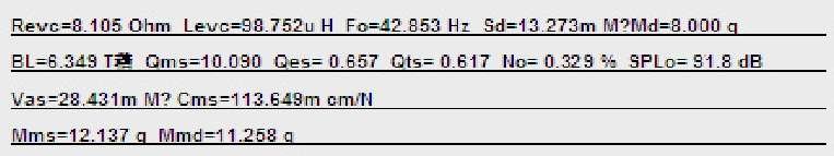

Additionally hereby is a snapshot of all the TS params that I got when I bought these.
If someone here is courageous enough to calculate an estimated spl according to these TS, I'd be curious to see what you get.
Calculating in WinISD and somewhere else on the internet, I get around 87db, which is quite far from the almost 92 announced in the specs.
