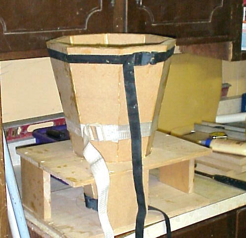

Here they are glued without the front baffle.

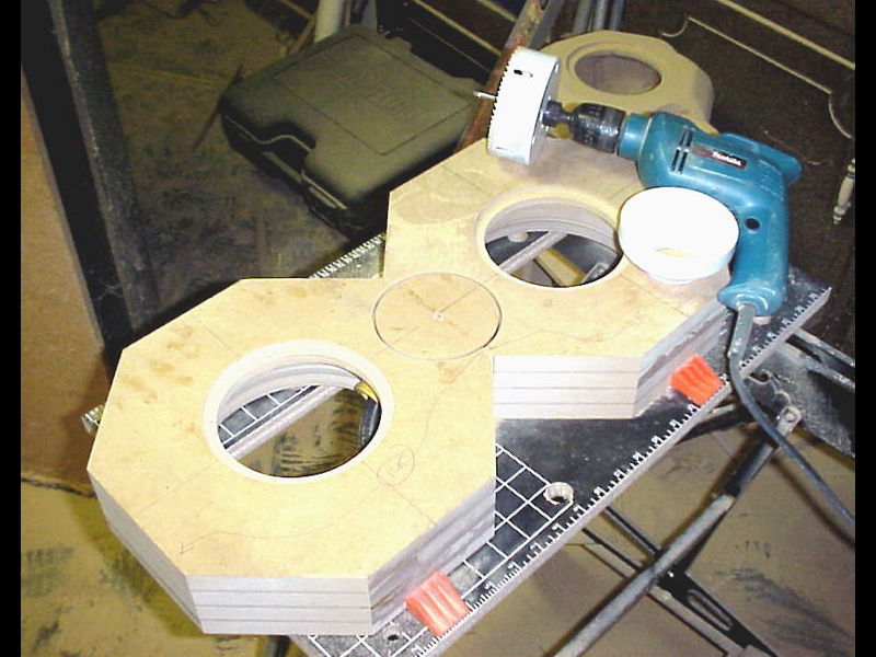

The front baffles had to be done in matched pairs and accounted for nearly 100 hrs of work as the back-side was bowled out to give the midrange breathing room. Then a layer of fiberglass was applied to strengthen around the Tweeter recesses, most of the baffle and enclosure was a min of 2 in thick. The inside of the octagons were layered with a Tar slurry and another layer of 3/4 MDF then another layer of Tar. I have probably 50 pics of the construction process but just dont have the time and web space to post them
