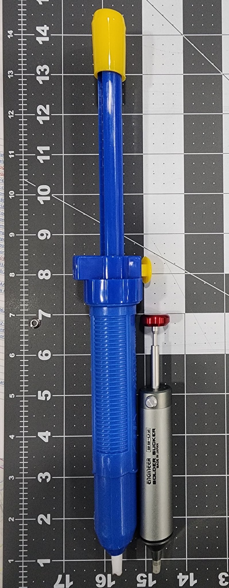

You do not need to spend $$$ €€€ £££ on a fancy desoldering gun. A good solder sucker, learn some new skills (YouTube works), and patience is all you need. What will lead to success is good technique and patience. I have used solder sucker a lot and it works great. Usually takes 2-3 "sucks" and I'm on to the next. Usually takes about a minute or to to free the joint. The copper wick has not been super helpful for me, but others have had success with it using lots of flux. Whatever you do, please trim the component leads down before starting to desolder.

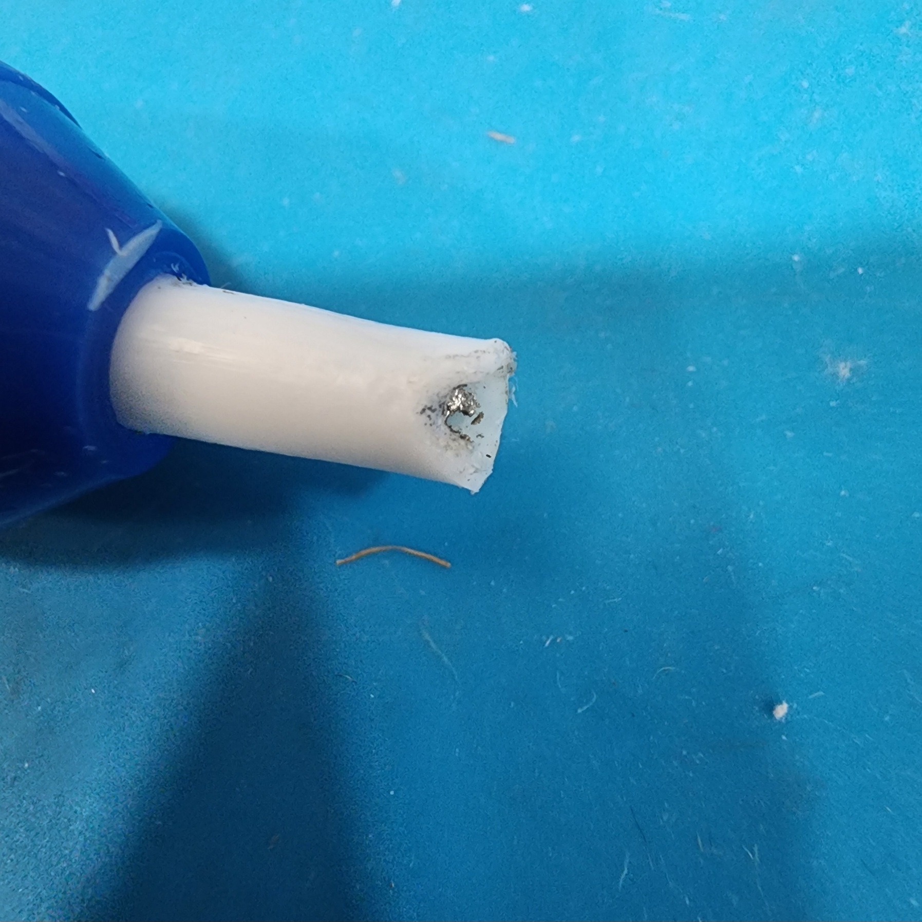

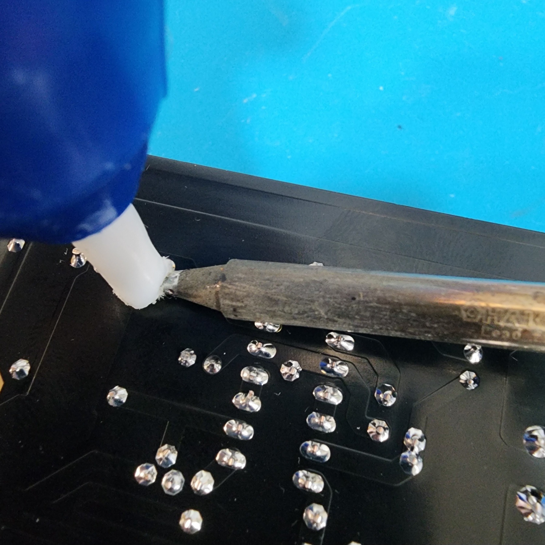

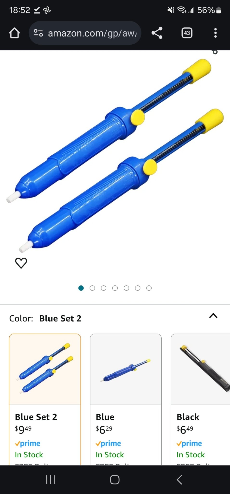

I have that Japanese Engineered sucker recommended above, which is built well, but small volume. I purchased a much larger volume sucker and found that helps tremendously. Theres 3-4x more "suck" with the added volume. As a bonus, it was also far less expensive (2 pack was $10). I modified one with a little slot for the soldering iron tip so the sucker seals up over the pad being desoldered while the iron is still in contact.
