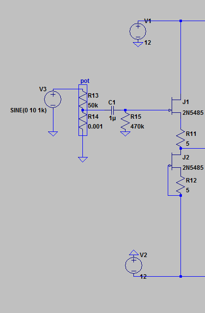

Let's fix one thing at a time, please. Sims are not needed, it's a very simple circuit.
Just wire your buffer as shown in the attached schematic, nothing more connected and report.
r15 can be 330k to 1meg and c1 value isn't critical for now. Don't mind the 2n5485, that's all I had as model installed on this computer.

the input in post38 is correct.
R15 sets the input impedance.
C1 is the DC blocker.
Compare to post30.
R14 sets the input impedance. do you really want 1k8 as your input impedance?
C2 is in the wrong position.
What is R2 =10k supposed to do?
This input is completely wrong.
Move C2 to next to R2
Change R2 to 2k or 100r or anywhere in that range.
C6 is the RF filter. For simulation of the circuit set it to 1fF
For filtering simulation set it to around 200kHz, i.e. RC = ~0.5us (500ns), 10k+6k5 & 100pF = 1650ns
For two perfectly matched J1&J2 the Rtrim must be set to 5r1 to exactly match R1 (5r1)
In the real circuit you can adjust until the output offset measured at J2 drain is 0.0mVdc. BUT this ONLY works when the DC block is present at the input and the DC servo is disconnected.
