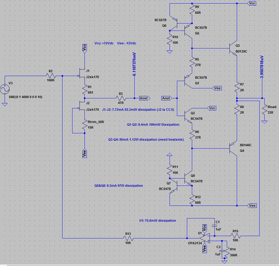

"My" first design headamp, DC-servo question
"My" because I got the idea from my BCL clone and I've had great help from Abraxalito, thanks mate 🙂
It's built and powered on with a temporary 7x12 dual rail supply.
I'll use LT1083's when I put it in it's case.
I was stomped by the DC offset I got, nothing close to LTSpice simulation indicated.
I replaced the opamp with another(same kind, OPA2134), and DC offset went from 1.4Vdc(declining slowly) to 0.05mV.
My question is if it's ok for the OPA2134 to get around 1.4Vdc on the inputs?
Without the DC-servo, I should've gotten around 65mV according to LTSpice simulation.
I used BD139/140-16, those have higher hfe from what I understand compared to the other versions.
Could that cause the offset? I did not match BJT's (BC547B, BC557B, bd139-16, bd140-16).
The 2SK170's in front of them are matched however.
Anyway, is the offset within margins for the OPA2134 or should I use another opamp?

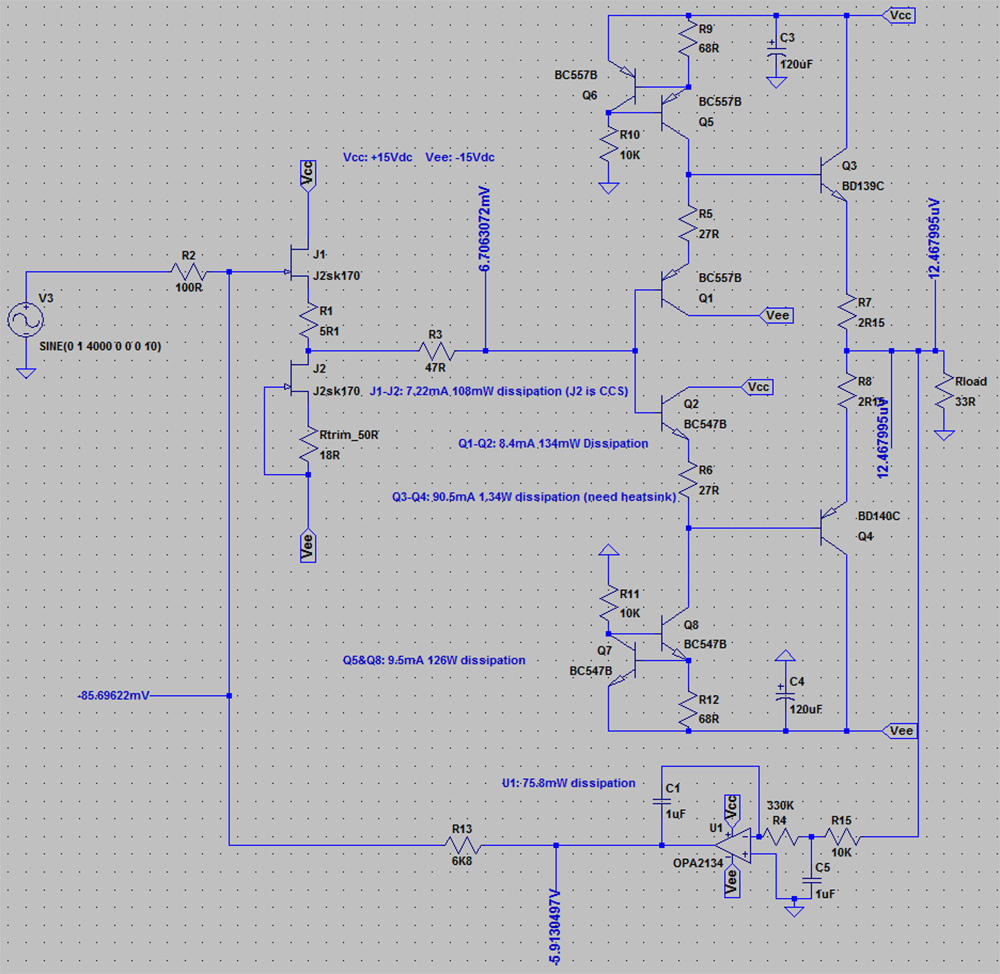

DC-servo circuit
For a few, happy, minutes I had -0.05mV to 0.05mV offset.

Hmm, either I've made some mistake or the design is not as good as LTSpice would suggest...
I get close to 2Vdc at power up with 33R load resistors to gnd but nothing on the inputs. For a brief moment of happiness yesterday I thought I had gotten it right...turns out the probe leads wasn't all the way inserted in the DMM 🙄
I've tried two versions of DC-Servo circuits and without DC-Servo, without and with DC-servo and a 6.8uF MKP on each output (seems to "saturate" after a while).
Next on the list of things to try is inserting filmcaps between jfet stage and diamondbuffer. Then maybe between BC547/557 and BD139/140.
Versions I've tested soo far.
The one saying Vcc: +15Vdc and Vee: -15Vdc I tested with the same +/-12Vdc supply as the other. I also forgot to edit the dissipation for U1, that with 15V rails would be 117mW.

I'm the first one to admit that I am a complete novice at designing circuits.
According to LTSpice, I should get about 65mV offset without the DC-servo connected.
In reality the offset is close to 2Vdc at start up, then slowly declining in to the mV range. This takes alot more time then a second though.
None of the BJT's are matched, the jfet's are closely matched though.

The easiest would be to trim your initial offset by using a 100R trimmer in either R9 or R12 position.
In your ltspice sims, you have a trimmer in the jfet buffer to compensate offset in the diamond buffer. Are they on your board, we can't see that part.
imho, I'd rather use the opamp to ditch the jfet input buffer and enclose the diamond buffer inside the opamp's feedback loop.

Your audio input (V3) is DC coupled to the amp input. In simulation your voltage source V3 has an effective DC resistance of zero ohms. This means that your servo can only develop a very small correction voltage at the amplifier input as you effectively have R13 and R2 in series to what is effectively 'ground'. The fix is to AC couple voltage source V3 via a suitable cap. R13 defines the input impedance of your circuit (so its low) and that means you need a relatively large cap to maintain LF response. You could make R13 much larger, say 1 meg. There is no noise penalty doing this.
In a real circuit, its a matter of chance what the DC output resistance of the source component is. It could be AC coupled, or it could be DC coupled direct to an opamp output.
So to remove this variability from your circuit you need to AC couple the input.
Well, if you have a trimmer on the jfet board, let's start with that.
With the DC servo disconnected, what happens (meaning what is the output voltage) when you set the trimmer for 0V at the output of the jfet buffer ?
Did not get anywhere near 0Vdc on the jfet board outputs.
Got to 1.3Vdc & 1.5Vdc.
