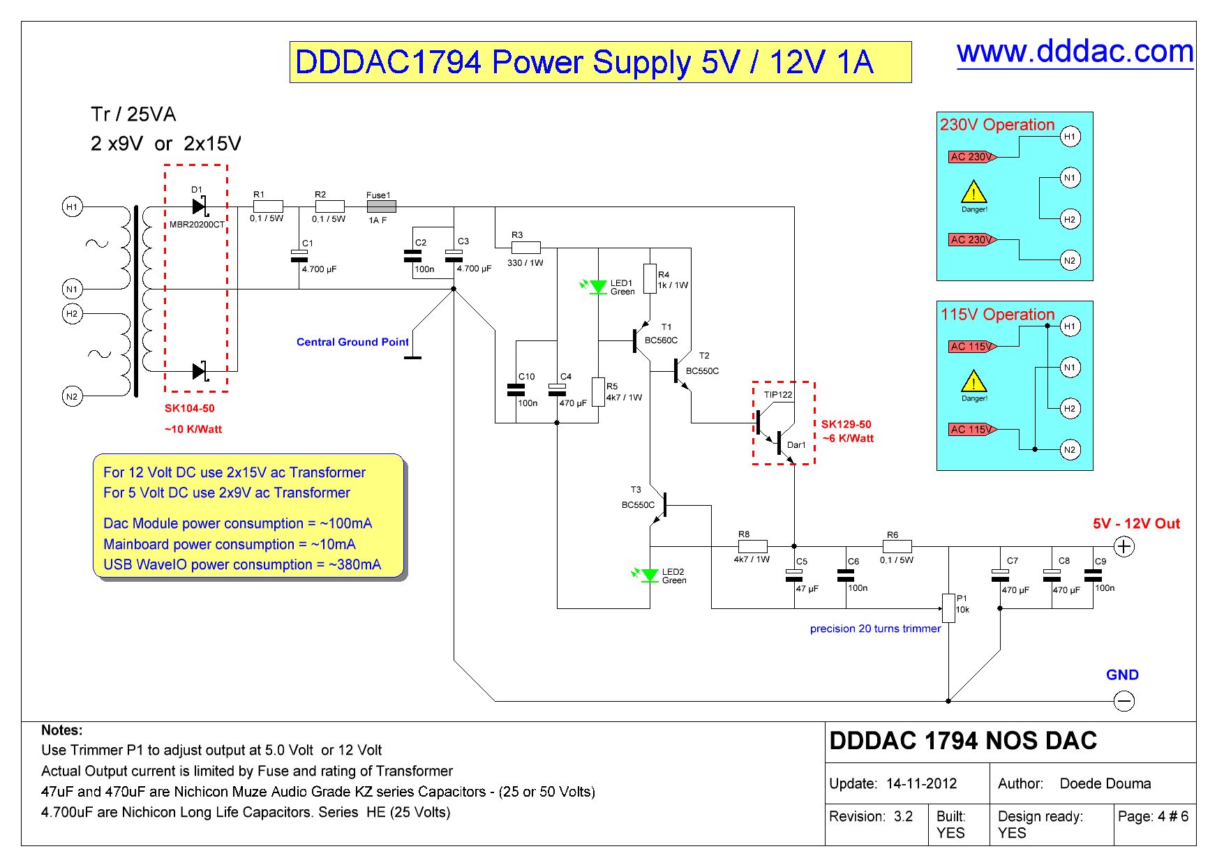

Replacement Transistors
Hello
greetings can BC546/BC556 work in place of BC550/BC560
warm regards
Andrew
