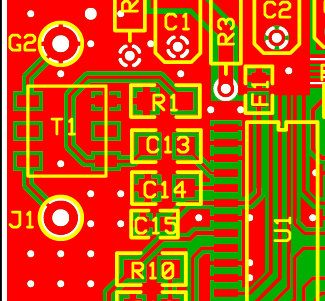

I've been reading more about input transformers for the spdif signal. I'm beginning to think it's a good idea, if it will fit on the board. It seems like a small smt 1:1 trafo would be appropriate here.
I've added a input transformer for the SPDIF. It's a Schott 1:1 smd (digikey 257-1149-1-ND). I've attached a pic. T1 is the transformer. I have two important questions. First, is this the correct way to connect everything? Second, will this improve the DAC? If so, I will keep the change.
I've used the 470-1000-ND from digikey with the CS8416 mux to good effect.
The part you've picked is marked as "Limited quantity available, not recommended for new design."
Either way I think you've wired it wrong.
Keep loops small, ie move G2 near to J1, flip R1 around and connect it directly to C13 etc..
Source termination rarely hurts, if in doubt use something like 15ohms.

Be careful with planes under the input transformers!

Do you think I should cut out the ground plane beneath the trafo?

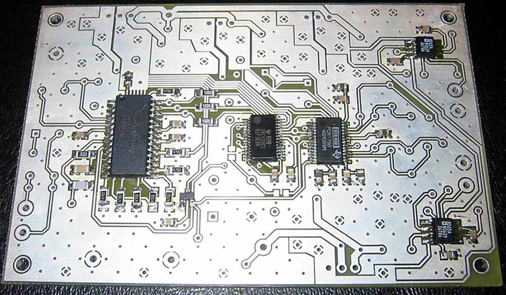

Finally got around to building my DAC. On the plus side, I think I did o.k. for my first surface mount job (so far). Unfortunately, I didn't get to finish because I'm missing a couple of 0805 resistors and had to place another digikey order. I'll finish up everything else when I get those. Anyway, I've attached a pic of the partial build.
