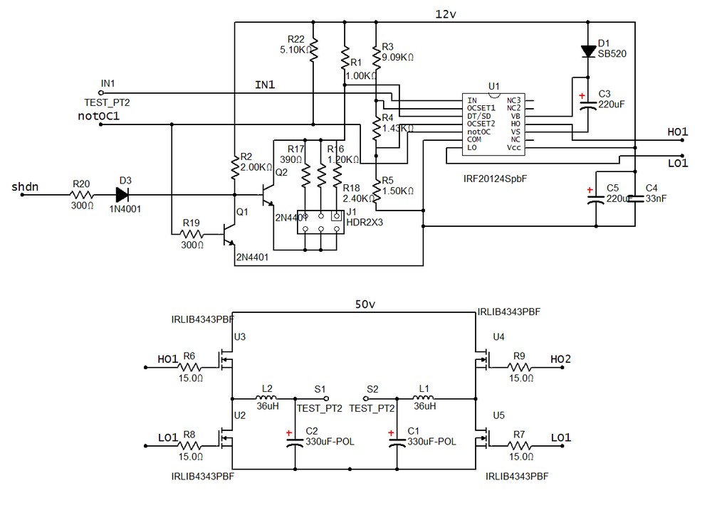

I have designed my first class D output stage now and wounder if anyone could give me some positive/negative feedback.
The schematic consists of the output stage with FETs and LC output filter. The switch frequency will be around 50kHz or a bit higher and the amp will be for subwoofer use.
The gate driver is from IRF and is the one i thinks suits this full bridge project well. It has a built in dead time generator and OC function. The OC signal will in my design automatically shut down the driver, is this a good way to do it?
The design is made so the dead time can be adjusted via J1.
The shdn input may be a bit crazy haven't thought that through yet, what do you think?
Would Coilcraft DMT3-35-12L coil be good in the output filter?
Hoping for some tips and tricks =)

I just noticed two errors in the schematic i uploaded.
R19 is not really needed and J1 should of course be connected to GND.

Hi smitten,
another error in your schematics...
your must use 2 fets drivers to drive your output bridge
feeded by pwm signal with phase shift of 180° or same pwm signal for both drivers but outputs inverted compared to the other driver...

Thanks for the response alexclaire. I do use two drivers but in the schematic I posted I only had one of them.
I know my first schematic probably was so bad that no one understood it. I have a new version now that will be used to make the first prototype.
If anyone has any comments on the new schematic I would appreciate it.
I have some trouble finding good parts for the output filter. I have found a nice torroid from Coilcraft but I have not found a suitable cap yet.
The f-3dB frequency must be rather low since I use 50kHz fswitch. I could also try to find a bigger coil than the 35uH from Coilcraft and then get away with smaller cap.
Any ideas?
Hoping for more response this time 😀

T106-2 core are very good for class d amplifier output filter...
polarized caps are not good for output filter !!!
cap range is 100nF---->4,7uF depending on f-3db
f-3dB should be 5kHz or less for your application.
