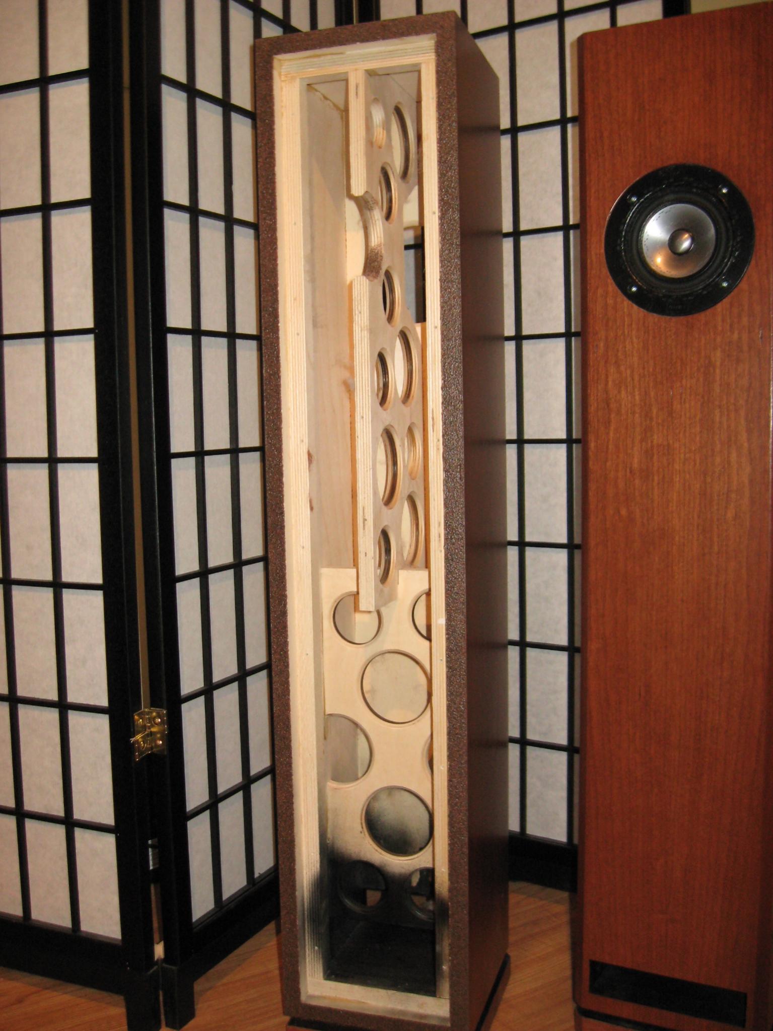

I'm going to try my first DIY, a pair of loudspeakers, I've orderer the MarkAudio CHP-70 drivers and will build the Pensil P70 project with a tight budget.
Here are some of my doubt about some options, please point out my mistakes
Decided to do the bracing and increased the width by about 10% to compensate the lost volume is it ok to increase only the width or should the increase be divided by all dimensions?
I'm thinking about coating the vertical brace in the part it will compress against the back of the driver with a strip of 3 mm cork does it make any sense? or is the objective to transmit the vibrations to the bracing ? (also cork the parts where the removable back will contact other wood???).
In the vent should I round the inner upper edge as in the Pensil 12 project?
About the wood I've purchased particleboard covered in one side with paper cardboard (two IKEA Galant corner desk top...) it as good WAF, it's heavy (about 20kg per speaker) but is it an acceptable alternative?
For the damping material should I use only dacron or can I be "imaginative", what characteristics should the material have?

Jorge,
Your English is fine.
It is not all that necessary to compensate for the volume of the holey brace. If you do, increase the width by 2/3s the thickness of the brace. Increasing width will also affect the terminus at the bottom. You need to maintain the same cross-section area.
The main finction of the brace is to transmit/disrtibute driver energy to the back (top & bottom) of the box. A tight fit, but not so tight as to stress the basket, is best here. If you don't get it tight best to shim with something not very squishy. Paper, shim of wood.
It doesn't hurt.
Better than MDF. Pensil is fairly uncritical.
You can be creative with certain limits.

With our Pensils for Alp7, we didn't line the walls, but filled the box with fibrous material. This is were interlocking or crossing braces in at least the lower section of tall / skinny enclosures helps - keeps the fill from slipping out of place.
We filled our Pensil 7 build evenly (as suggested by Scott in a recent post) at the specified density and then removed about a 1/3. Room for experimentation is necessary as polyfluff, even if 2 versions look the same, can be quite variable in how well it performs.

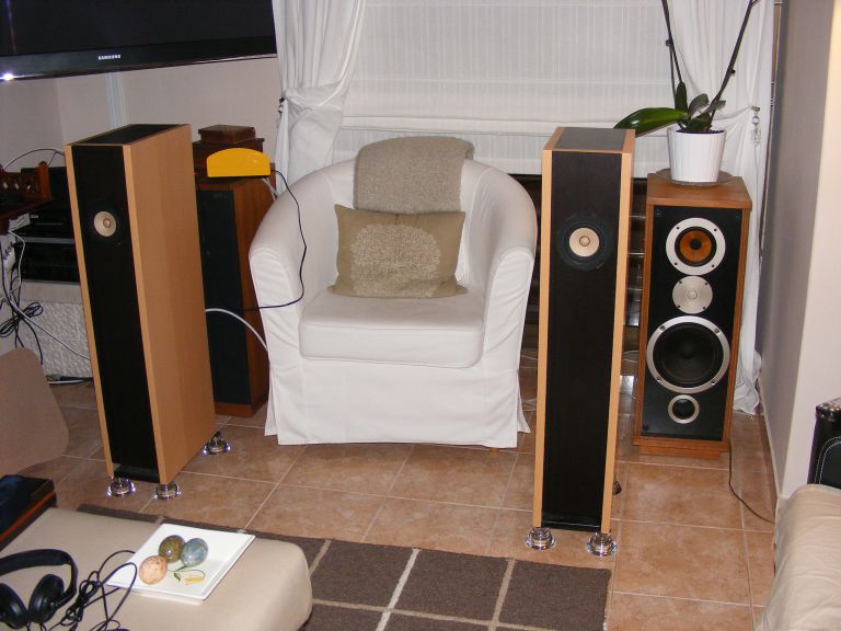

First listening impressions
Hello,
Finished the build and started listening to music.
Maybe, first, I should explain my idea for building this system.
1 - Get rid of the 50hz/60hz (in the wich list for 30+years) - powered by a 12V 7Ah battery.
2 - Source should be losseless audio files and mp3.
3 - Should use the minimal amount of components (keep it as simple as possible).
I'm using a TA2024 MK2 amp from Helder Hifi (very positive impression ordered the TA2020 MK3) and a Sansa Clip+ player (FLAC files) and using as comparison my old Siare Fugue400 the first impressions are:
Positive - detail, sound stage, precision (better than the Siare will have to compare with my reference in these aspects the Cabasse Sampan Lourd that I have in the other house)
Could be better - A litle more bass and not very robust sound with large orchestral works (still looking for the best positioning), improved with a different stuffing and with the feet.
Overall I'm quite impressed how a under 200€ system can sound like, clearly exceeded my expectations.
Any opinions on how to improve my speakers/system are very welcome (should experiment more with the stuffing? should I consider building a second pair of speakers (other wood other drivers...)?).
Thank you MarkAudio for this positive experience.
