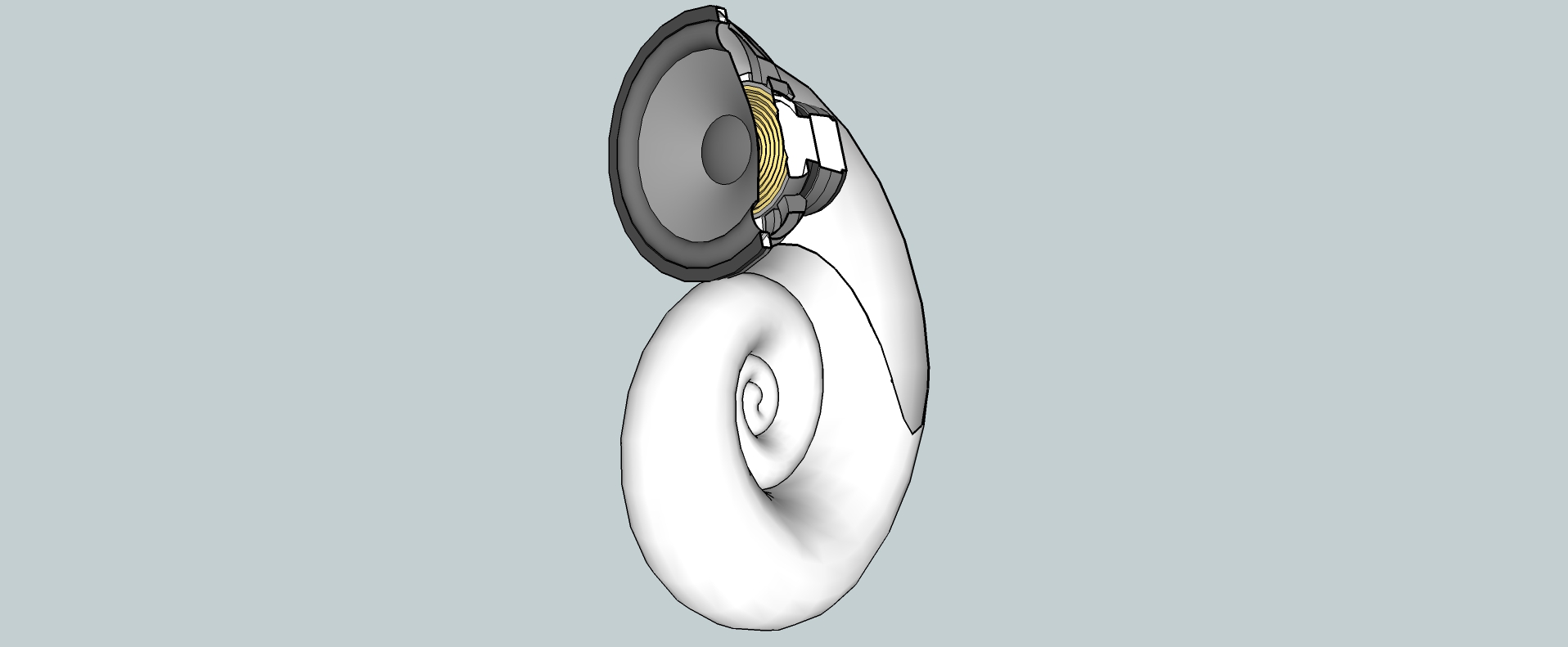

I am planning to build a Transmission Line spiralled Loud Speaker. Yes, this will resemble the Nautilus, but that wasn't intentional from the offset.
The build will be made from Baltic Birch Ply segments glued together. Has anyone else tried this kind of builder before.
Attached is picture of what it should like when finished.
Also, has anyone ever put ceiling speakers in a floor standing cabinet?

Sparrowlegs,
Is the TL quarter-wave (open terminus) or half-wave (closed)?
From your sletches i see 2 immediate issues. 1/ you are not taking advantage of driver offset to reduce the 1st undersired harmonic (less of an issue with 1/2 wave), and 2/ it is likely that your line is starting out far too small. Are you modeling this with something like MJK?

There is one school of TLS design were the idea is to lose all back radiation from the driver in the line. What you have is then similar to a closed box with resistive losses.This is very different from the TLS that use the quarter wave resonance to agument bass output similar to the port of a bass reflex speaker. So do clarify the type of TLS that you want to build.

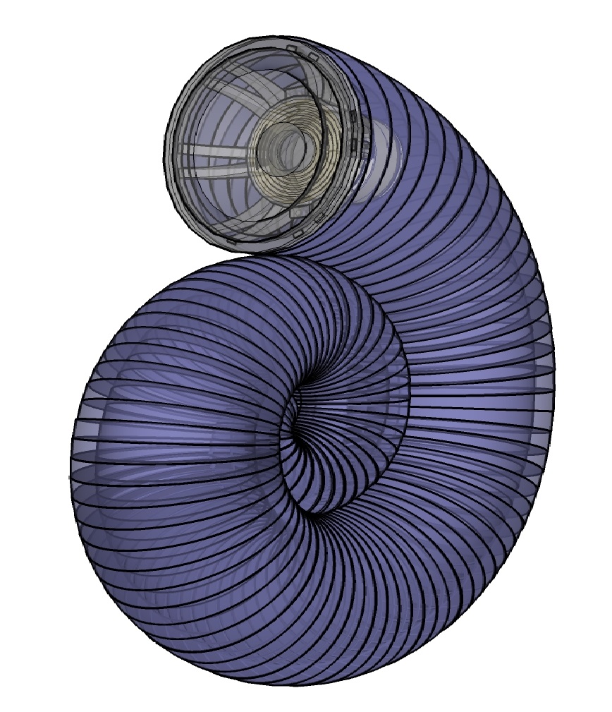

With regard to the driver, my design actually isn't strictly correct. Once the spiral hits 12 o'clock, the line will continue to the vertical till the driver runs flush with the belly.

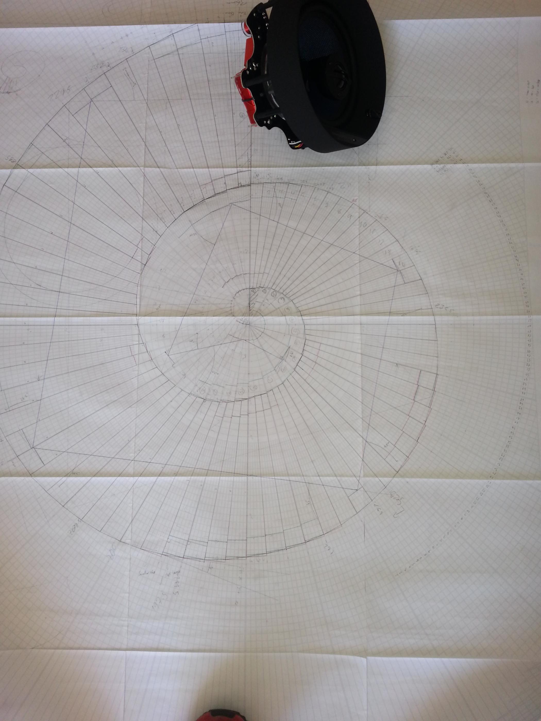

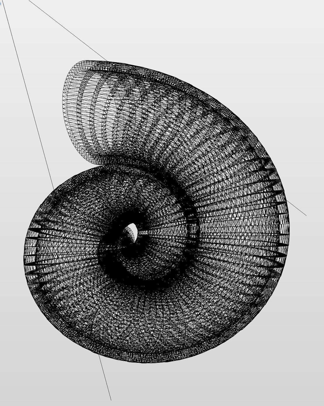

With regards to the complexity of the build, this isn't hard when using a computer to model. I have done all the drawings and plotted it onto a CAD. It's now ready to be CNC Milled. I have to 3D mill, as it's the only way I can get a gradient on ply without ripping the veneers, (IE you can't plane ply.)
I will admit it will be time consuming piecing it all together, but the technical work wasn't the problem.
This is intended to be a closed unit, though I was planning to test as I go along, IE if there's any difference having a plug in the centre section.
Then it is half-wave. What is the internal volume? What driver are you using?

The Volume is 43914831.29 mm3 (43.91Litres). Dave, your really are pointing out that I have no idea!
How do I go about designing the line based on the driver?
