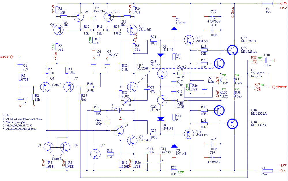

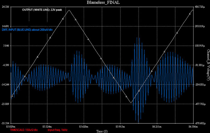

I'm currently in "learning phase" of amp design so I paused work on this amp until it is polished. This is what I have for now (schematic below), it performs nicely in simulations, THD values are very low (also 60Hz : 7kHz, 4:1 below 80dB) except one tiny little thing (?). When the input signal is triangle, I can see some kind of oscillations between + and - input on oscilloscope, so I'm very confused what to do with it and how to fix this issue.

Not necessarily related to your oscillation problem, but at 51 ohms, R20 is much too high in value. Q7 is already on the verge of being turned on just sitting on the VAS idle current. 18 ohms would be better.
Glen
Hey Glen 🙂
According to the datasheet Q7 will start conducting at 0.6V (t=25C), at t=100C Q7 will start above ~0.4V. Should I lower the R20 to maybe 25ohms, 18ohms is to drastic change?
Also I dropped the two pole compensation and used 24pF Cdom to see if anything changes...so here is the picture. I think it's better than previous post, it it?

Hmmmmmmm............ I'm guessing that you're looking at a Vbe Vs Ic graph that shows the base emitter voltage at a minimum Ic of 100uA.
100uA is still a significant proportion of your LTP tail current and you really want to avoid collector conduction at currents much lower than this during normal operating conditions (which correspond to an even lower Vbe).
The ambient temperature inside an amplifiers case may rise significantly higher than 25 deg C and you also have to account for variations in the VAS standing current due to temperature drift and component tolerances. Then there is the increased VAS transistor conduction due to the current demands of the driver stage, particularly at 20kHz at full amplitude.
Fortunately though, the operation of the protection transistor can easily be made totally benign simply because there really isn’t any need to limit the peak VAS current very close to the quiescent value. Three or four times the quiescent current generally isn’t a problem, particularly so as the protection transistor operates with a low duty factor. Then you can be sure the protection transistor isn’t going to be conducting when you don’t want it to.
Also, 24pF is waaayyyyyyyyyyy too low for Cdom! Now I've got to run.....

I agree with Glen, R20 is too big on your schematic.
36/39Ohm would be OK, although the best choice would be 24Ohm.
About Cdom I agree too, I would keep the 100pF+510pF values.

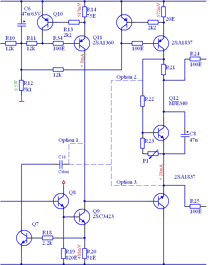

I think 24 ohms for R20 is fine. It should start conducting somewhere above 16mA (at temp 100C) which is double than normal.
C17/C18 are part of lowpass filter formed with resistors R39-R42, I saw this being used in PA300 amplifier published by Elektor. Nothing fancy here. Protection isn't active during normal use and it doesn't cause oscillation, overshoot etc.

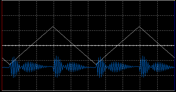

When I use two pole compensation, oscillations are quite different. Maybe it is normal when triangle input wave is applied, is it?
I attached another image.

I would set a transient peak current of 14Apk for an 8ohm speaker. Ipk~=Vout/Z/0.35~=40/8/0.35~=14Apk. If 4ohm speakers are used then this becomes 25Apk (150W into 4r0).
Assume the output devices can supply 7Apk each then the driver output is about 400mApk.
At this current the driver gain may be down to around 70 or 80 requiring around 5mApk from the VAS.
That requires 8mA+-5mA just to run the amp into a severe 8ohm speaker. See what I mean about running the VAS hard. And why your protection Q7 will trigger well before peak current is achieved.
The output will source current through the VAS and the triggered protection. If the output is shorted or connected to a low impedance speaker then the EF preceding the VAS is overloaded.
The other thread decided that the best way to protect the EF was to add a collector resistor to limit the current passed from the ground into the EF.

Wow, Andrew, those currents are way larger than I expected. I loked at the datasheets once more and got 4mA max current, so you were right. As I can see, there are multiple ways to solve this problem:
- add more output devices (adding one more OP pair, current should be about 2-3mA)
- rise VAS current (are specified 2SA/2SC types any good for Ic more than 20-30mA? - I don't think so 🙁 )
- add a unity gain buffer stage (is it really necessary?)
I need more time to think about this...
About protecting the EF, isn't that Q7's job? Sorry, but I can't locate the thread you are referring to. The search engine is just to simple...

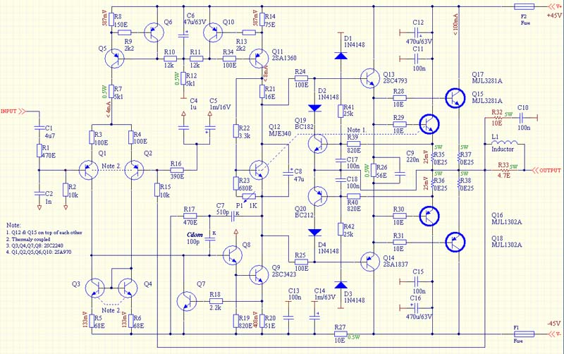

Anyway, about oscillation problems I had a few posts back... I managed to kill them (I hope so) using a feedback network which looks pretty much like feedback used in the Leach amplifier.
Last night I have finally got it how to measure open loop gain and phase and it showed a open loop gain of approx 80db! I never expected such a high open loop gain. Is it true, or multisim is going crazy again? Is the current mirror responsible for high gain?
About the buffer... I added the buffer like shown in schematic to see if anything changes, also I added another CCS set to 30mA. THD was not changed during normal conditions. Then I lowered the speaker load to 2 ohms (P=100W) and THD is improved by only 1db, so there is a little difference between buffered and unbuffered version.

Is there a more elegant way to add a buffer? Maybe is triple EF the answer?
