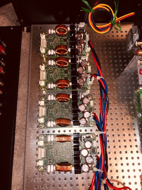

I recently decided to build some high end 3 way floor standers using the SB Acoustics Santori Textream series drivers (tweeter/midrange) and SB Acoustics 8" SB23MFCL45-4 (woofer x2). I will post that build in the multi way speaker part of the forum in the coming days. I have always designed my own passive X-overs for the speakers I have built in the past but this time I decided to go active after purchasing the Dayton Audio DSP-408 and giving it a listen and liking it. So this meant I would be needing separate amplifiers of course and rather then hobble together something from the hodgepodge of different amps I currently own, some good some not so good, I decided I would try my hand at building a class D amp using amp modules. Simple right?
So after doing a ton of research on what's available and what I could afford I decided I would go with IcePower. They have a good reputation for quality products and they aren't exorbitantly expensive like the Purify offerings. After going through their catalog I decided on the 1500S PSU and the 300A amp modules. After ordering them I was informed that the 47 volt version of the PSU needed to power the 300A modules was out of stock and It might be a while before they got any more and they suggested I use the 69 volt version and the 400A modules all of which they had in stock and could sell me for the same price. I went with their suggestion and that is what I now have 1- 69 volt1500S PSU and 4- 400A amp modules. (I will attach the data sheets below) So I have a lot more power then I will ever use when driving these speakers but the extra head room is welcome.

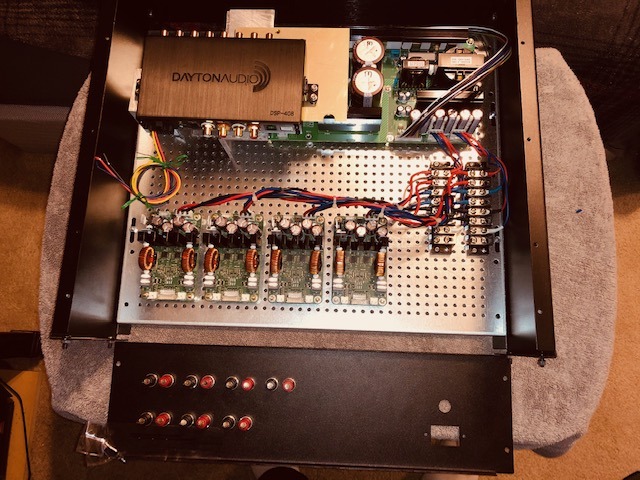

So now on to the build. I picked up a new case from the DIY store here. It's a pretty nice case made in Italy and should suit my needs just fine. I also ordered all of the necessary wiring from IcePower when I ordered the other stuff so I have that. I ordered a power switch for the front of the case along with some LED's. I ordered some RCA's for the inputs, (I'm going single ended for inputs because that is what my source and DSP unit have.) The rest of the things I already have.
After thinking about it for a while I decided on the layout of the components. I plan on putting the DSP unit inside the case to cut down on the amount of interconnects that otherwise make for an unsightly mess outside. So far, as of the writing of this post I have the PSU and all four of the modules mounted in the case along with the DSP and some shielding to separate the back side of the PSU from the wiring coming from the DSP as it is mounted above the PSU. I also have all of the wiring going to the 69 volt +/- rails hooked up. I have drilled out the back plate of case for most of the connections I will be using and have installed the speaker binding posts, in this case they are sockets for banana plugs. It is here that I find my self needing some answers to some questions that I have.

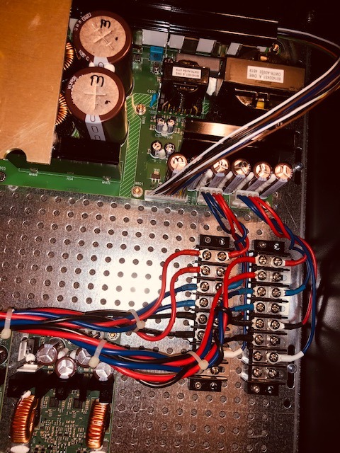

1- So first question relates to Vdrive. The PSU shows it as an out put and the modules show it as an input so I assume these two connect together correct?
2- Next has to do with DVDD/DVSS and VDD/VSS. The data sheet says to only hook one or the other up but not both. I believe that VDD/VSS are +/- 5V supplies and DVDD/DVSS are +/- 12V supplies. I have no idea which one of these supplies I should hook up. Is there anything needed in between? (resisters, capacitors, ect for current limiting and ripple)
3- Then there is some confusion with how the PSU starts up. The data sheet says:
ICEpower 1500S will start operating in disabled mode when mains power is applied to the module with only DVDD,
AVDD, AVSS and Vdrive running. Thus, to enable the main converter an external enable signal is required, or a pull-up
from DVDD to PSU_Enable. For more advanced applications, a wide set of control, status and monitoring inputs and
outputs are available.
My assumption is that you need the signal from DVDD out to jumper to the PSU_Enable input to start the unit? This also brings up how to incorporate the DSP power up function into the amp. It has 4 pins. 12 volt power, ground, 12volt trigger in and 12volt trigger out. I want to use the 12 volt trigger to enable the DSP as opposed to RCA sense as it is to flaky. So do I use the DVDD or VDrive to power the unit. I assume that I hook the 12 volt power and the 12volt trigger in to the same source or is there a better way of hooking this up?

I've managed to get this thing up and running. It is pretty clear to me that my current sound card in my PC is not going to be able to drive this amp to full volume as it isn't even putting out 1 volt with a 1000hz sine wave at full volume so I will have to do something about that. No big deal. Another thing that has become clear is I will be needing active cooling in the case. These things get hot. It looks like probably 2 fans will be needed and possibly additional heat sinks. There is a bit of noise coming through right now but hopefully I can tame that once I clean up the wiring and put some additional shielding between the amp modules. I might make a PCB for power distribution to eliminate a bunch of the wires. At least I know how it works now. No rush I haven't even finished the speakers yet.

Yea it all came together. It turned out really nice. Now if only I can finish the speakers that I built the amp for.Hi,

yes you are correct.
PS_OK_OUTPUT can be used for an LED to GRND for operational indicator light.
Put a latching push button between PSU_ENABLE and DVDD for a power switch. If you get a power button that has separate LED prongs on the back you can hook up both of these functions together.
The amp is in stand by once it is plugged into mains power.
Leaving the amp powered up with no signal will heat the amp up quite a bit so remember to shut it off once the music is done playing or your electric bill might go up.
I suppose something like that could be done using an external voltage in place of the DVDD. You would need to make sure that the PSU_ENABLE can handle the 12v input. You would need to refer to the data sheet to see what the max tolerance is. It might require a lower voltage though. That would be the simplest way I can think of without building a complete front end board that judging by your questions is beyond your current capability as well as mine.
One other thing that might need to be considered if you are employing both a power button for full time on/off capability and 12v trigger is a way to keep any extra current/voltage off the circuit if the switch and trigger where engaged at the same time that could over load the circuit. Maybe a set of relays that cancel one another when one is in use. Shouldn't be to hard to design.
