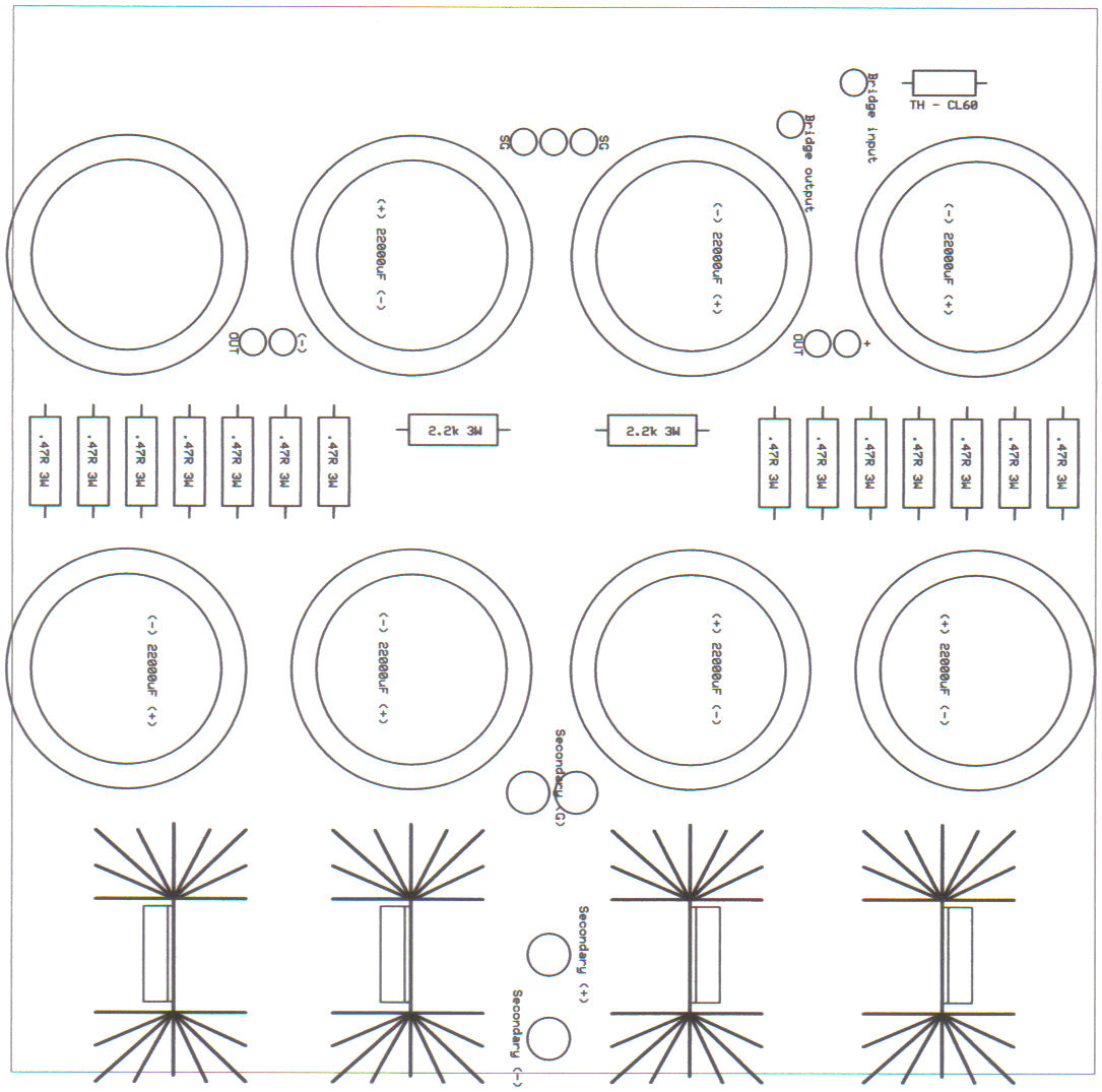

Here is a pics of the PSU board I will use. It may need revising as I am a PCB novice. Other members feel free to offer suggestions. THE board is free to use by anyone who wants to. I will add a copy without the detail to use as layout for etching. It is single sided with no jumpers. YEY! Will mount perfectly above a toroid on 3.5" standoffs and still be beloow my 6" ceiling by a 1/2". two can be added to my case for dual mono if needed, one over each of the dual trafos. My current ones are 400VA Antek shielded. I may move up to 600VA if necessary.

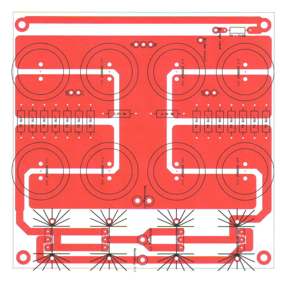

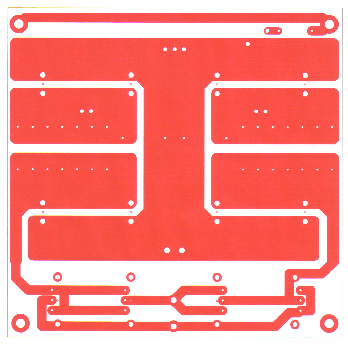

Here is updated layout. I went ahead and seperated the copper layer from the silkscreen. Stuff will not be here till monday, so I will be using the old PSU until then. Board outline is exactly 7" square.
40mm. Some 40mm caps have a third pin. I did not add that to the drawing, but it should be no problem drilling it if needed and it doesnt affect anything. I may repost with it added in a little later. You acn always clip the thrid lead. I have done this before as well.
Last night I spent some time both listening to the V3 and working, or trying to rework, the PSU. There is not an easy way to reduce the size of the PS board. Even double sided, you r real state is created by the size of the caps and components more than the layout. I realized that the 7" square version will not fit my current setup unless I mount the diodes to the main heat sink. This was not my plan, so a redesign is in order. I will make the boards longer, reducing the width. Hopefully I wil have an alternative layout for those who want it.
