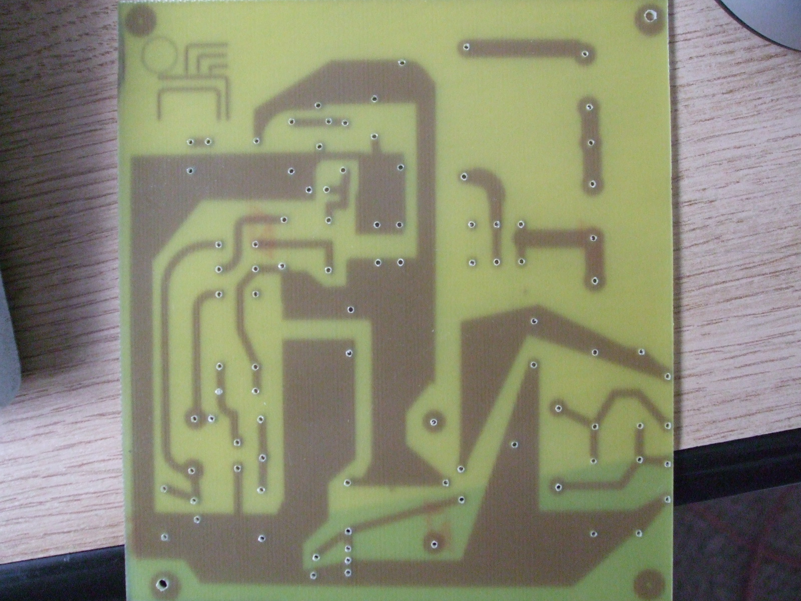

My F5
Got the first take on the new controll board out of the tin bath
So first PCB and SCH
Resistors values need to be confirmed so if you have suggestions they will be welcome
Circuit consist
A small trafo LM317 for 24 V DC suply
A one transistor flip flop relay
At power up It will be off and then togle on Off with momentary button (Posh Bulgin maybe)
As relay one close Relay 2 close and power up main traffo trough your faworite flavor of CL60 at same time C6 start chargin up and after a delay turn on the second transistor that Bypass CL60
A couple of led showing off what up on the front pannel
Flip flop was used on the first controll and worked fine all time
The components around the second transistor need looking at.

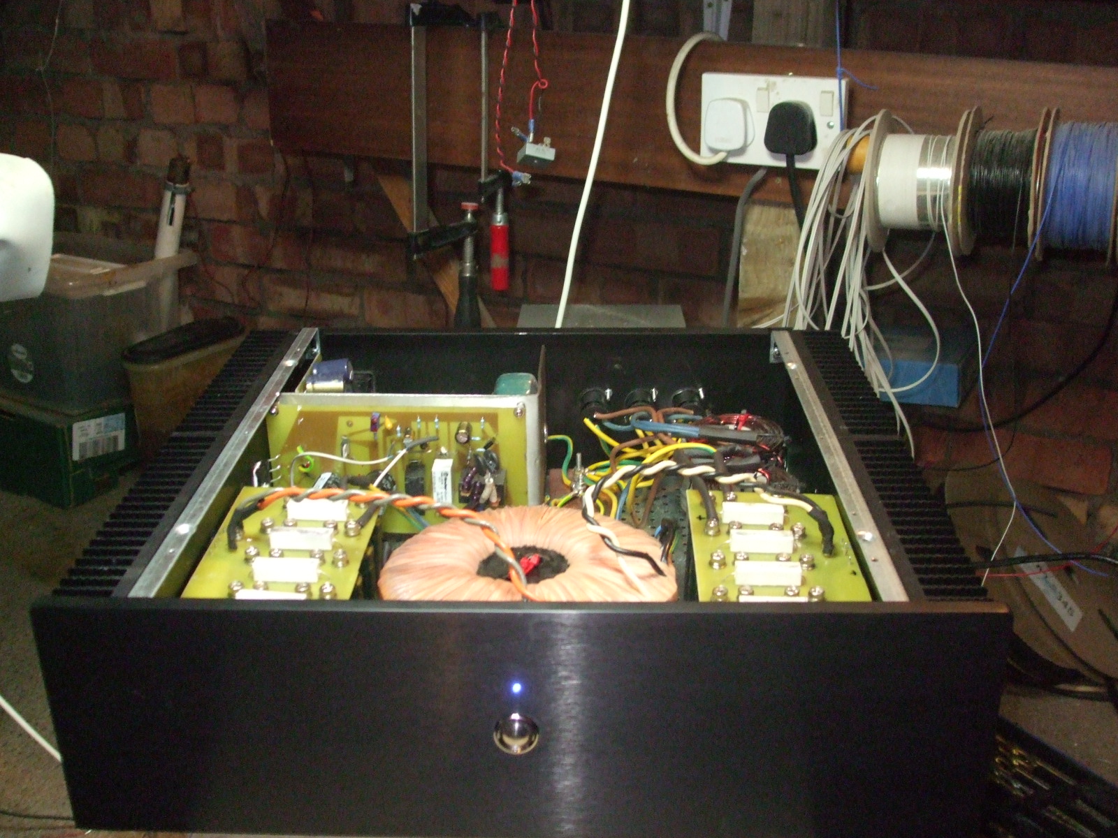

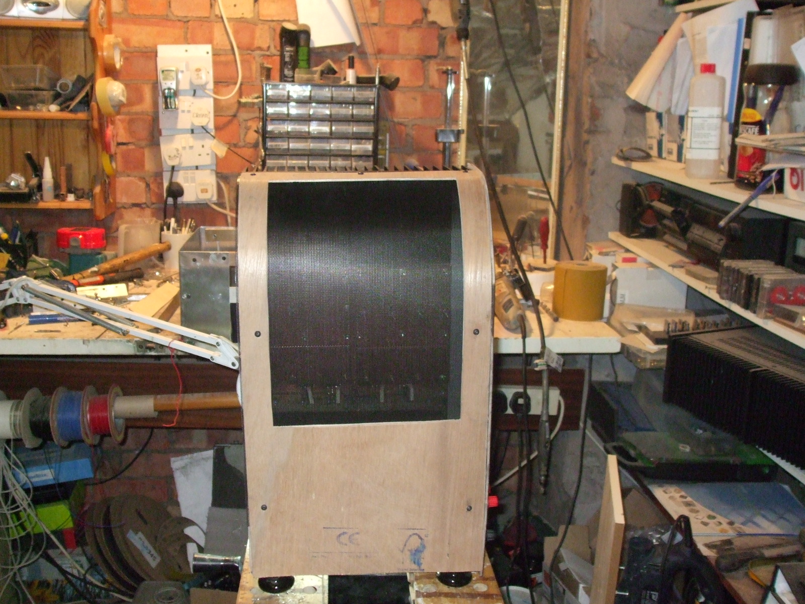

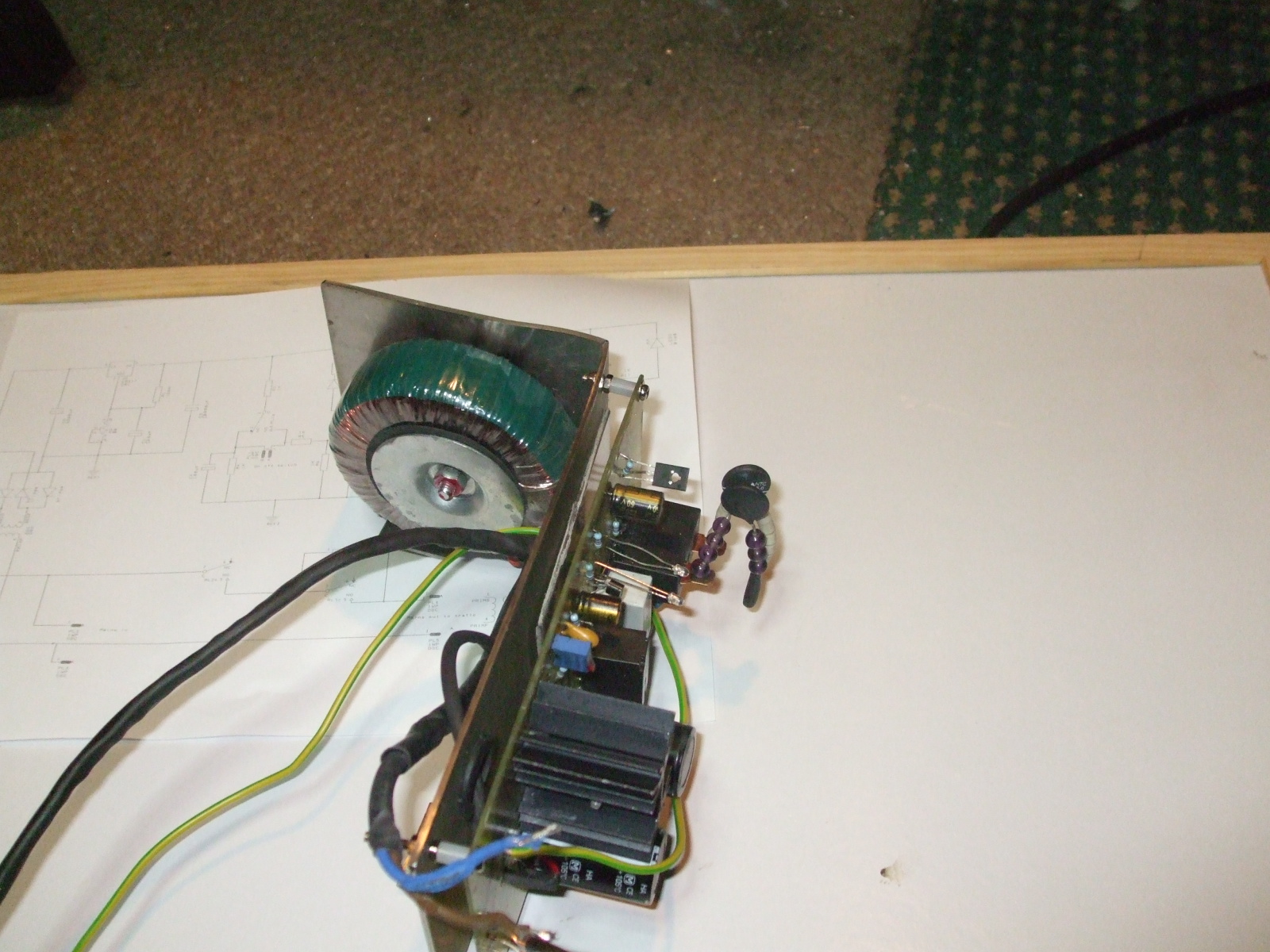

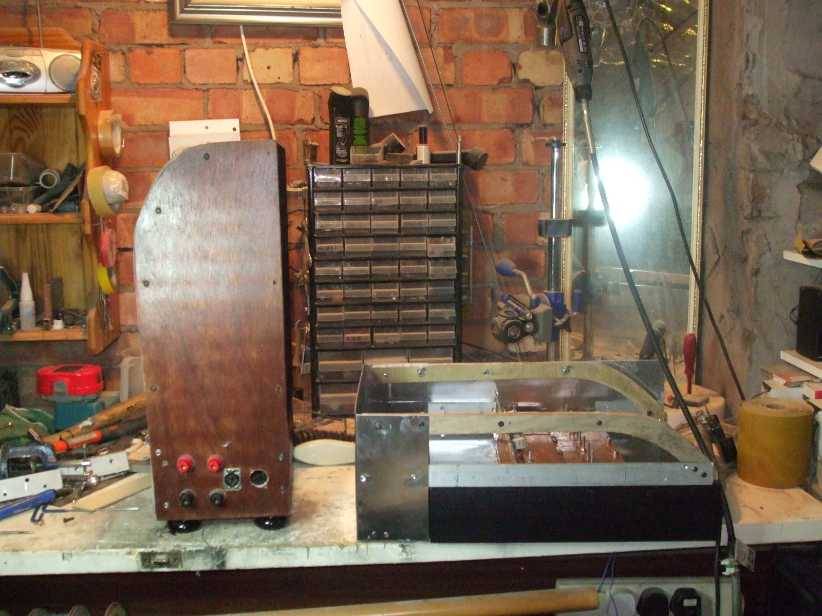

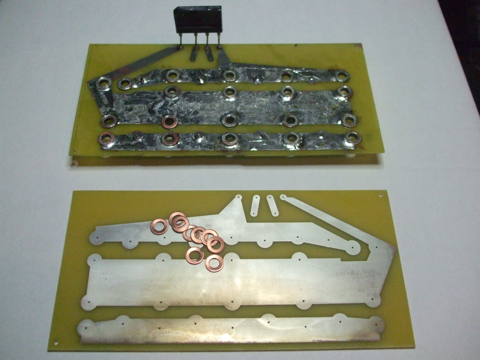

About my F5 still wery much of an ugly duckling.
PSU Auxiliary
New caps board
Finished PSU insides and front
One F5 ready to listen 2
and both on the bench.
By not means happy with the case but at least I got sometink to listen to for now.
