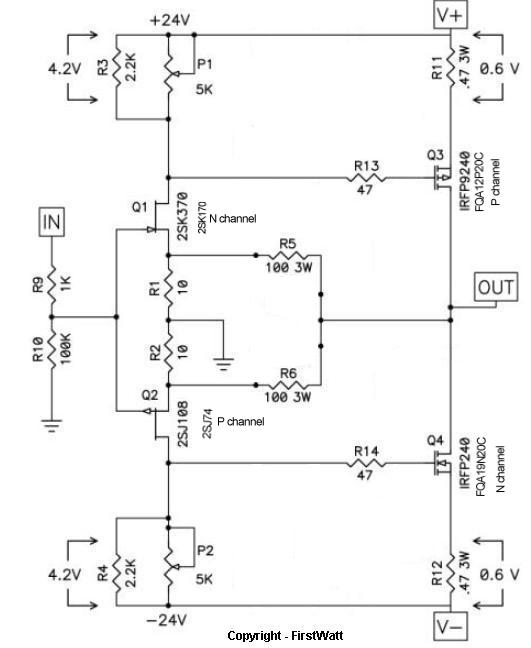

This is the circuit I built. I didn't realize I could eliminate R7 and R8. I didn't measure voltage drop across R3 and R4. I just made sure the Vdrop across R11 and R12 was 600mV and DC offset on the output was near zero.

The F5 circuit you built doesn't have the current limiting that the 'original' F5 has.This is the circuit I built. I didn't realize I could eliminate R7 and R8.

R5 & R7 are paralleled so they are equal to a single 50 ohm resistor. If using a single resistor, use 5W. A single 100 ohm resistor as in the schematic Peter Daniel shows would reduce feedback/increase gain and have a little warmer sound (probably the opposite of what you want if you are looking for a shinier top end)

removing one of the paralleled 100r does not require the remaining 100r to be of higher dissipation.R5 & R7 are paralleled so they are equal to a single 50 ohm resistor. If using a single resistor, use 5W.
