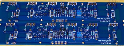

Well.....My F4 is under way.
Santa brought me matched triplets of 240/9240's all the way from Israel.
He also brought me some 74V/170V's from Hong Kong I hope they are genuine.
My question is on the trimmer pots; how do you know they are oriented properly for clockwise gain in Ω?
Also I ordered TO-92 heatsinks just for kicks; should I thermally couple the 74 & 170?

I don't know how to measure them, neither of my multimeters have transistor test on them.
Yes they were stated as Toshiba V's.
I purchased them on E-Bay from HKaudioparts, the 74's were listed at ldss=17.07ma.
My 170's came from E-Bay from UTsource.
I just so happen to have an LM317 on perfboard ready to go.
Would I be able to use this same setup at the working voltage for the application?
I would assume yes since there are no resistors in the circuit.
I have no nine volts but I do have a AA 8-pack holder with leads.
I figured I could run the circuit off of that with the LM371 to lower the voltage.
I have a second AA 8-pack holder that I could use also.
I heard it was best to try matching transistors while at their working voltage.
So.....I was just throwing that out there.

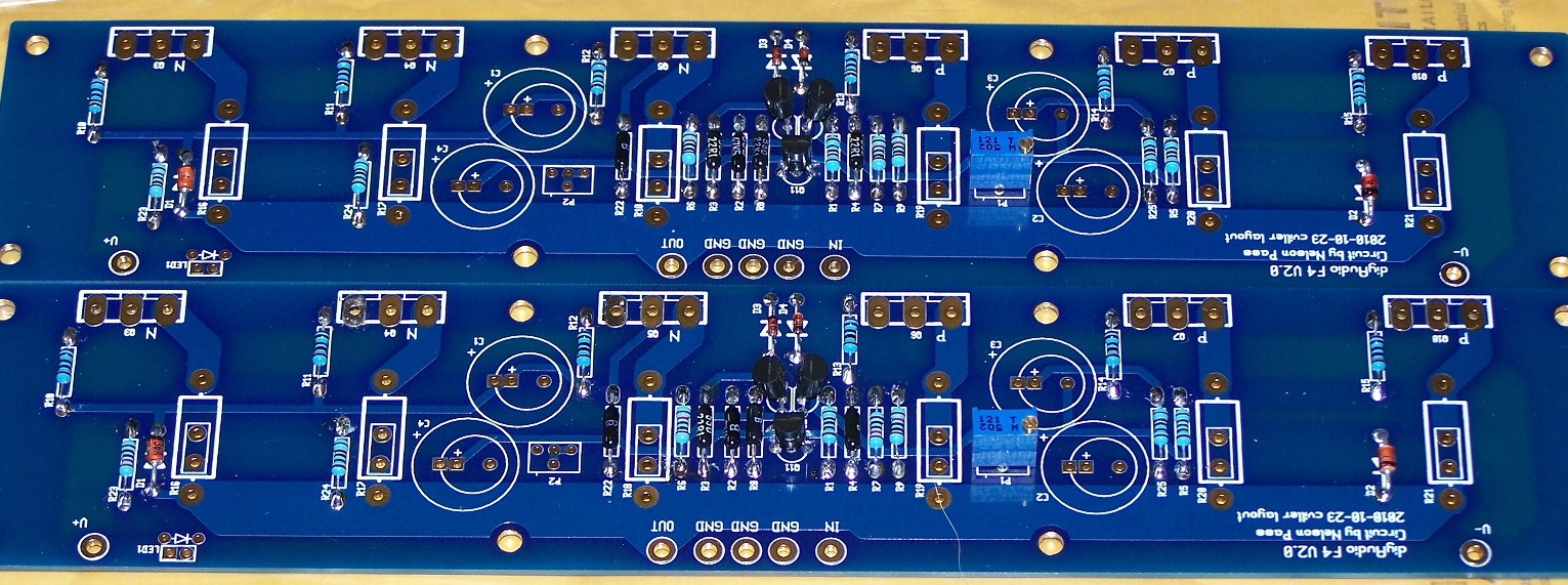

This may take a bit to get some good pictures.
My 74's do look nice and shiny with maybe a fine screenprint on it.
My neighbor has a $20,000 camera setup he can get good shots of them.
My Nikon is struggling a bit.
Upon closer inspection with a 6x hand glass my 74's and 170's are etched.
!!!DAMN IT!!!
Well.....Where does that leave me?
Who is a reputable source for genuine parts?
Spencer?
!!!DAMN IT!!!
Spencer?
So I guess the next step may be testing these to the rated voltage of the 74&170.
I'm kinda IRKED right now.
At this point I think I'm just going to get my de-soldering stuff out and remove these JFET's.
I don't even want to risk firing this thing up with my known genuine output FET's.
I wouldn't try to check the "rated voltage" of your jfets. Just check the Idss with a 9V battery, or your 12V AA pack, whatever. The main thing is just to see what you've got. If you need genuine jfets, try Spencer or seller "alweit" on ebay.
oh, just remembered Mouser has more 2SK170's in stock right now (BL's): http://www.mouser.com/ProductDetail...=sGAEpiMZZMsCAa3STv8uCYUtR2s0T0G1CCKMDb1ds9w=
so grab those while you can

With a closer look at the parts he has for sale it looks like his FET's are etched in the same way as mine are.
???Maybe I don't have fakes???
How can I tell for sure if mine are fakes?
Both the 74's & 170's I have are etched in the same manner and are from different suppliers.
Just checked my jfets from Spencer and they are printed. I have dealt with him before and he supplies well matched devices just ask for what idss you need and he will let you know what he has before you order.
