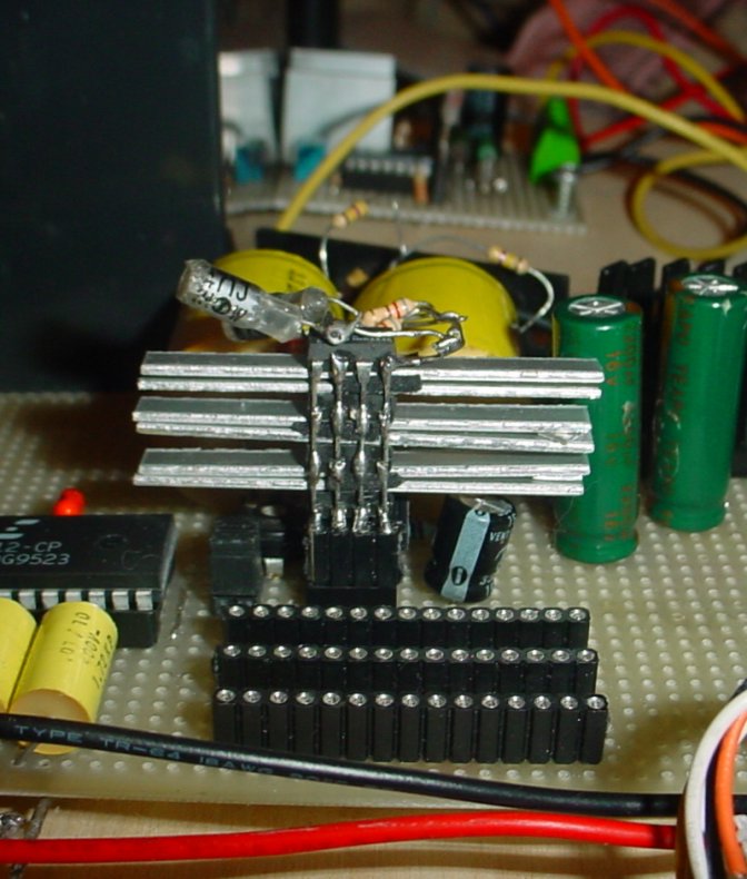

any pics on the cooling?
I see... My setup will have Guido XO's on both the CD (I already have it in my Marantz) and the 1543.
Pos pics of that arrangement! what's the highest temp. desirable on the chip tower?
For the pics... first I have to borrow a digital camera.
For the temp... the datasheet only specifies 250 mW of dissipable power but this value, as well as the thermal resistance (100 °K/W) are quoted without cooling arrangements, so don't give good info on a safe temperature.
As a rule of thumb the chips shouldn't be too hot to touch.
Cheers
Andrea

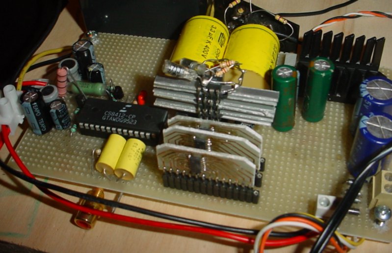

Last one for now, showing the dac tower and the cooling arrangement. It is mathe with aluminium pieces cut to size. The blak thing that you can see near the chips is neoprene, an elastic polymer that holds the Alu pieces pressed to the chips.
This works well for me.
To take this pic I removed the 74VHC74 mounted on a homebrew SOIC to SIL adapter and intended for asynchronous reclocking (not implemented yet).

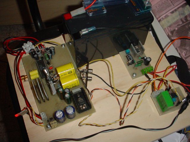

a picture is worth a million words...
thanks for the shots Andrea!
That battery looks like a UPS one, isn't it? Same as me... I had it already...
