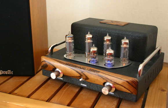

Music Angel XD-SE hum
Hello all,
This is my first post, and I'm a complete idiot when it comes to the inner secrets of audio gear. That said, I'm really enjoying my new amplifier, apart from an irritating hum on one channel. I've also noticed that the volume control seems dirty, as it makes a bit of a crackle when I wind it around.
Any of you wise people have any ideas how I should troubleshoot this? Maybe a spot of servisol in the volume control??
Thanks for you help in advance!
-Peter

Re: Music Angel XD-SE hum
I use Deoxit to clean 'scratchy' controls. Works well but has a little smell to it. Not really obnoxious but do the spraying and cleaning outside, in the basement or the garage if you can.
How old is the amp? If it is an older amp (even if it is new) it may have a bad coupling capacitor which could be contributing to the noise in one channel. It could also be a bad solder joint or poor ground connection or even a tube.
Try changing tubes from one side to the other and see if the noise follows the tubes.
BTW, if you aren't familiar with tube gear then be extremely careful when poking around inside one. They generally operate on lethal voltages and the caps can often retain a charge for a very long time after the amp is turned off and unplugged.
Read the thread here on safety before opening up your amp.

I bought an XD-SE500 Music Angel two weeks ago and mine also developed a hum after a few days in the right channel. Seems to me 50Hz. Already swapped the tubes from right to left evv. No result. Any more suggestions how to solve this ?
With regards,
Marcel
With regards,
Marcel
This could be due to inadequate shielding, a grounding problem, poor layout or a poor connection somewhere.
Thanks Ray,
I unscrewed the underplate. Seems to me neat and tidy. So I removed the first amplifier stage, a 6N1. Still humming. Put it back and removed the second stage 6N9. Now the hum is gone... Gives tis more direction were to look ?
Problem solved !
My version of the EL34B Music Angels uses a seperate powersupply (seperate winding on trafo) for the 6SN9 (so the supplied scheme is outdated...). With the scope I saw a raw sinus after the first rectify diode where I would espect almost DC. Turned out to be a defective bufferelco (250V/120 microfrad). Replaced it and the hum is gone...
