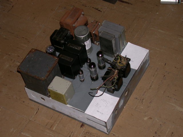

I bought the cheap punch set from ebay. It has two bolts, 4 dies and 4 nuts. From the photo I guess it is the same set as that from HaborFreight. I punched six 7/8" holes and three 1 3/32" holes on a electric break box. The bolt used with the 7/8" punch was worn to a point that the nut was not straight with the die, and when I was punching the 7th hole the nuts stuck on the edge of the die. I did not notice and I kept turning the bolt. I heard a big sound and the bolt was broken into two pieces.
The bolt used with the 1 3/32" punch was severely worn after three holes. Fortunately I need only 3 big holes for my EL34 amp. I guess it may be able to punch another 3 holes before it dies.
I could not wait 1 week to buy on ebay, so I went to home depot and bought a 0.89mm(roughly 7/8") punch with $30. It is very good. I needed less force to punch the same break box. After 4 holes I observed the bolt and there was no sign of wearing.
This is my experience that might be useful to you guys. I guess the much better cutting edge design is the reason why less force is needed with GreenLee. Maybe the bolt quality is higher too. It well worths the price.
