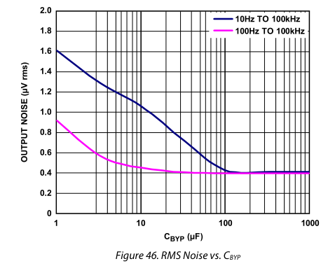

If you guys are so concerned about regulator noise, how come none that I can see are talking about ADM7155? With a big enough BYP cap (100uF) its noise looks considerably lower than LT304x and also ES9311 :
According to this post about ADM7150, that huge cap doesn't actually translate into better performance. It's as if noise isn't the only piece in the puzzle, golly shock horror 🙂

The guy in that post is saying the BYP cap influences the sound a lot (not really a surprise). But I suspect its at least in part capacitor microphonics which is doing it.
Incidentally I 100% agree with you that overall, output impedance is more of a concern than merely lowest noise. The ESS DACs modulate their own supplies so you'll definitely want to minimize this effect.

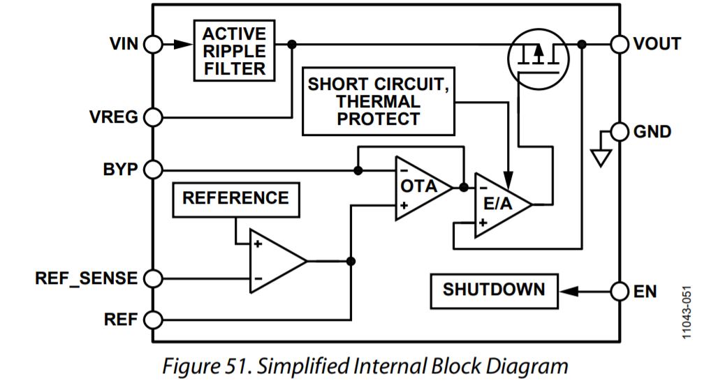

What concerns me about ADMxxxx is the diagram attached below.
It appears that the bypass cap doesn't just filter the reference, it slows down the output of the whole error amplifier, which means transient response is slowed down.

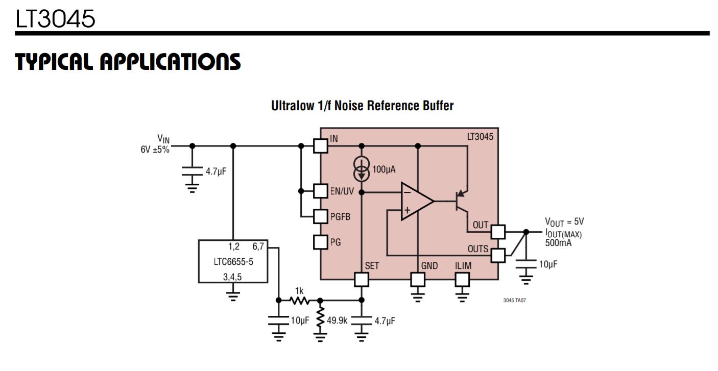

For earlier versions a AVCC supplies, and what still works for mobile parts like ES9038Q2M is to use an opamp like LME49720. They are fast enough and low noise enough, etc. that they can work pretty well using them as a non-inverting buffer with a 10uf to 47uf output cap (no they don't oscillate). Last iteration with my Q2M dac involved modifying the existing opamp based supply to use LTC6655 as a reference. Not the only thing that works, but it does work.

That's a significant difference to the LT3042. I'm sure you've seen it doesn't use any error amplifier gain to set the output so noise, transient response and bandwidth are more constant than any other ldo I have seen. It also seems to happy with huge output capacitance - I'm now using Panasonic FR 1,000uF 16V with an ESR of 20mΩ and that works well 🙂 Cset is up to 15uF and I plan to try more but I've run out of time today. I finished op amp rolling and settled on OPA1612.
Not opposed to using LT3042 per se. I use one with 20uf Cset for some things. Probably worth trying the LTC6655 and LT304x combo for AVCC, too. However, at the moment I am not working on an ES90x8PRO board, so no hurry to dig into options.
