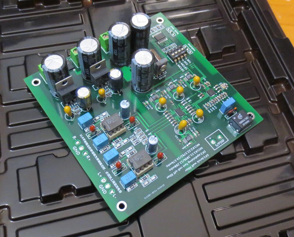

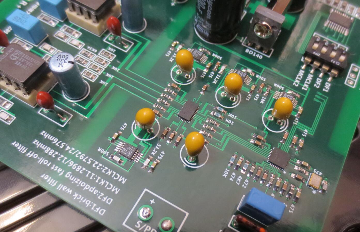

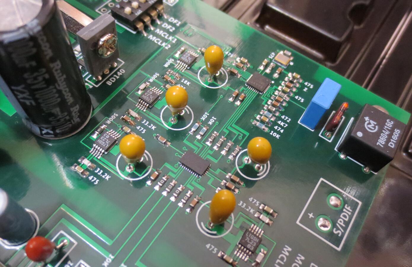

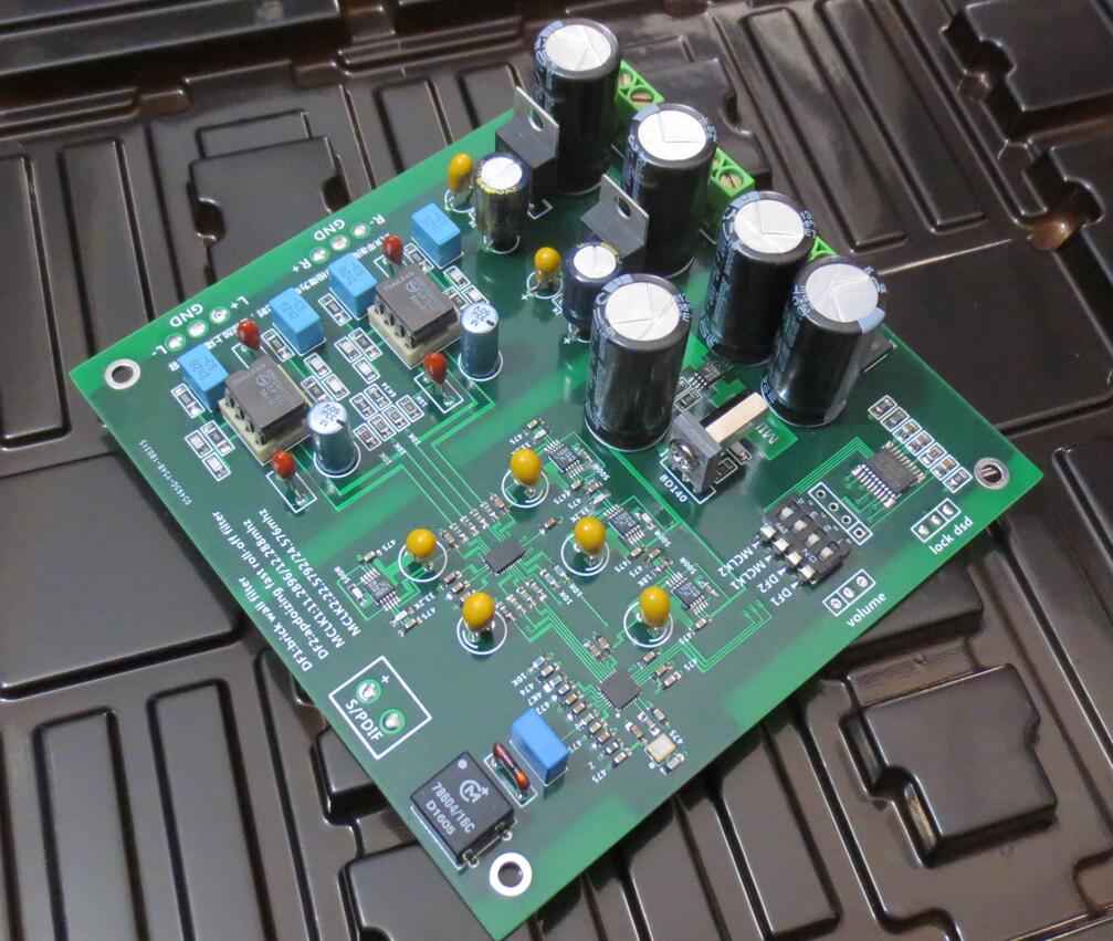

It use a es9038q2m , works in i/v mode , spdif input by sa8804 , support pcm 44.1 to 384khz , and dop64 to dop128 , sync mode mclk , has shutdown the asrc of es9038q2m .
the sa8804 spdif receiver can output a mclk , rms jitter below 15ps ,it's the best dir on the world .
there are four LT3042 work aroud the es9038q2m and sa8804 , a Parallel regulated power supply befor come into lt3042 .

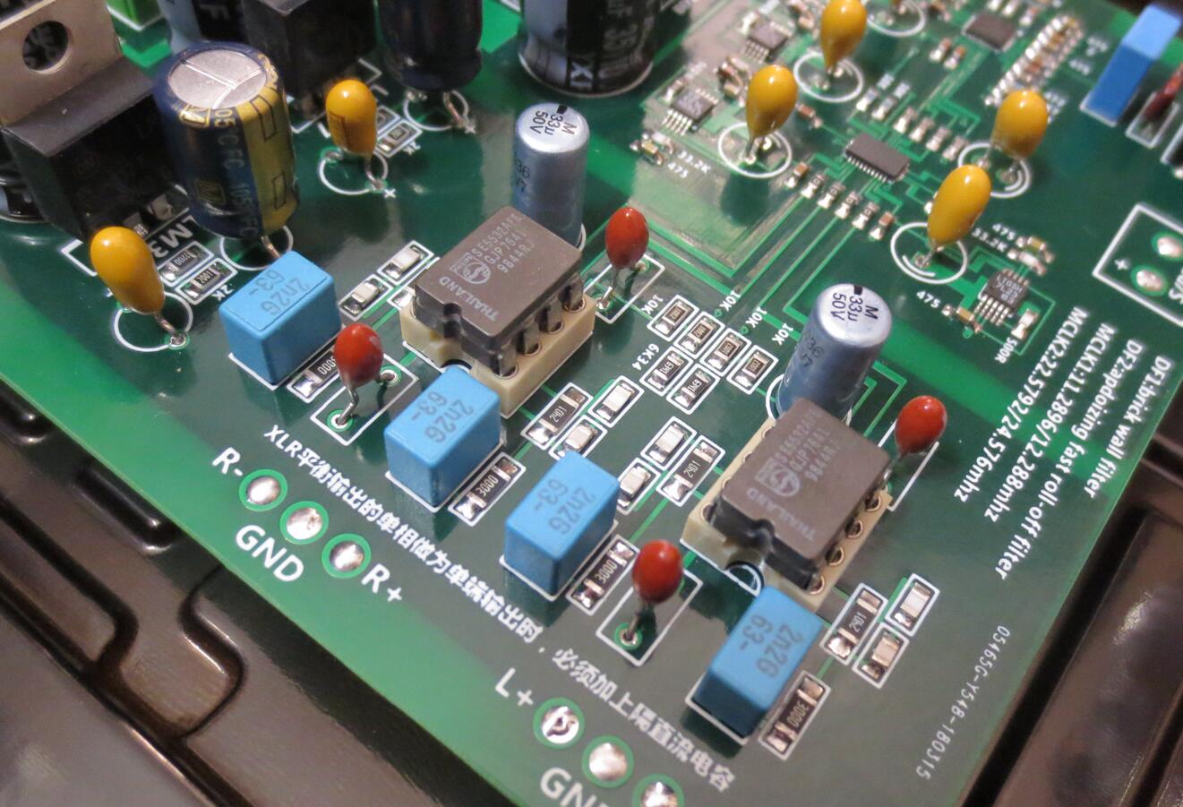

You so clever ! yes , i realy output by transformer , it since better than opamp .
the ne5532 just to be a I/V .
because my mclk is 22.5792 and 24.576 , although mclk2 switch can select asrc and sync , but i can't found any difference .

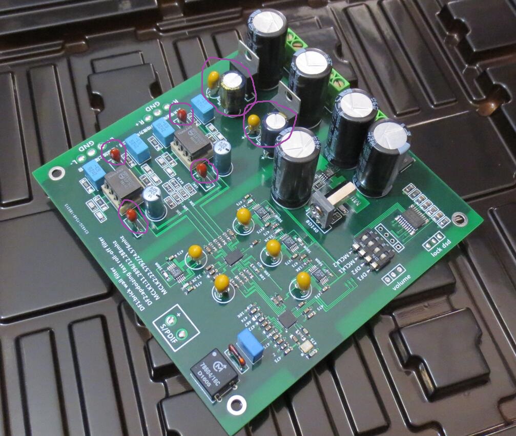

Why did you change the capacitors?
The are not on original bord?

Balanced XLR to single ended RCA converter is readily available and cheap on ebay. You can easily upgrade the NE5532 to opamp of your preference.The board is on ebay. But the output transformers I could only find on Taobao here
It should be better than the transformer based "output cattle". If you must have the transformers, it is on Ebay.
there are several cap had been changed , for it's sound
