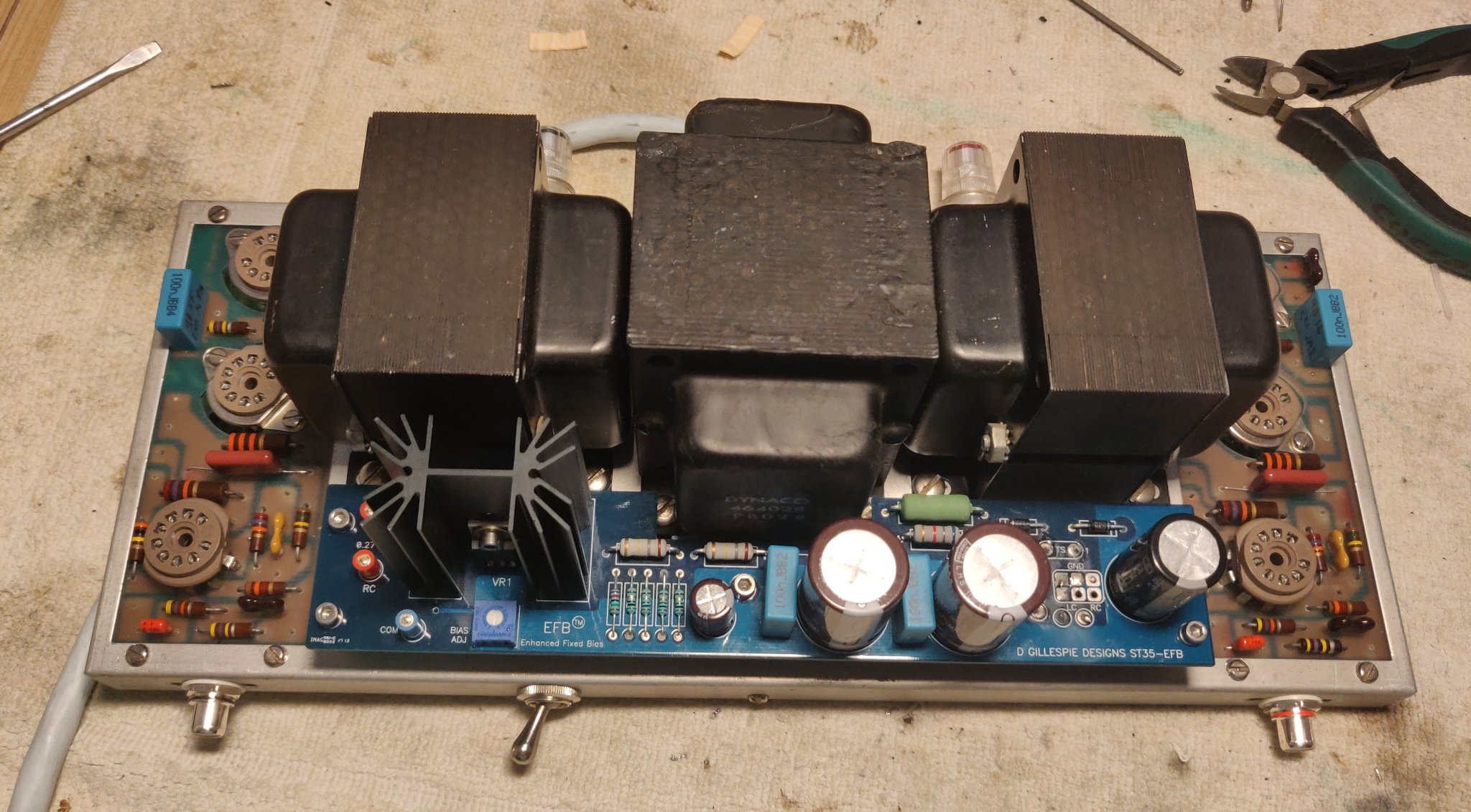

Please post a PICTURE of the inside of the amp. the Hum is 99.9% due to a ground loop (somewhere). This is a very established old-school design that does NOT hum.
I now I have restored a couple before without no problem, i insert pictures.

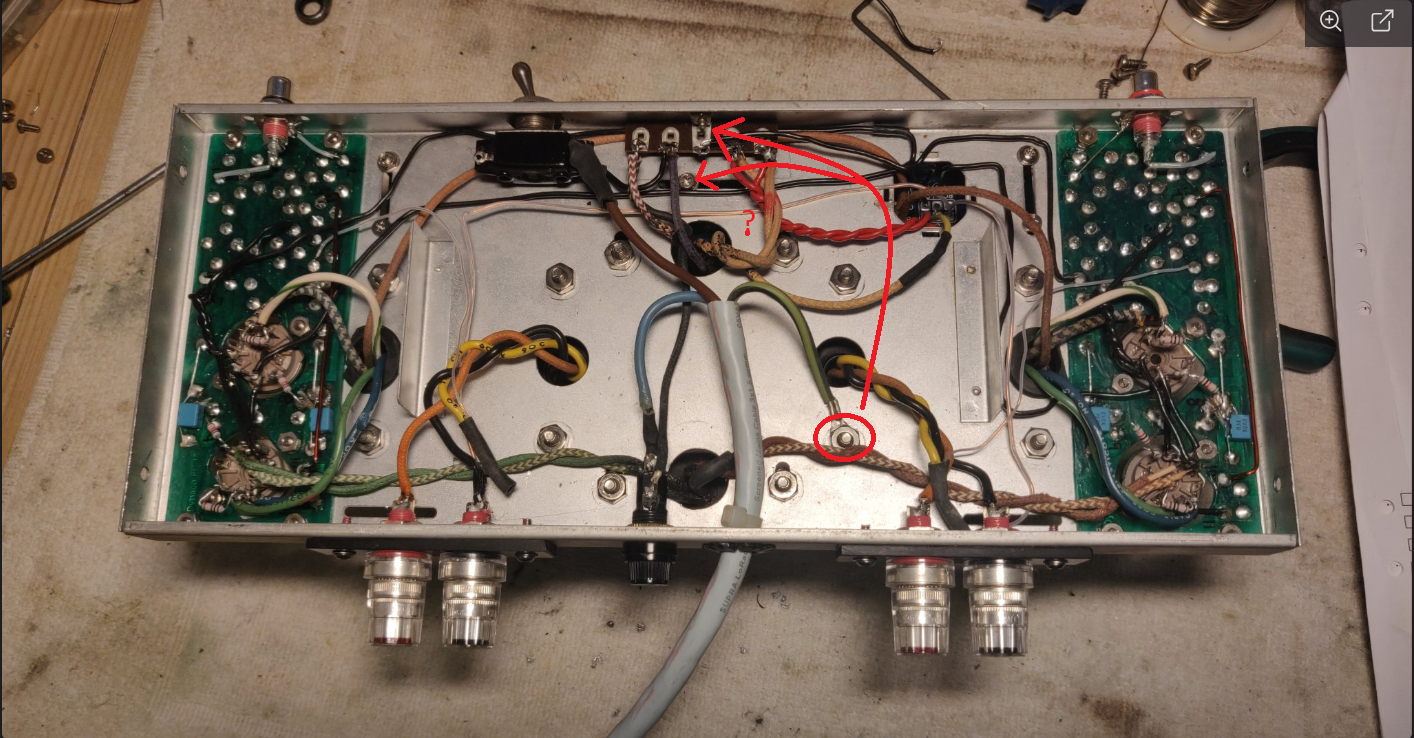

50Hz hum (from 50Hz mains) suggests ground loop to me. I see lots of potential ground loops on this chassis. Thanks for posting the pictures...
For a potential quick fix, move the ground connect on the chassis to the screw that holds the ground connect on this tab board instead (like I indicate in the attached picture... or maybe the screw under it which is on the chassis...

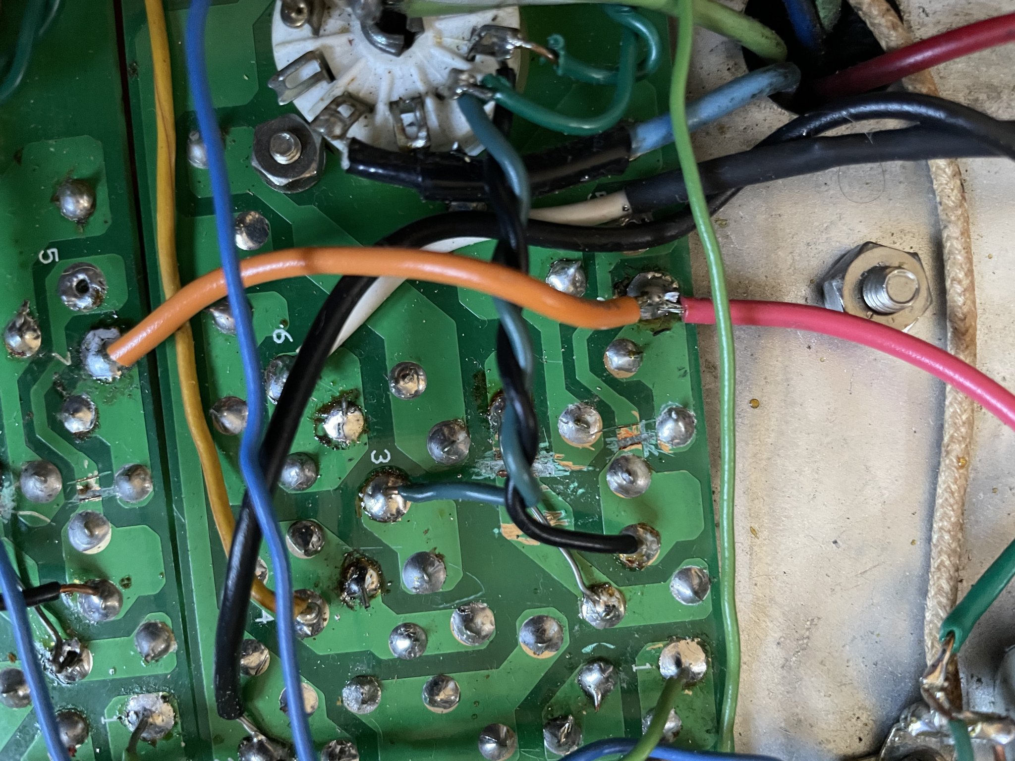

I modified my SCA-35 with repro Stereo 35 boards and the EFB circuit. I found that with the EFB, the driver tube was a little more susceptible to picking up heater hum. I'm not sure why that would be, but if your boards approximately follow the original layout like mine do, there's a long run on one of the heater traces. I cut those traces short, then ran a tightly twisted pair from the near EL84 to the driver/phase splitter tube. Green and black twisted pair in the picture. This fixed the problem.
I will take a look at that, thanks.

Nonsense, moving the safety ground closer to what appears to be the main ground point won't hurt. If it changes the hum level then it is most certainly a ground loop!
Looking at his boards (right and left) it also seems that they might grounded to more than one point (it's hard to tell for certain though). It could also very well be that the grounding of the 'Gillespie' fixed bias board is the culprit. Maybe it is grounded by wire, as well as directly to the chassis, or the bell of a transformer, etc.. This appears to be a tight build so could easily happen.
Ever have the stand-off touch the ground of the circuit board (as well as the chassis), and also have a 'proper' ground wire connection from the circuit board? That becomes an instant ground-loop. There are seriously many potential sources of ground-loops.

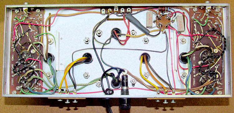

Look at the picture hooman posted. This is what the st-35 normally look like - lots of space and simple layout. I know from experience that the version of this amp doesn't hum.

Hooman's st35 is one of the better examples how it should look. Then we must consider that most of the people who built these had zero idea what they were doing, even their English was non-existent.

I would try making up a source of 6.3V DC heating power, and apply that on a channel in place of the AC. If I'm remembering right, that's how I found the issue in my build. No need to tear the whole thing apart. Checking for duplicate ground paths is of course also a good idea, but I think it would give you 100hz buzz rather than 50hz hum.

There aren't many likely causes for 50hz hum in the amp, 100hz buzz would be more likely in various scenarios. Plus testing/fixing possible heater hum induced into the 7247 is one of the easiest things to try, and a tight twist to the tube pins is more theoretically correct anyway.
