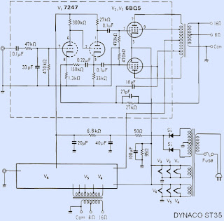

A schematic of course

Separate windings for each channel see the diagram I have added.
