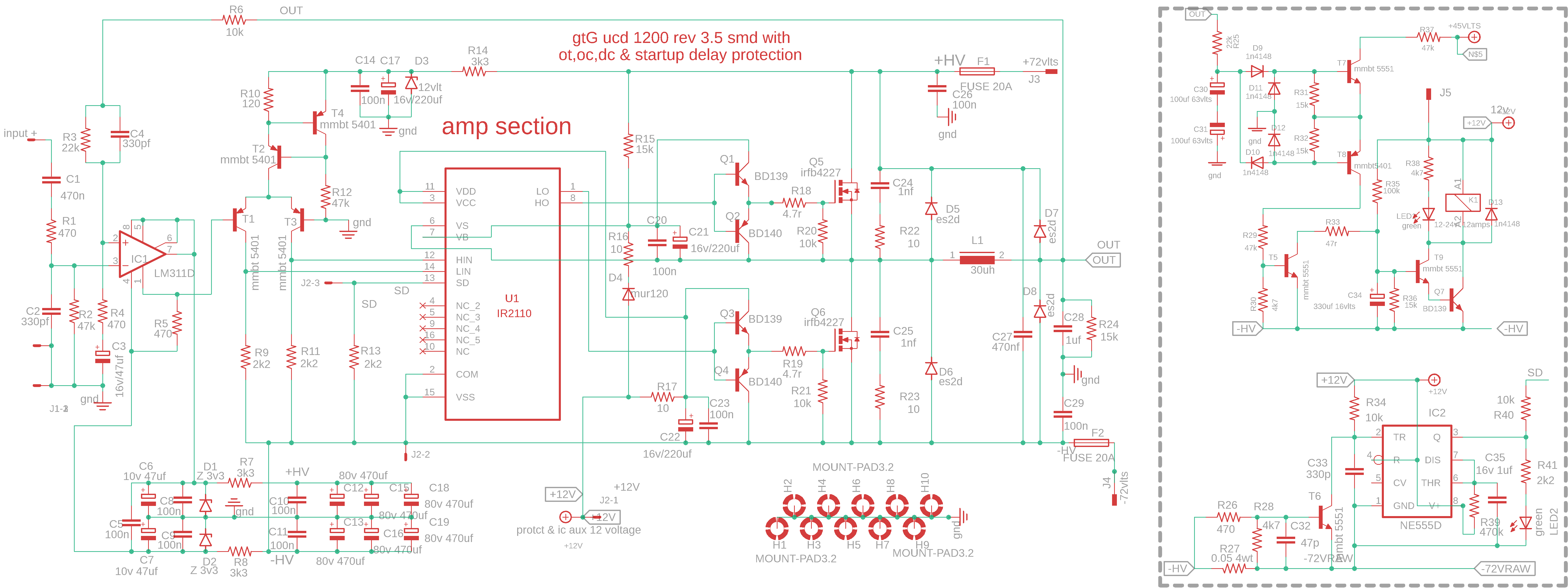

hi acca , i wanted to make my ic ucd version project , better and stable , i also wanted to use a maximum of +/-72vlts fullbridge at 4ohms with irfb4115
kindly share your opinion in the schematic. i will change the protection part to use manoj aud600 one cause it was very effective.
😱😱 btw i thought non discreet will use few components and a smaller board , but still is big
i chose ir2110 schema cause i have used the amp with irfb4227 at full bridge +/-85vlts at 4ohms with good success, just wanted to make it stable.
hi stewin,
ucd amps are, by definition, unstable. 🙂
When you say "stable", what did you mean exactly?
Are you referring to failures? to osc blocking? to protection trip?
Ucd is a well know design nowadays... lot of design and research around it.
It should work well, and be simple to debug.
Another story: are you sure the power supply is good enough for feed that beast? Amplifier is only half the battle.

thanks acid k2 for the reply. i found ucd stable when you compared to sigma delta , its down side is that you have to design it nicely cause of hf noise interference . i have a good smps power supply 🙂
do you have a stable class d topology ? , kindly share the schematic
