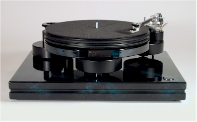

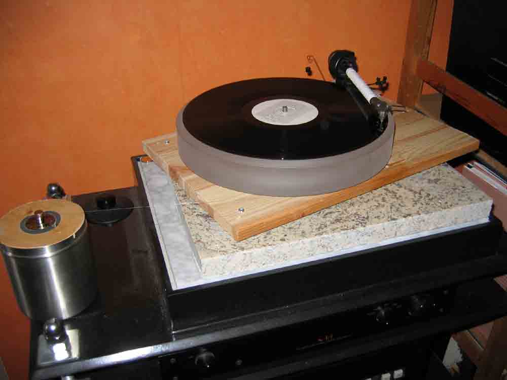

my Scheu in wood is here (simply disregard the Morsiani turntable or the Schroeder tonearm spotting in the background)
Werner took this picture of my Scheu in steel base in 1997 or so:
The steel base is tear drop shaped with around 25cm diameter at the turntable end and about 10cm diameter at the tonearm end. it is about 30mm high and weighs more than 10kg. It was offered quite cheap, IIRC for 250 DEM, about 125 EUR/USD, and Mr Scheu stopped selling the steel base, when the steel workshop who actually manufactured the base, moved away.

That looks great! But.... I'm still not satisfied.. You're using two layers of wood : what kind??
Earlier on I was dreaming about making a plinth somewhat like yours, a piece of mahogany or something like that of abouy 5 cm thick..
It's getting hard to make up my mind:smash: Maybe I'll just stick to my earlier plans, and when the curiosity is getting too much there's room for experiments!
Allthough my plinth is only 2 cm thick, and I never took it serious, I don't think it's that bad at this moment🙂

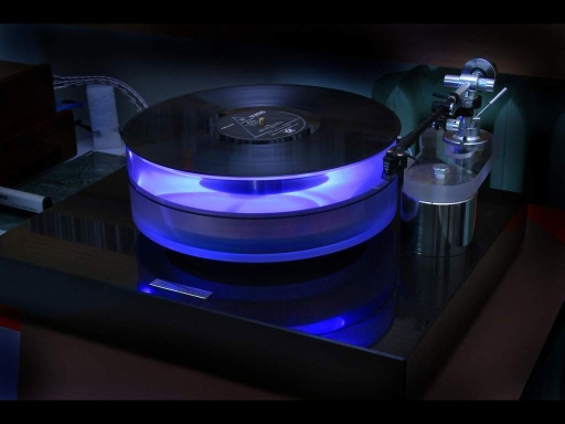

Audiofanatic: isn't that last one a Nottingham Analogue? If so, it's a Corian base, which is really a very good material. I used some for a Garrard plinth and it worked better than real marble for me.
This stuff is very readily available in a wide range of colours as it's a standard material in the bathroom and kitchen installation industry. I bet you could make a plinth out of the bit left over when the hole for a sink is cut!
Compared to Acrylic, Corian is really easy to machine using tungsten carbide tools. Special router cutters are made for it with less back-off than the regular ones. Not too expensive if you only need one or two for a project.
Personally. I've always found acrylic to be one of the nastiest materials to work with - for me it always manages to crack, chip or scratch at just the wrong time and it can melt, too. The stuff also manages to blunt HSS tools very quickly. YUK! The only plastic I've found nice to work is Delrin and I don't think that's a plinth material!
Alloy plates holding the bearing, bonded between Corian layers - would look really cool, nice alloy stripes round the edge??

Hi, I've heard one of these and they are really good - comparable to. say a Michell Orb for quality.
Given a Scheu bearing and platter it should be s simple DIY job to make something similar that would perform at least as well.
I'm really taken by the Corian/aliuminium sandwich idea, and I have a spare Teres bearing, so.................
regards, Jeff
