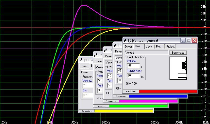

Heloo. I`m new in diy audio...i have bought focal 30a1 subwoofer for car audio...
specs
http://img.w3dizajn.net/images/specasbc.jpg
I used chipboard 18mm, it`s cheaper and still good..The box is tuned to 50hz whit this port and has 45,210L.

For finish i use cotto veneer and oak lacquer i think. :D The bass i bad meening good. I can`t stand next to him :D
I`m thinking to make a low pass active filter...but i have time later...
So what do you guys think? :D

Fs 37.4 Hz
Vas 52.97 I
Qts 0.42
Qes 0.45
Qms 6.37
Re 3.2 ohms
Sd 510.71 cm2
Cas 3.77E-07 m5/N
Mas 48.02 kg/m4
Ras 1771.39 ohms.ac
Cms 1.45E-04 m/N
Mms 125.24 g
Rms 4.62 kg/s
Ces 598.43 mF
Les 30.26 mH
Res 45.3 ohms
BI 14.47 N/A
SPL 89.73 dB/W/m
Hi, for 45L vent tuning at 50Hz is far too high, 30Hz to 33Hz IMO, :)/sreten.
