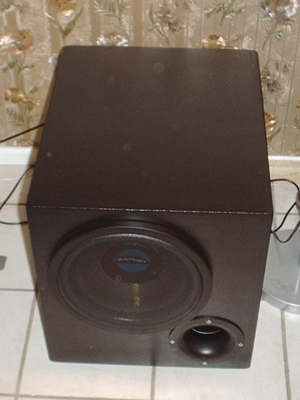

well i finaly finnished my diy sub!
it features:
1. partsexpress 250W RMS plate amp
2. BLAUPUNKT PCwi1200 12" SUBWOOFER 200W RMS
3. COSTOM MAD ENCLOSURE..... 2cu FT. "I BUILD IT MY SELF!
4. PNR AEROPORT KIT 3" DIA BLACK PLASTIC " 13" LONG TUNING ENCLOSURE TO 25hz
___________________________________________________
THIS THING KICKS A$$!
IT HIST 20HZ NO PROBLEM.......
SOUNDS GREAT AND LOOKS GOOD.....
I WILL POST PICTURES TOMORROW......
THANKS TO EVERY ONE WHO HELPED ME......
YOU KNOW WHO YOU ARE.....😛
I POST THE PICS TOMORROW....

this baby rattles the walls!
pic1.
yo,
do you guys have any tips for leavaling these things.....
i mean i have a tile floor and it is a bitch to leaval this thing every time i move it a little......
and it it is not leavaled just right it rattles because one of the spikes is not in full contact with the base.....
is this something i am going to have to live with or is their something i can do to make it easer to leaval?
note: if you guys didnt know tile floors are uneven and my tiles are textured so mine is even more un leaval as a not textured tile floor would be......

I have the perfect idea
Hey long time ago my dad had this little level for his record player it is round some ar big some ar small you can buy them for cheap what it is is a little center level that is what you need you put it on the top and when the little bubble is in the center it is level have a look around there perfect that is what i use to level my audio stand..
Jason
I second using three spikes. I would move one of the rear spikes to the middle of the enclosure. If the ecosure is very heavy you should stick with four spikes (or if it's really heavy like mine, 375lbs, four spikes don't cut it). Are those PE spikes on the bottom?
VR,
Digi
