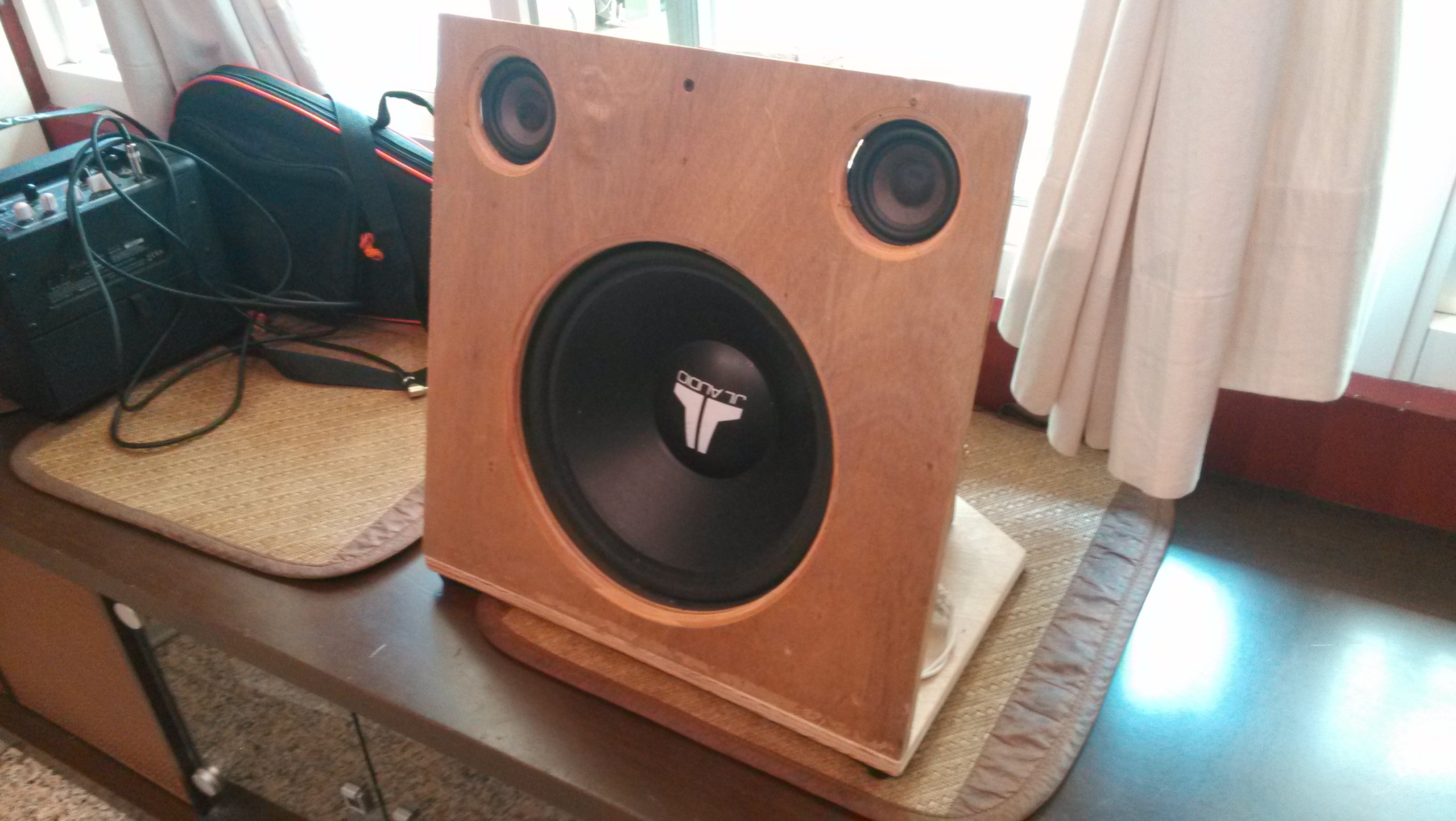

Over here, I made a boom-open-box with salvaged parts. I picked up a JLAudio 12", couldn't make a good enough box for it that was mobile enough, so I went open. A couple of rusty from salty air fullrangers and since I blew up my little 2.1 D amp, I combined a mini bass amp with an old TPA3116 I had.
Projects sound surprisingly loud and far. I will add some protection and a handle. That will be it.
Next will be to try it with my electric ukulele!
