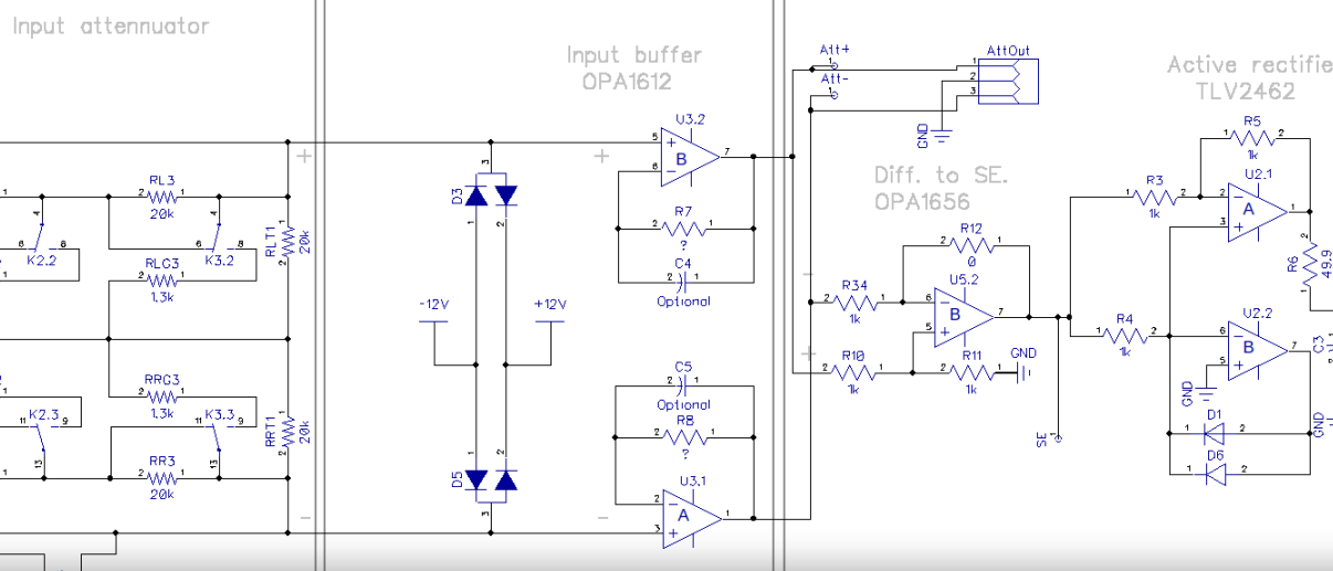

The current outputcard is balanced out only, so I needed a differential probe designed by @alfredr (Which is btw. very kind to help me out)
The probe is very good, giving me nice measurements.
What it can do or more like what my intention is, but I do think it's working pretty good now ::

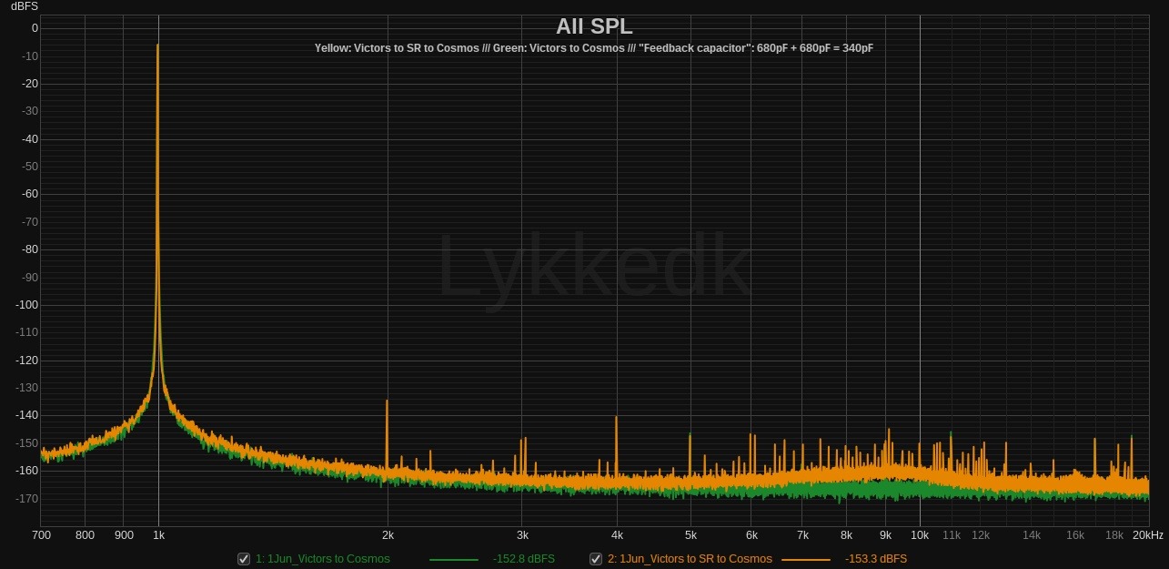

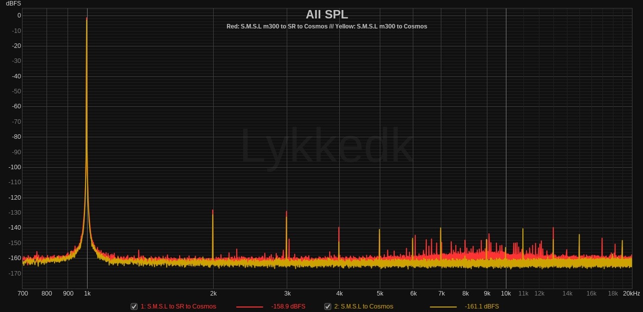

The gainpart (the output card) of the SuperRanger add's some distortion on it's own. (Picture FFT1)
When I tested it with my hacked Behringer soundcard, it look's like the SuperRanger is not adding anything, therefore I decided to upgrade my soundcard to one of the Cosmos ADCiso's, as I read that they are very good.
The yellow trace is where the SuperRangers own distortion can be seen when using the Cosmos ADCiso.
It's the outputcard witch adds this distortion.
As can be seen below on Picture FFT2, where I took a shoot of the attenuator output on the Motherboard, the Motherboard, attenuator part is more or less clean.
FFT1 ::
FFT2:

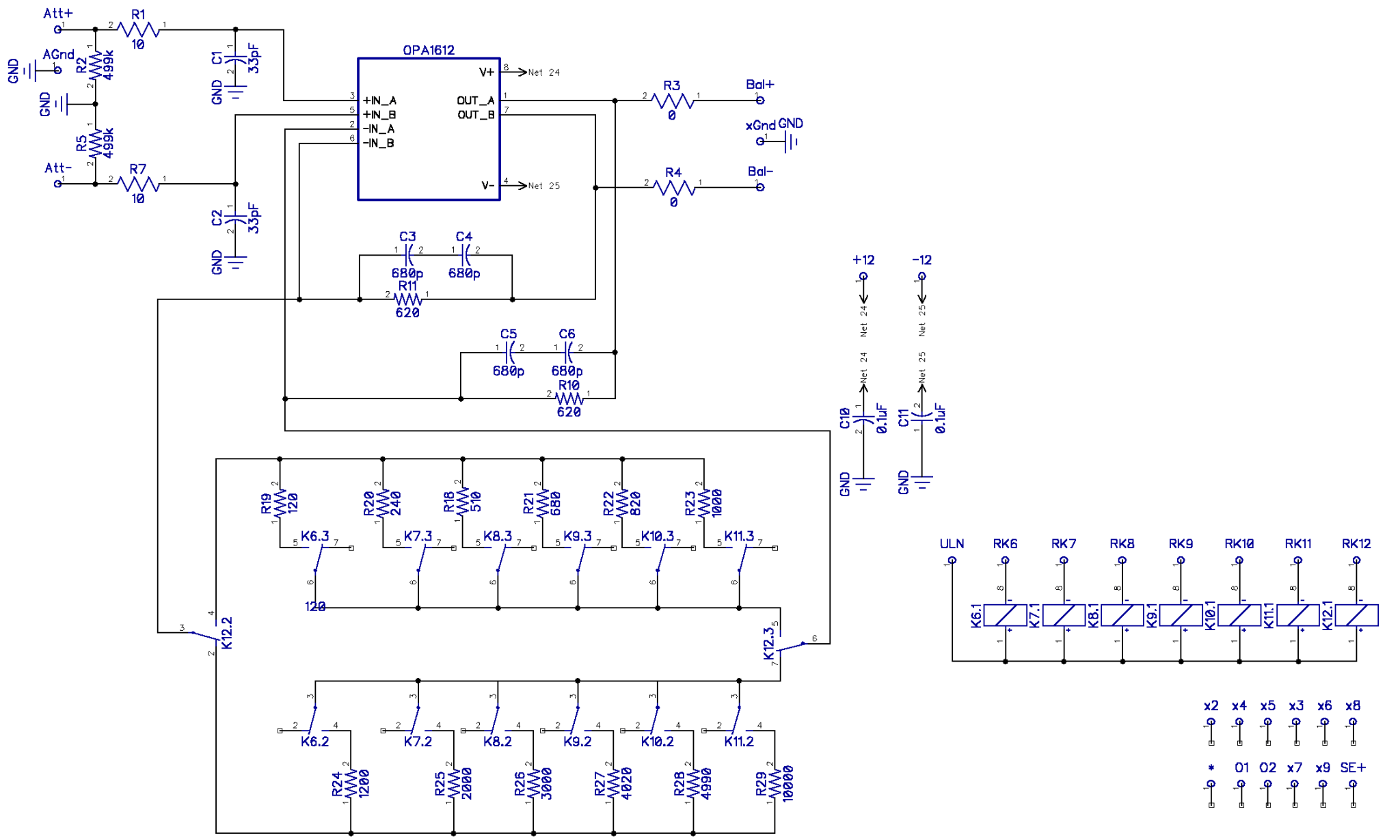

Here is the current outputcard used :

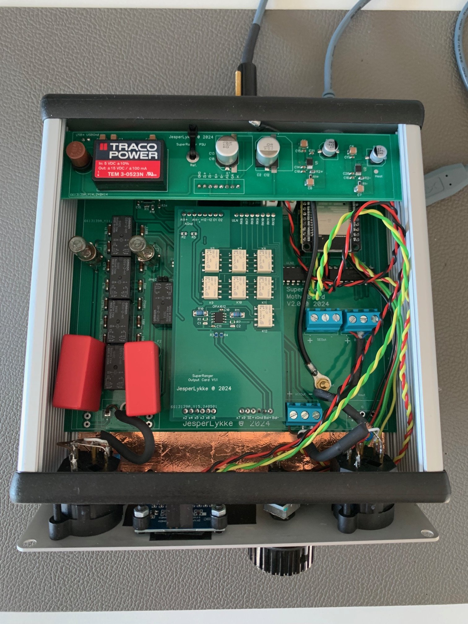

And some pictures of the whole setup, prototyping, testing etc...
This is an older picture, the PSU is different now, with some better regulators (Seen on schematics of cause)
The Motherboard without output card plugged in ::
Last one just a showoff one sry...

- With the outputcard I use now, there are 64gain steps (0db to approx 25dB or so).

Question: The last graph with the gray trace is the attenuator without the active circuit? Before U3? Is the auto-Super range working when you are measuring this way?
I was wondering why we didn't hear any news from you lately, but obviously you were working on this! Excellent work! To my eyes looks miraculous!
Hi MagicQuestion: The last graph with the gray trace is the attenuator without the active circuit? Before U3? Is the auto-Super range working when you are measuring this way?
EDIT :: Also see the rightside AttOut plug, that's connected to the output jack TRS connector. The "balanced" output is connected to the XLR part of the combo output connector.
EDIT EDIT :: The "gain" part of the circuit is on the outputcard only, the attenuator output is only attenuation, no gain only attenuation.
The output directly after the attenuator circuit is after it's buffered through U3 OPA1612. The resistors R7 & R8 are just 0ohm, and none capacitors at C4, C5.
So the grey trace is after some active circuit. - That's also why I can say for sure that the distortion down at -140 at the yellow trace is not the attenuator circuit but the plugable output card

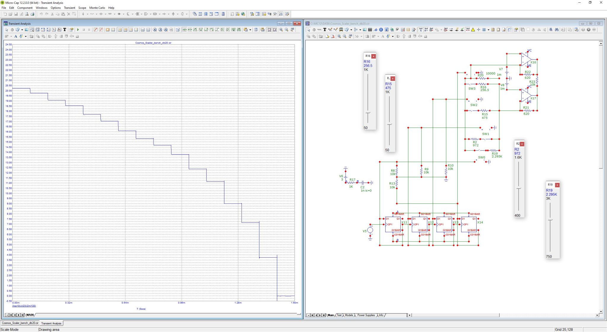

I did simulate this with MicroCap, as you also suggested in the Discord channel. - I'm getting better and better using this fine program.
Well looking at the yellow trace I posted in post #1 here, the only distortion and a little raised noisefloor is the last remaining bit I cannot solve.
Not saying I'm not satisfied, but I know it would be very hard (for me at least!) to get rid of this last -140dB forrest of noise.

Here below is a recent picture, with the "newest" upgrade.

Yesterday I raised the two "feedback" capacitors in the outputcard from 470pF to first 560pF and than last to 680pF, this lowered the noisefloor a bit, and removed some of the grass around 7 - 12kHz area (I don't have the screenshoots here at work, but I can post it later today)
It's soo good, that I actually told myself I was finish now.
Jesper.
After some more studying I tried changing the feedback capacitor another time.
Now they're 680pF + 680pF = 340pF, and both noisefloor and "FFT Grass" is lowered some, but 9kHz SuperRanger Bump still remains.
I have to say, I tried also with my balanced S.M.S.L to test other freq. etc... there are not really any difference here.
It look's like there is a minor/small difference in using balanced (SMSL) and SE(Victors) signal source
I did keep the level at the same when measuring.
Anyone any idea howto get rid of the 9kHz bumb, or should I just leave it as is ?
Jesper.

Good to see some suggestions...
I use TPS7A4901DGNR & TPS7A3401DGNR, I've seen them in circuits with highish capacitor's, but I will try my other PSU with good old linear regulators just too see.
I also did design the PCB with the suggestions from the datasheet for this TPS7A psu, same goes for the OPA1612 in the "half" instrumental amp. I use to give ESP32 controlled gain in 64step's.
Jesper.
Yes I tried without feedback caps, but the THD are very bad then (unfortunately I did not take a screenshoot of this one)Have you tried without feedback caps? Also, I can't see what regulators you are using but please check datasheet for possible max allowed capacitance especially at the output.
Yes, I've tried both 50ohm and 200ohm, but the input impedance of the CosmosADC is rather low (around Diff. 1.66kohm) Doesent do any change, except voltage is dragged down.Are R3 and R4 = 0 ohm as shown in the schematic?
Jesper.
