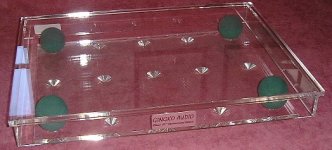

On second thought, if i were to build a brand new rack i might follow this concept.
It offers a lot of flexibility regarding matrials and has interesting ideas regarding vibration control. I think it's really cool.
And if you really must use those :)balls
