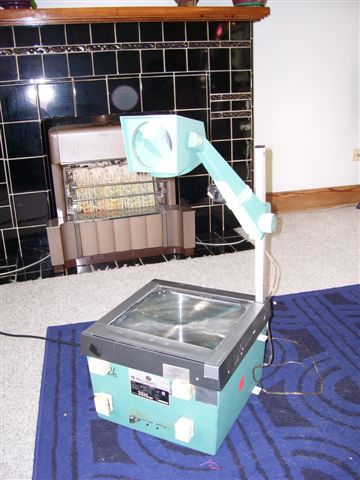

Now that I have told you the reasons that swayed me to the "beamer" design I want to go through the part list with you. First off all the quality (well 90%) is in the type of overhead projector used; my first version that still worked well was using an old cheap bell and howel 301g. The 301 beamer I first made was at first real exciting because mainly it worked. As I used the 301 beamer more and more I started to become a perfectionist with the miss alignment of the lens, fresnal lens and bulb I got a color bleed to the NE of the image. This Bleed was not that bad and my girlfriend thought the image looked good but I new it could be better. Not only did the 301 beamer have a slight bleed but it had some serious heat issues with a 600 watt bulb I was getting up to 47 degrees Celsius at the inner wall of the 301 beamer (put a digital thermometer inside). With all this heat I had to have many fans going to keep the heat down on the LCD screen. With more fans = more noise.

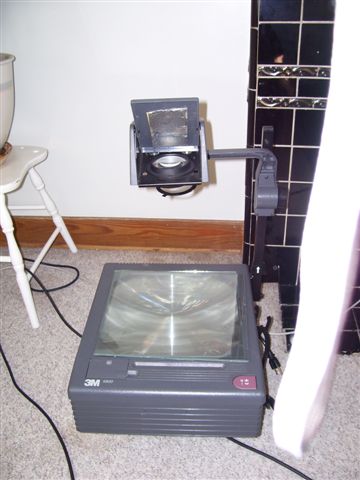

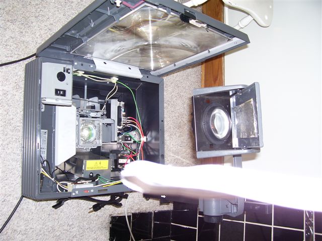

So at last I said good bye to the 301 beamer and began the hunt for the next overhead projector. Well I started out looking for the new 3m OHP 1800 series but that soon end when I started to see the price. Well I then started to look at the 3m 9500 and was intrigued at the lens they use a triplet lens which mean I can fine tune even further by focusing plus the whole image even in the corners will be in focus (Which is the main problem with OHP designs "beamers") I was Just about to buy a 9500 when I found a pair of 3m 9800 which is the same as the 9500 but can put out a 6000 lumens compared to 4000 for a good price on flea bay.

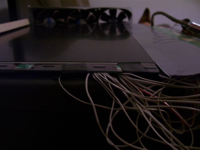

Now that I have gone on about the OHP and LCD I want to talk about how to assemble it all. First thing to do is take off the layer of glass that is on the OHP you will not need this since most 15" LCD screens are larger then the stage area of most OHP (well at least in width wise) next you want to raise the LCD a small amount from the OHP I would say about 1/4 inch should do to allow the fans to blow some air along the LCD screen to cool it.
Once you have the LCD screen laying 1/4 inch on the OHP you need to mount the control board on the OHP (as you can see I have not done this yet) now attach all the cables and such. Next we have to build a VGA cable that will extend the distance from your computer to the beamer (if you plan on having the computer next to the projector then don’t worry about this step). For information on building a extended VGA cable using shielded cat 5 cable go here http://www.myhometheater.homestead.com/vgacable.html

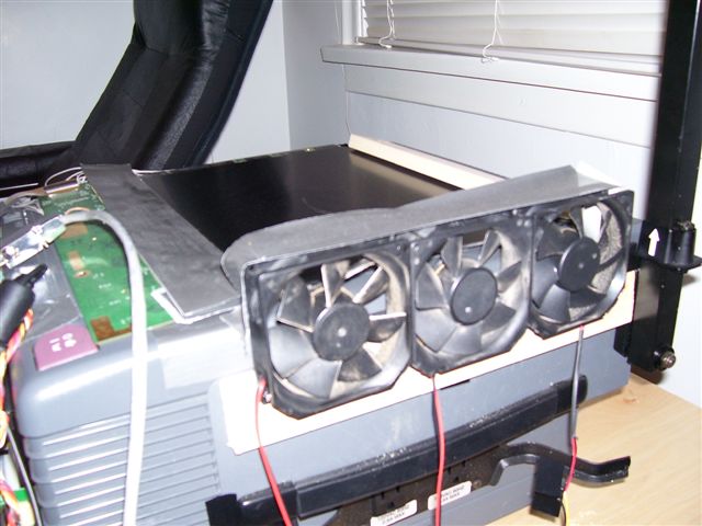

The final step we have to do is mount some fans to cool the LCD, this is really simple, I just glued on some wood to the side of the OHP and screwed in three computer fans to the wood (you can get these computers fans from old power supplies or case that have fans). To power the fans just use a old computer power supply If you don’t have a AT power supply with a hard switch and only have a ATX power supply you will have to short it to turn it on this is simple too just solder or jam some wire to join the small green wire to the small black wire next to the green wire. To turn off and on the PSU (power supply unit) u can just unplug it or instead of soldering wire to the green and black solder a switch.

Just to let you know there are a few things you can do to make your projector run a bit better... when you first get your projector you should take it apart and clean any surface that the light goes through lens LCD screen mirrors anything EXCEPT THE FRESNEL LENS IT SCRATCHES TO EASY JUST USE LIQUID AIR OR LEAVE IT ALONE (the fresnel lens is the lens that looks all funky with the circles). Another thing u should add is an internal thermometer I used a radio shack thermometer that has an outside cable with sensor and just drilled a hole in the OHP and put the sensor in there. Also you will want to go around with Duck tape and cover any little cracks with light come out DO NOT COVER THE FAN INTAKE AREA.

The promised pics
the old 301g

On a diffrent note does anyone know why when i turn on the fans i get a few waves hsync of the image. I think it is caused my electrical noise but i am not sure. I even stopped each fan with my hands and i still get the slight distortion. The distortion is of course goes away when i turn off the PSU.
