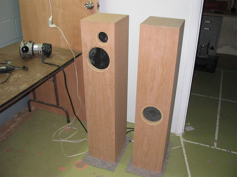

Well after 9 mo. of break in they are keepers......I have done no x-over mods and the sound is great, sooooooooo...Im going to pick up the veneer in a few hrs....and finally get these things done !!!! 😀
I still have the extra cabs anybody need a set ????
Ill get picks up if the veneering goes well.if not

DaHos said:Well after 9 mo. of break in they are keepers......I have done no x-over mods and the sound is great, sooooooooo...Im going to pick up the veneer in a few hrs....and finally get these things done !!!! 😀
Ill get picks up if the veneering goes well.if not![]()

MJ, I have had them running for about a year now
and I am now getting around to finishing them up.....I was a bit worried about the veneer but all went well, even the driver cuts. I used my Dermal tool to cut out the center and then used my router with same recess bit as before. Turned out great!!
So,, how are yours comming ????? 🙂

Well, the things I liked most about commercial ProAcs are the curvey D-tapered grills and funny looking plinths. I spent so much time and effort trying to emulate this, in the end I really didn't care if the sound might turn out only average.
I'm glad to say they're 100% completed. And, as a modest DIY priced 2 way, with ripe bass, the sound is top class. I give it an A. (75%)
Some pics, and construction details to be updated-
http://kram0.com/gallery/
