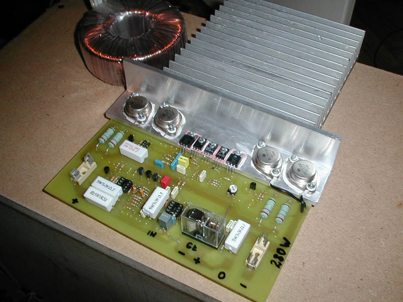

My DIY economical subwoofer
Features:
Enclosure: 25 litre bass-reflex of 22mm MDF, Fb = 38Hz
Amplifier: discrete above 200W@MJ15003/4
Power suply: 250W toroidal transformer, 8 x 4700uF
Weight: 18kg
