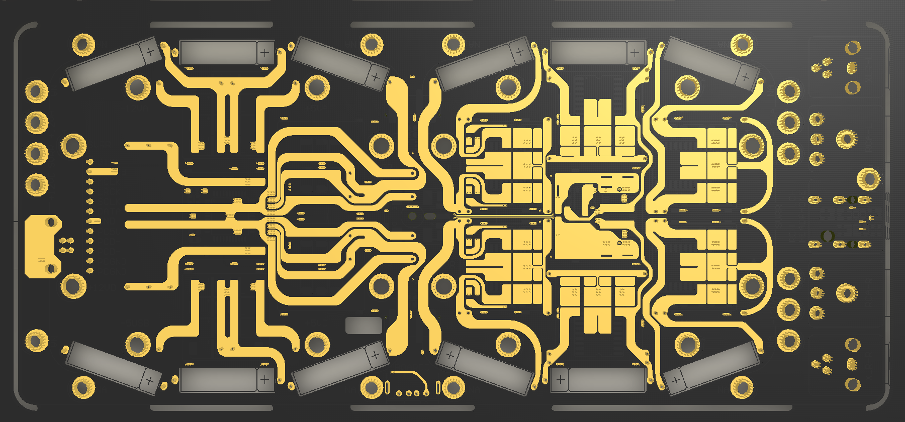

Inside the PCB
Love Symmetrical structure
Top Layer with silkscreen
Top layer Track
M1 Layer Track
M2 Layer Track
Bottom Layer Track
Bottom Layer With Silkscreen
Real PCB Panel (570 x 530mm)
Impedance control report
Very beautiful I2S square wave signal
All PCB layer view
De panel
3D Assembly Exploded view
Top layer Track
M1 Layer Track
M2 Layer Track
Bottom Layer Track
All PCB layer view
De panel
