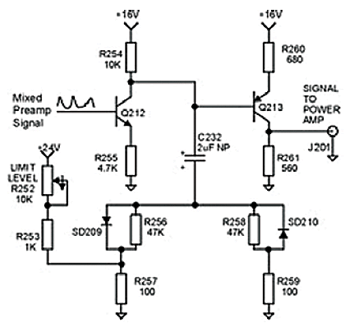

Hard clipping is also deadly for Germaniums, for the same reason, they "stick" against one rail ... and stay there for an appreciable length of time, while the other half already turns on.
No protection will protect you from that, so Designers simply didn´t allow transistors to EVER reach there.
Famous VOX amplifiers (Beatles - Rolling Stones - Status Quo - Queen -the Royal Family as Rock is concerned) incorporated what they called "the VOX Limiter", not what we would call it today but an adjustable clipper which was set up so drive signal was clipped so power transistors did NOT reach supply rails , missing it by a few Volts.
If really dedicated, you could add one to your own, it´s a simple circuit.
For a more complete explanation:
https://www.premierguitar.com/adjustable-clipping-in-vox-amps
http://www.voxshowroom.com/us/amp/watchdog.html
