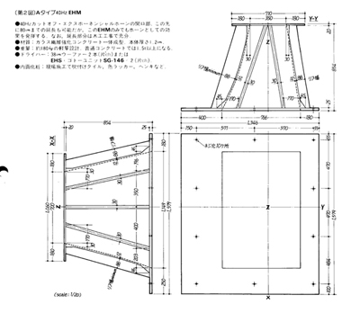

WALTER BURKHARD asked me about constrution drawings from the midbass horn, I'll be answering here...
I used Hornresp to design my 1/2 space 53hz hypex (m=0.6) with 5" throat, the mouth is about 40" x 64" (102cm x 164cm), and length is 8' 8" (264cm). I can't say that I was super accurate when I made this horn but I did my best with the tools available. Construction drawing would be the exported file from hornresp and the paper template I made (see picture).
What is the advantage of a 1/2 space horn over 1/4 space? I mean, theoretically - of course. But we all live and listen to music in boxes called living rooms, not in open space. No?
