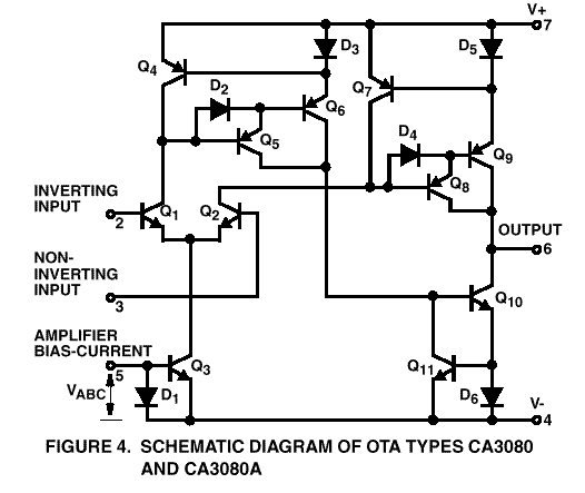

EWorkshop1708 said:
I like your fully mirrored design.
This discrete op-amp is very much alike CA3080 OTA ( Operational Transconductance Amplifier ).
Difference is that CA3080 uses no resistors
but instead uses more advanced current mirrors to achieve precision.
See attachment.

TOPOLOGY and IDEA
is the same.

But between CA3080 and this discrete. As I said, only a few resistors.
TOPOLOGY and IDEA
is the same.

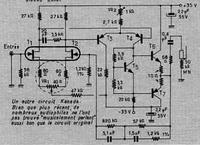

Well let it put it this way : you have a FET differential stage followed by another differential stage with BJTs. This has been done by Hiraga many years ago, so what's new?
The OPA627 has an extra cascode stage in the input which I recommend for various reasons🙄

anybody thinking ...
udip My discrete opamp
topology is more alike OP-Amp OPA627
than it is alike toplogy of OTA CA3080
... has spoken too soon
or does in fact not know the actual topology of CA3080
but it can be found, easily
