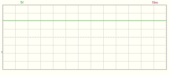

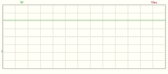

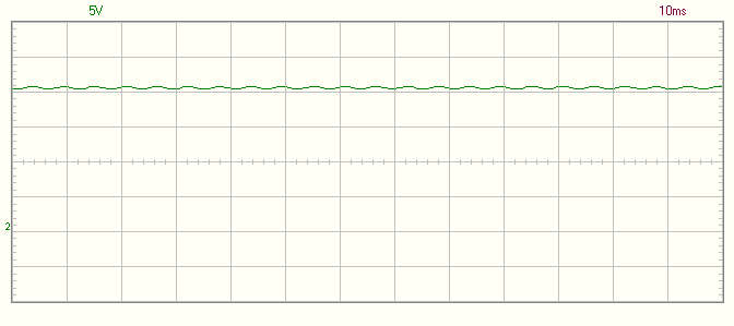

As promised here are the first measurements. I am quite stunned.
Though the capacitor is not connected in the loop, it reacts to whatever I put through the amp. Here I tested with a sine wave.
This wasn’t even at listening volume.
With an EL34 in place I get about the same response. Say that the wave is about 20% larger.
Riddle me this…

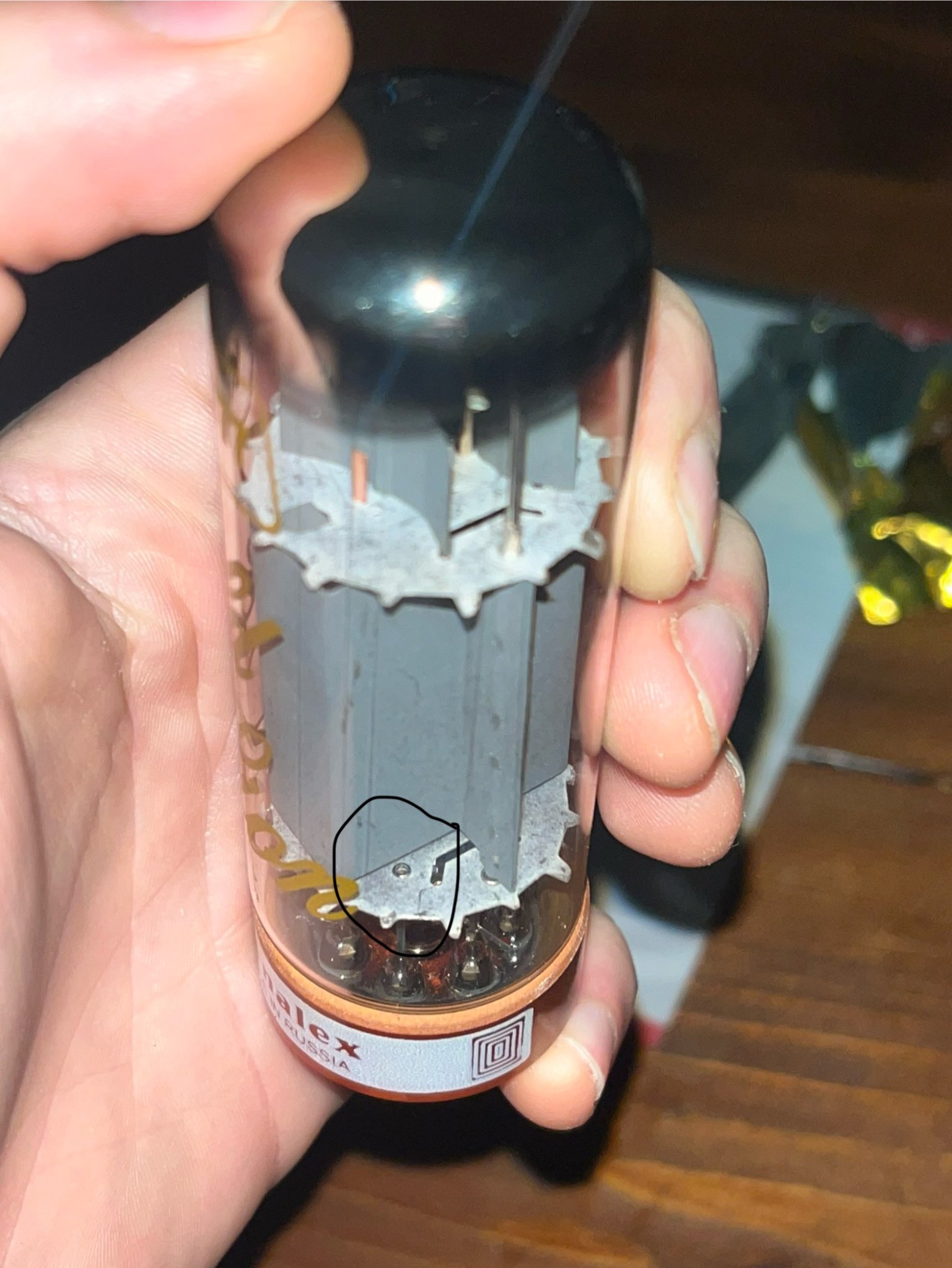

EDIT: Added a picture of the KT77. There is a connection from pin 1 to the baseplate. But no further connection than that. On an EL34 there would be an additional wire going from that base to the surpressor or grid.

This will be my last post regarding this “issue”.
I had some new bypass capacitors I wanted to install which lead to a slightly different internal layout. If I add the Hazen capacitor it has no effect now except the EL34 obviously. Also nothing shows on the scope with the KT77 in place.
Could it be stray capacitance causing what has been experienced here?

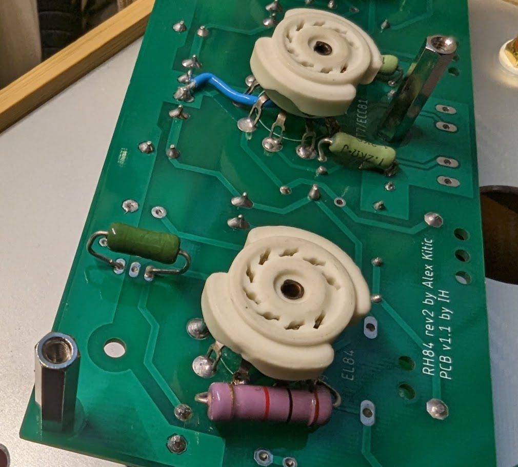

I suppose it might have its advantages. But I'll keep it as is re the cathode resistors. Seen here is the cathode resistor on top for better heat performance (I hope) ..ps should have had the plate resistor for the 6n1p on top as well...but o well...good enough. Also shown is the wire for pin 9 of the 6n1p to ground. (I obviously also had to hack the heater supply on this board because it is was designed for the 12AT7View attachment 1147626
Also shown is the triode wiring of the sv83 because that is also not on the RH-84. Big open soldering pads near the EL84 text is where the zener diode usually goes for the RH-84. Another detail is the Russian mil-spec sockets. I can't bear to use the Chinese stuff.
I have also been using non-PCB sockets mounted on the board, like this. I used loops of wires on the eyelets, and solder both sides of the board. I am presuming that you also prefer to use NOS quality sockets rather then the current ceramic ones which have tight pins?
