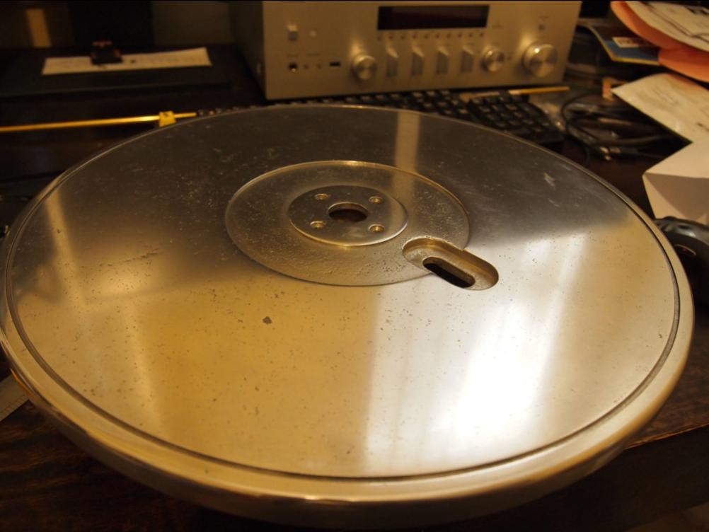

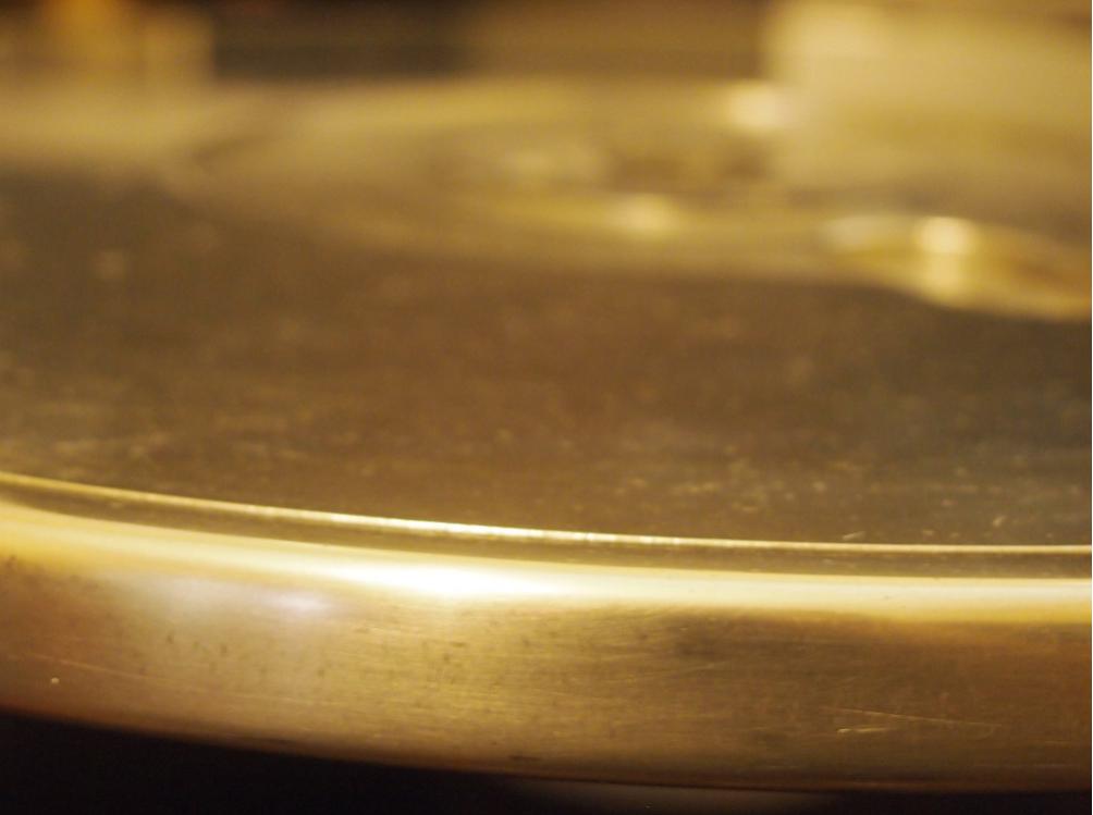

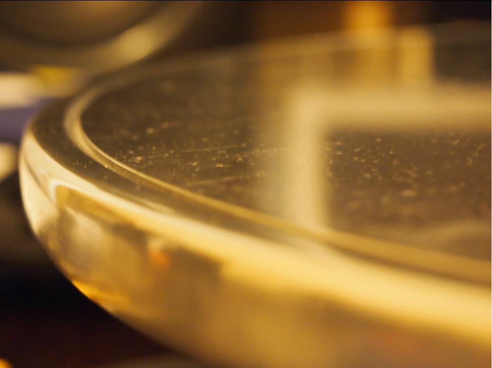

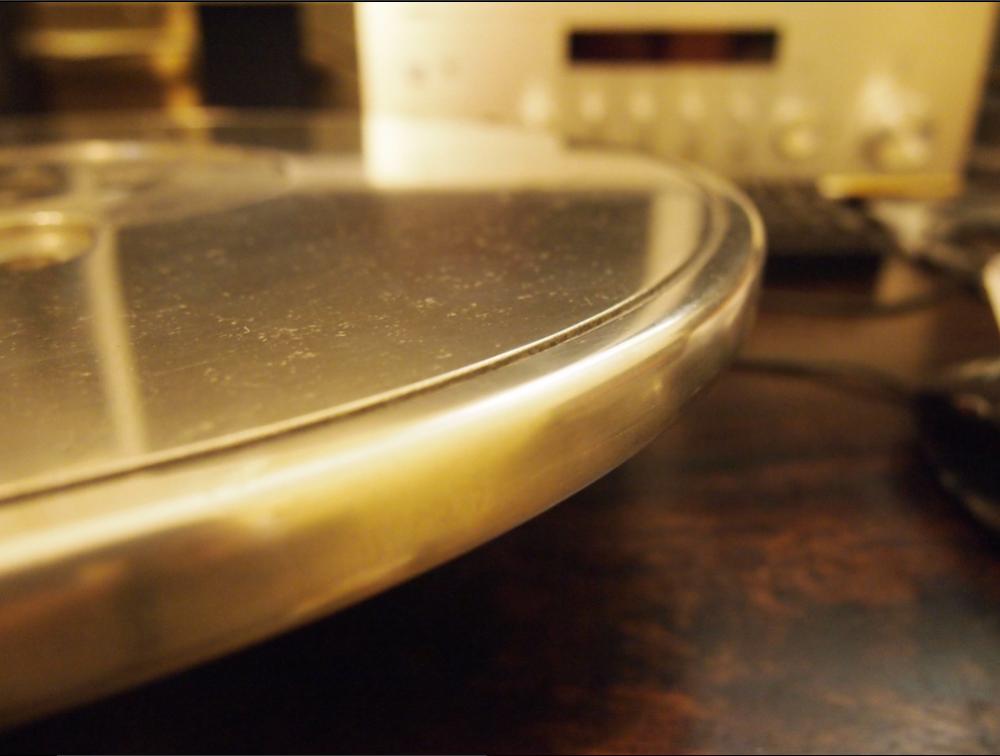

So I spent some time restoring the platter and made some significant mistakes in hitting it with a wire wheel on a drill. It cleaned it up great but scarred the platter pretty bad and I have spent hours sanding out the marks left. I should have just got it hydro blasted.
Anyway, although I don't have great pics of the final result (I am still polishing it), here are some pics of the progress of the platter:
After hitting it with an aggressive wire wheel in the drill, it cleaned up quite nice but I cut some deep marks into the platter which I later came to regret:
Although not the best pics, all the mark are sanded and polished out. This took about 20 hours and I wish I knew about hydro blasting before I did this:
At one point I built this axle and mounted the platter in the forks of this bike. I then used a polish wheel in the drill to spin and polish the platter. This is what one does when they don't have proper tools or money to pay someone else to do it. It worked.
So the platter is pretty much done, I might take it to a professional polisher down the track but I do like the platter to show some battle scars of it's 78 years on earth.

It took some better pics of the polished platter. I am pretty happy with it now although I will run it up against a polishing wheel to get the final marks out of the edge.
