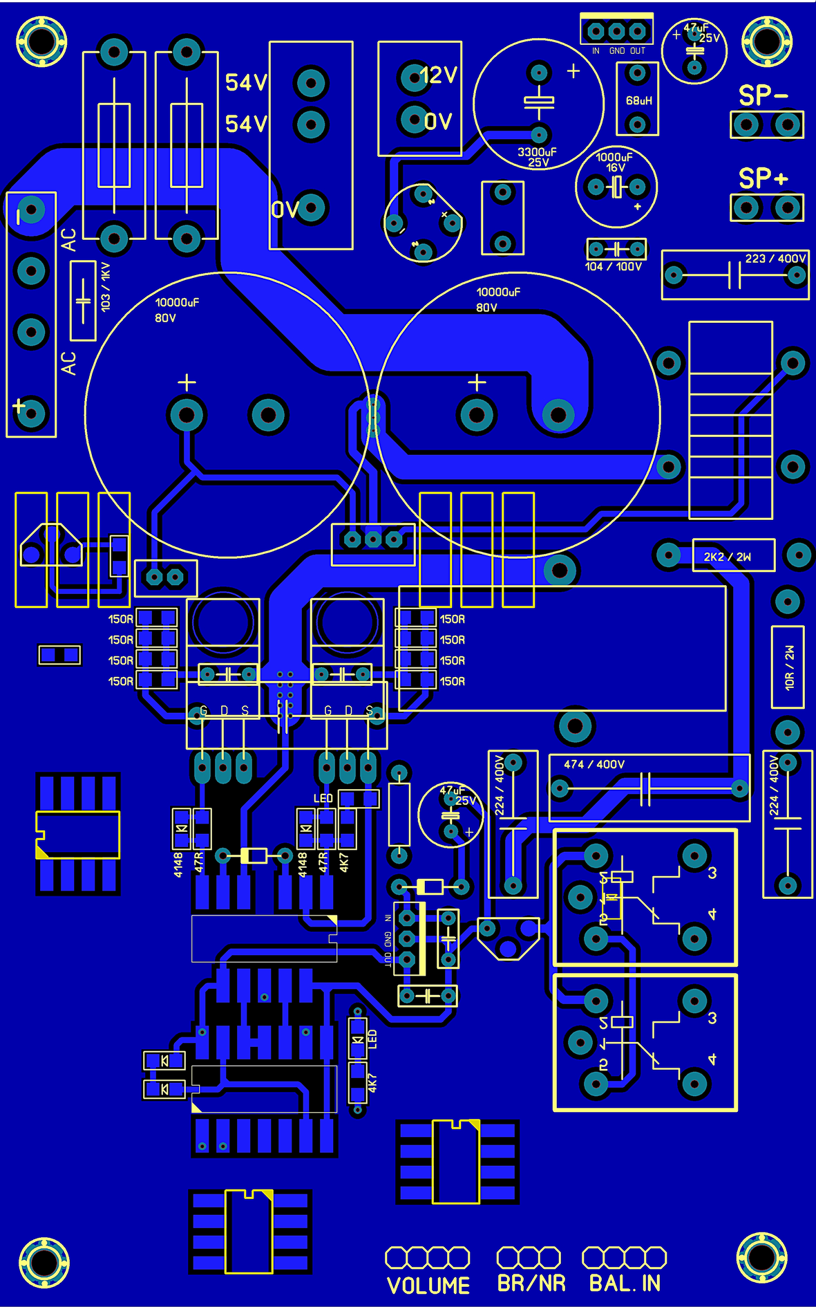

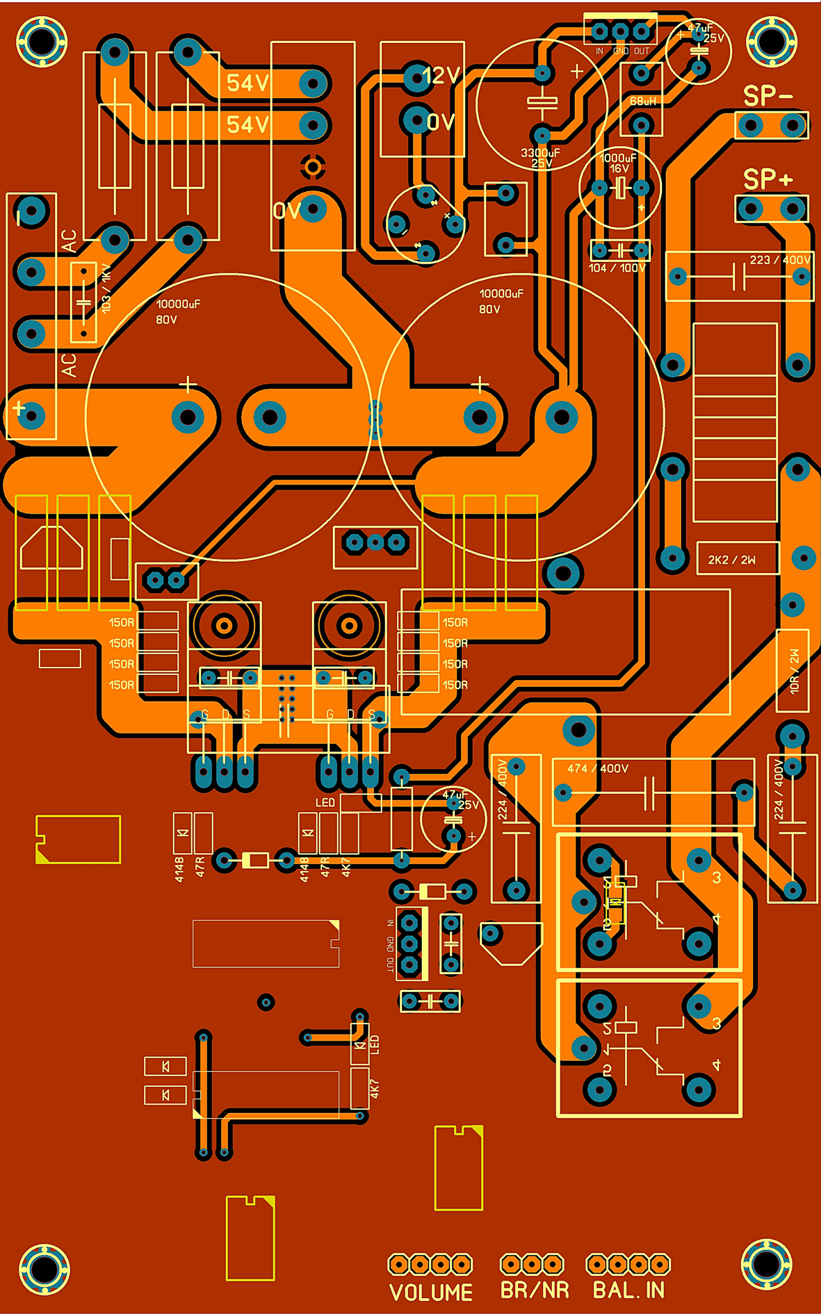

My new dual layer work,not completed😕
any suggestions pls

Nice all in one layout. 🙂
You decided to go SMD, since there's a lot of space maybe you should include totem pole buffer? and TO-247 mosfets? Gate drive should be 1/2W type. So that the DIYers can use higher current capable mosfets.

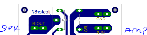

Also bridge rectifier is insufficient for high power. And the parallel relay for speaker protect is not good for class D because they will not turn on/off simultaneously. The speaker should be connected to ground when the relay is off so that when there's DC out and an arc is formed it will be redirected to ground and not to the speaker. Speaker DC protection with relays
Also put various LED indicators for easier troubleshooting.

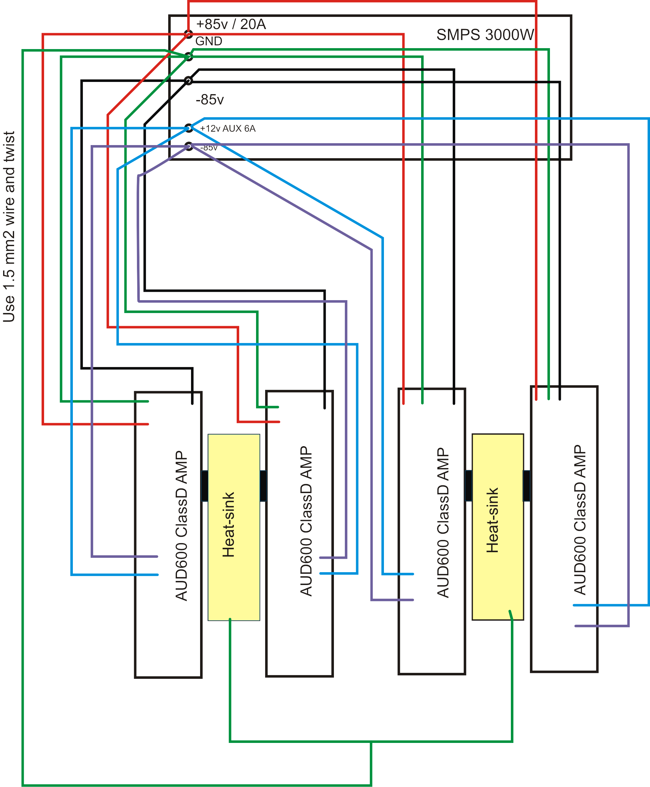

hi manoj have you ever connected 4 aud600 amps with a single power supply(same power supply e.g one +/-75 for the 4 chanels )? and did they work perfectly even though one channel was disconnected from load/speaker?
AUD600 rev1.1 x 3Nos(AUD600 amp and AUD600 power) connected with DC +/- 72V /20A(AC 52v-0-52v/20A) supply rail no problem found.
