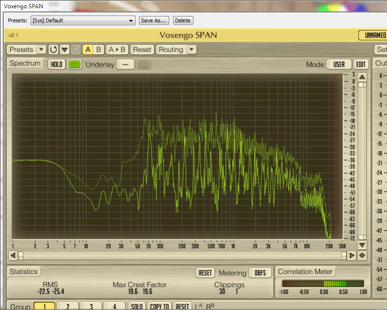

i would like to share this nice vst i found to analyze the spectrum of the ongoing track, it is somewhat desynchronized but very complete and free under win and osx:
Real-time audio spectrum analysis plugin - SPAN - Voxengo
as usual just add the vst to your /program files/vst plugins folder then 'rescan' from the vst wrapper and enable and it should work (should... for it gives me a bug under win7 for i have to set the wrapper to 'bypass' and it will then work just fine to observe)
you have many regulations one important is 'edit' 'slope'
setting the slope to 0db i can see there is some energy going on in the very sub-sonic frequencies, more than i thought... is this something to care about? is it contributing to the amplifier and speaker duties?
here is shoot from Sweet Georgia, Chesky records. how should i read the graph, is it considerable energy there from 1 to 20hz? is it going to the driver?
I think there's more going down there in general than what people realize.
This may be due to the fact that so few systems actually play that low, and the differences are subtle.
An interesting thing to note in that graph is that, despite all the effort people go forth in order to get high frequency response that goes all the way up to 20khz, there's actually notably more output at 20hz than there is at 15khz, let alone 20.
notice that the slope is set to 0, so you can notice how mastering almost naturally respects the loudness curve. the spl required for something below 20hz to be heard/felt would be huge, so no doubt it's not in the hearing range, my concer mostly being around drivers duty, does it count?
