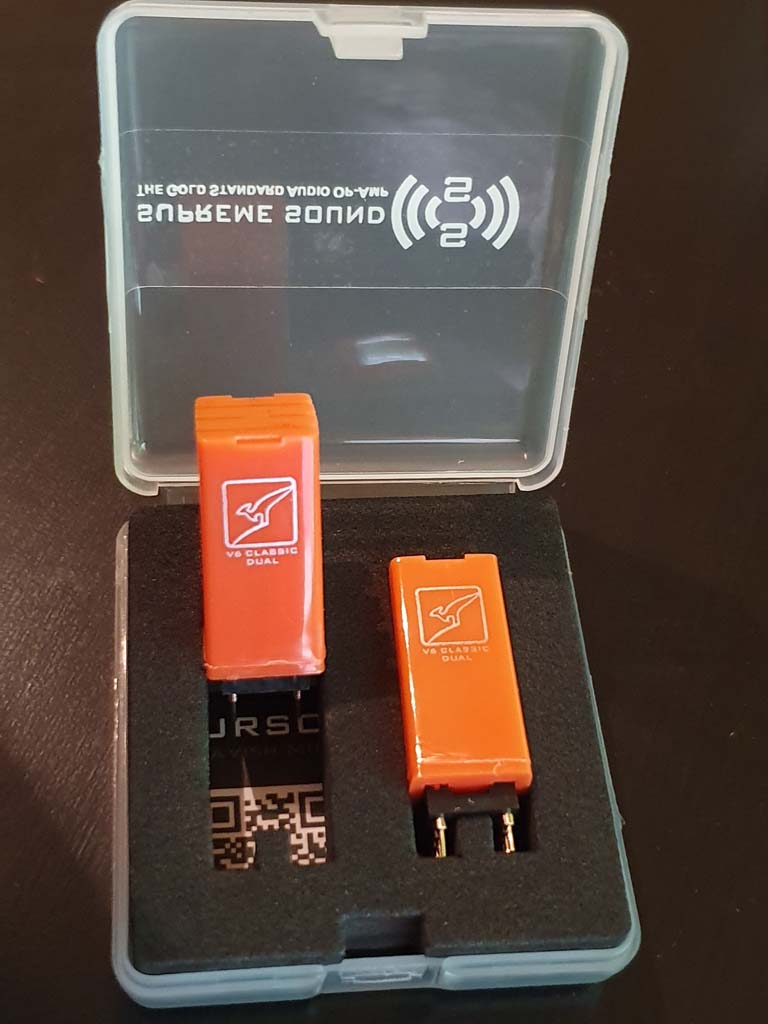

The package took around a month to arrive from Hong Kong. Inside the little Jiffy bag was the product and a couple of zip ties. Not sure what those are intended for, but thanks anyway.
The product comes in a small, hard plastic case with a nice dense foam insert, cut out to fit the opamps snugly. Beneath the foam was a card with a couple of ‘Q’ codes that take you to the product information page on their website.
The first thing that struck me with the product was the logo that it bears. Hmm I’m sure I’ve seen that one before somewhere….

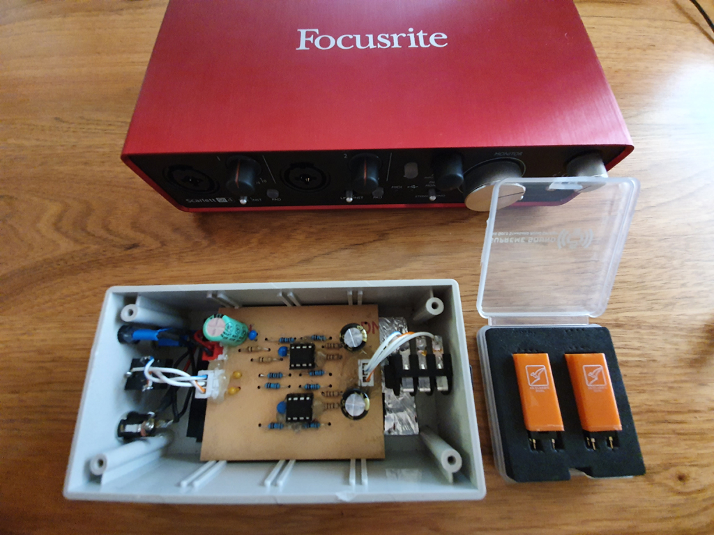

Project

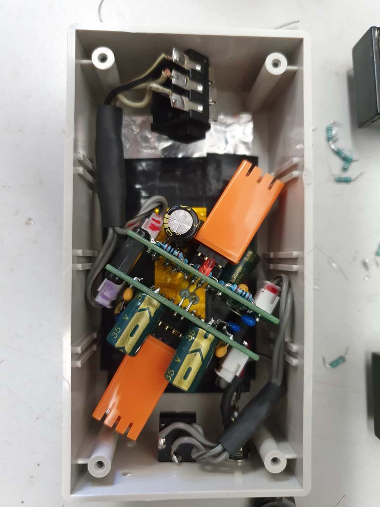

The initial project I chose was to create an inverting buffer to couple with my Korg B1 Buffer (which I use as a headphone amp). The Korg inverts the signal phase and apparently negative H2 distortion is not as nice as positive H2 for some people. When used as a preamp, correcting this is a simple case of switching the speaker lead + and - over, but it’s not so easy when using headphones. I don’t fancy rewiring mine, so a simple NE5532 buffer in inverting configuration is the way I’ll go.

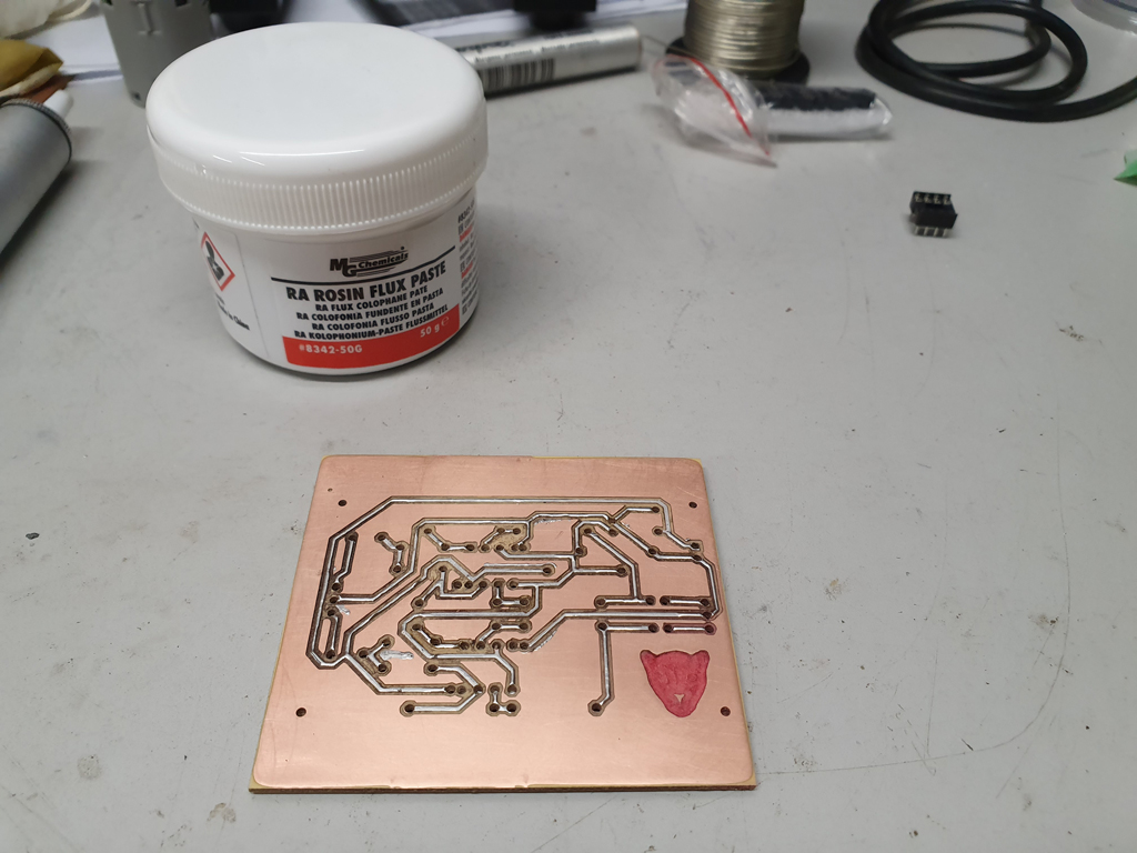

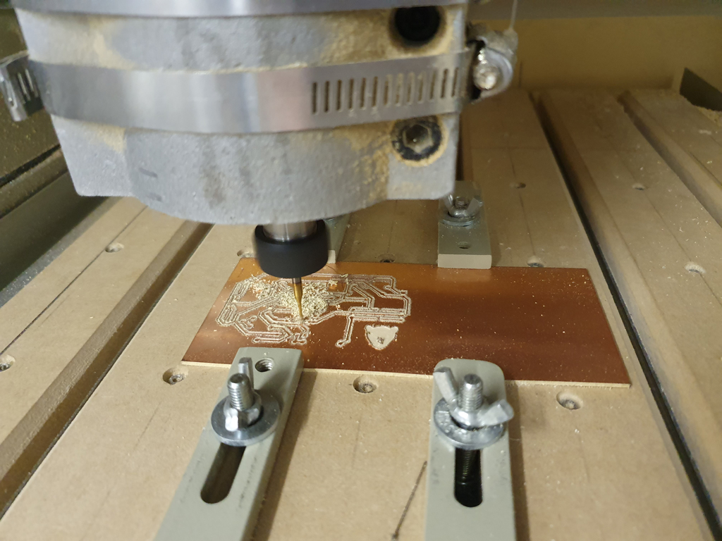

In preparation, I chucked a DC power jack onto the back of the Korg. I am using the PCB from Algar_Emi (GB B1 Nutube PCB with integrated PS) that is equipped with a Meanwell IRM-20-24 900mA power supply that I tapped after the first stage of filtering. The Korg only draws around 60mA or so, so plenty of power left for a couple of NE5532s.

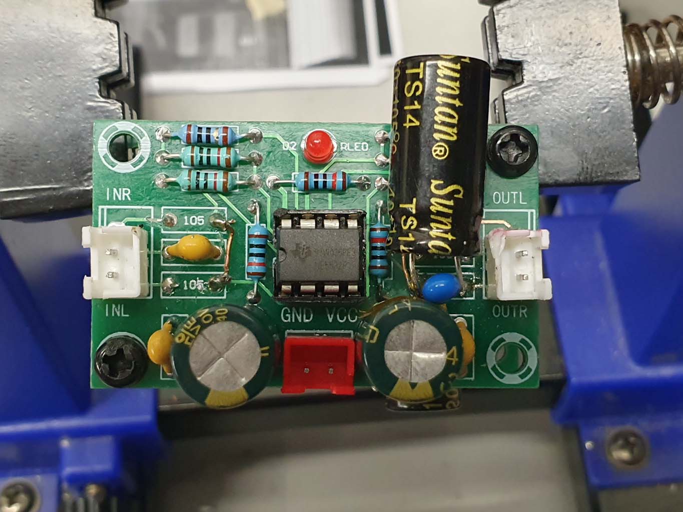

Donor Boards

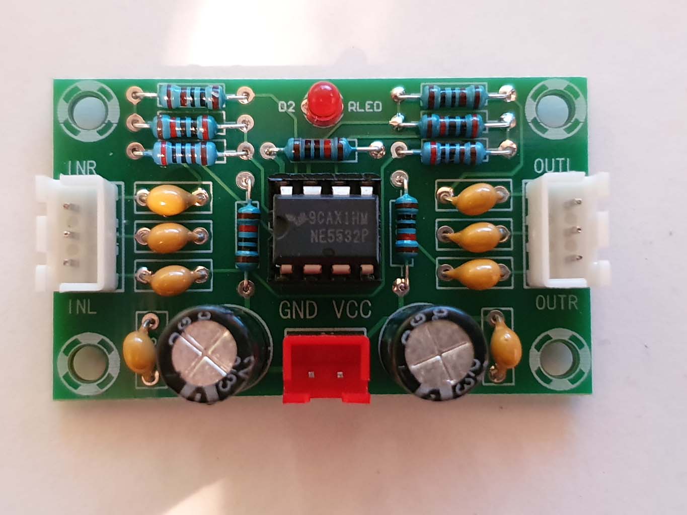

First thing to do was order some cheap ebay NE5532 boards that will suit the task. I chose a single ended supply version with through-hole components for ease of modification, and so that I can piggy-back the 24v power supply off the Korg (rather than needing to create a split supply).
A pack of 5 pre-populated boards set me back $14AUD delivered (or less than $10USD).
Schematic

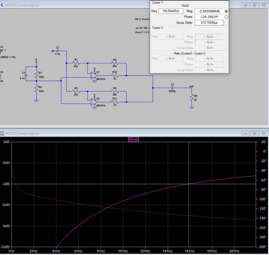

I roughly traced out the schematic from the Ebay board. The capacitor values were higher than expected – 1uF as opposed to 0.1uF from the datasheet. The board is set up as a preamp with a gain of -10 set by way of 2k/20k resistors. There is a 1k at the output of the opamp. As this is a single ended supply, the amp has been biased with a voltage divider at the non-inverting input using 10k resistors – I was expecting 100k in this position, but this seems to work.
Modifications

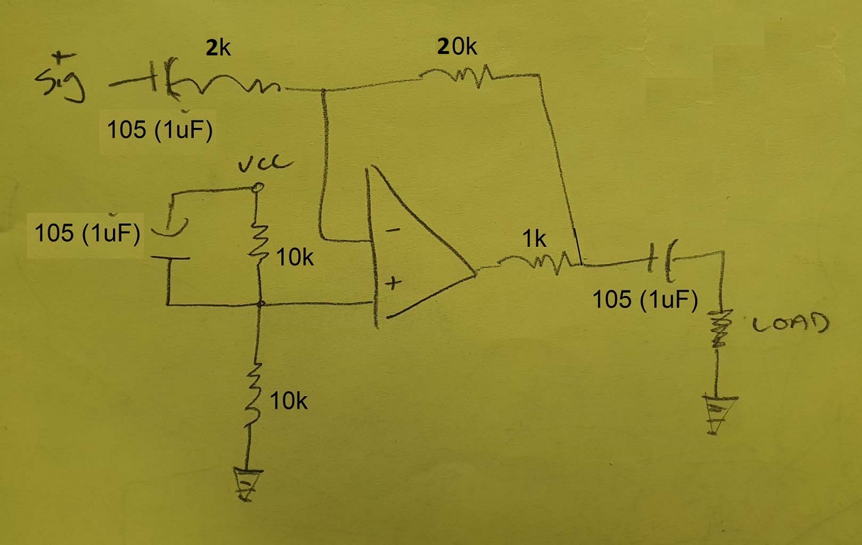

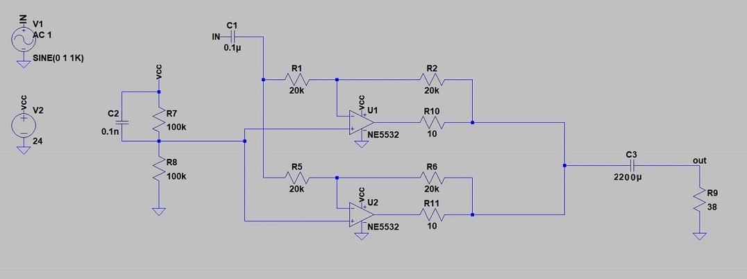

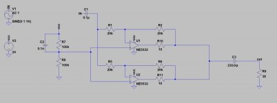

This is the schematic that I’ll be using:

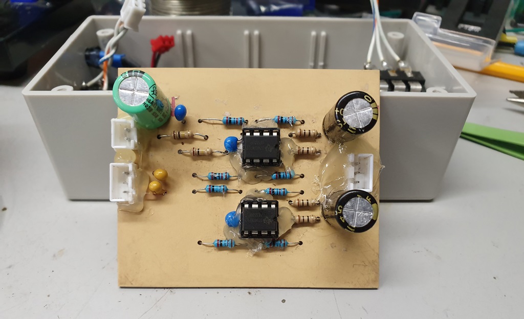

To start with, the Ebay boards are set to provide gain, but I require a unity gain buffer. So let’s set both the R1 and Rf both to 20k. This should provide enough impedance for the Korg to drive.

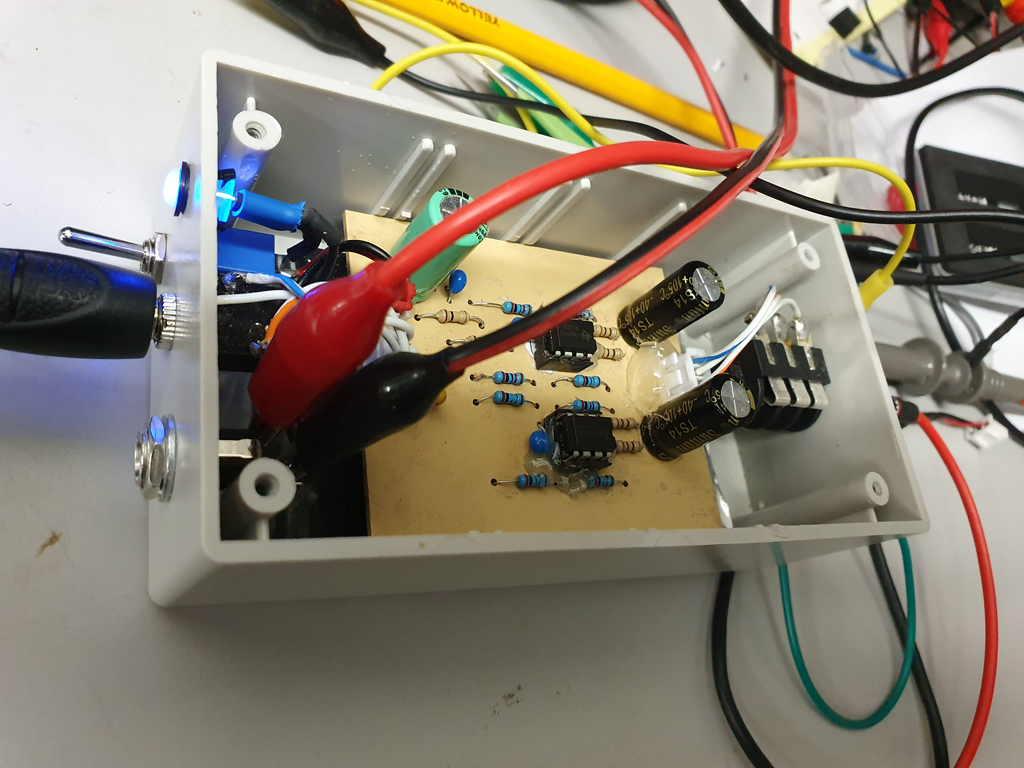

Next, a single NE5532 in stereo mode won’t provide enough current to run a pair of 38Ohm headphones, so I’m going to double up the boards. It seemed like the simplest option would be to mount the boards back-to-back and use one board per channel (rather than paralleling the board channels side to side).
To parallel the boards, it is necessary to place a balancing resistor at the output to stop the opamps fighting each other, so I removed the 1k resistors that were at the outputs and replaced these with 10R 1% resistors.
I changed out the input caps with 0.1uF MLCCs and used 2200uF for the output cap. None of the caps are particularly special or good quality, but better than what was preinstalled. I did leave a 0.1uF cap ‘bypassing’ the output cap, but I don’t see that it contributes anything. The tracks were starting to get fragile, so I opted to leave it alone rather than attempt to remove it.
I joined the L and R channels together and used just one signal coupling cap and one output cap per channel. Boards were mounted to each other using plastic standoffs and the back of the power supply pins on one board were jumpered across to the other with tinned solid wire.

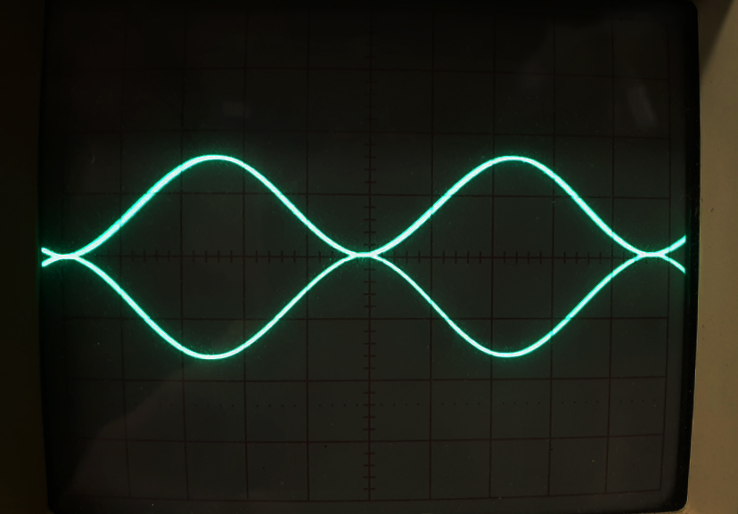

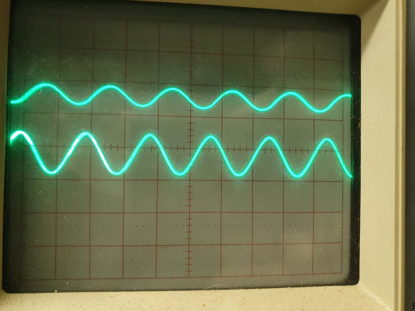

A 24v Bench supply was connected and the amp was fed with a 1kHz sine wave. The output looked fine and so I connected it up to sacrificial headphones with a mobile phone as source.
Using a tone generator, I could tell that the bass starts to roll off a bit under 200Hz, which is what I was seeing in the sim. This appears to be down to the values of the feedback resistor, output capacitor and the headphone impedance forming a High Pass filter, which I’ll play with at a later time.
Thermal performance was good – the SS_V6s heated quickly but only got to around 30-35 degrees (Celsius) after an hour inside a closed plastic box.

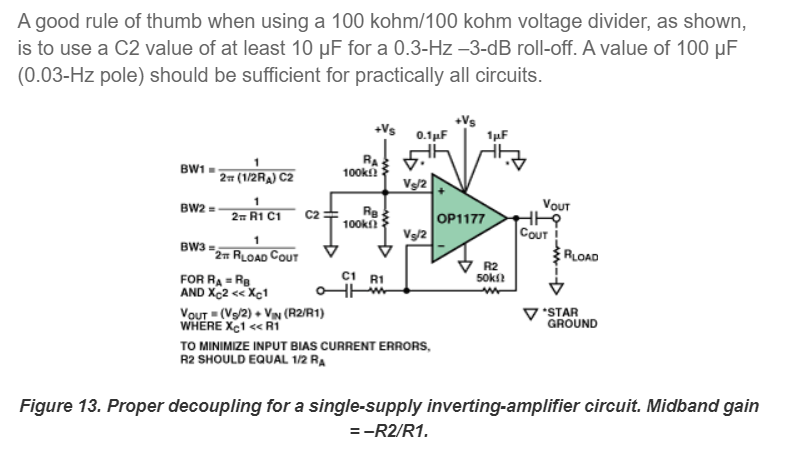

Your schematic shows the virtual ground being decoupled to Vcc, not ground, so that you directly inject rail noise into the input.
Whoops.
And C1 should be more like 2µ2 to avoid losing deep basss.
Whoops.
Good spot, Mark. I'll have to check if it is physically connected that way or just got drawn the wrong way in the schematic diagram.
And thanks for the tip on C1. I was running sims last night with C1 at 1uF which gave me a roll off at around 16Hz iirc. But I'll pop 2.2 there instead and see how it sounds.
Thanks again, this is my first foray into opamps so I appreciate the clues to keep me on track.

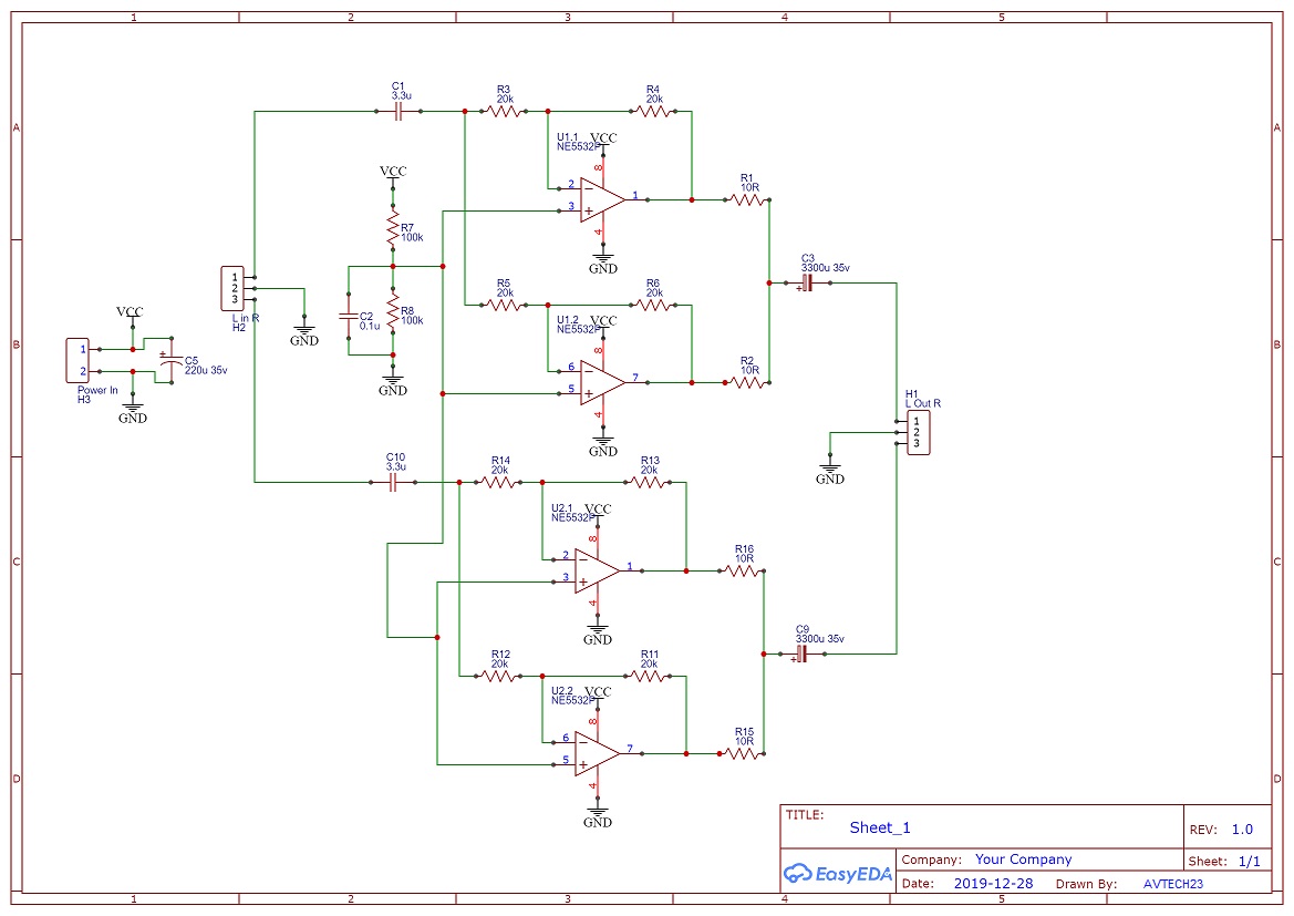

I wonder if it would be worthwhile to place a cap over the feedback resistor to for a low pass filter also - cut the HF that is.
2.2uF caps now installed in the input cap position, and the bass response is much better now. Significantly better.

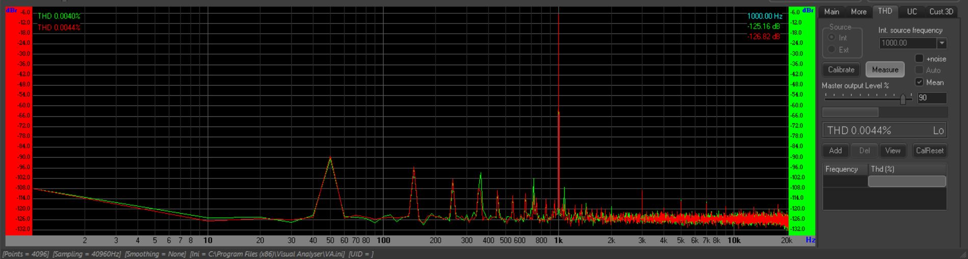

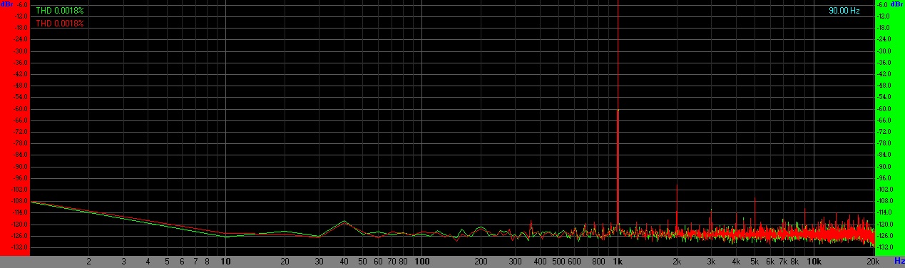

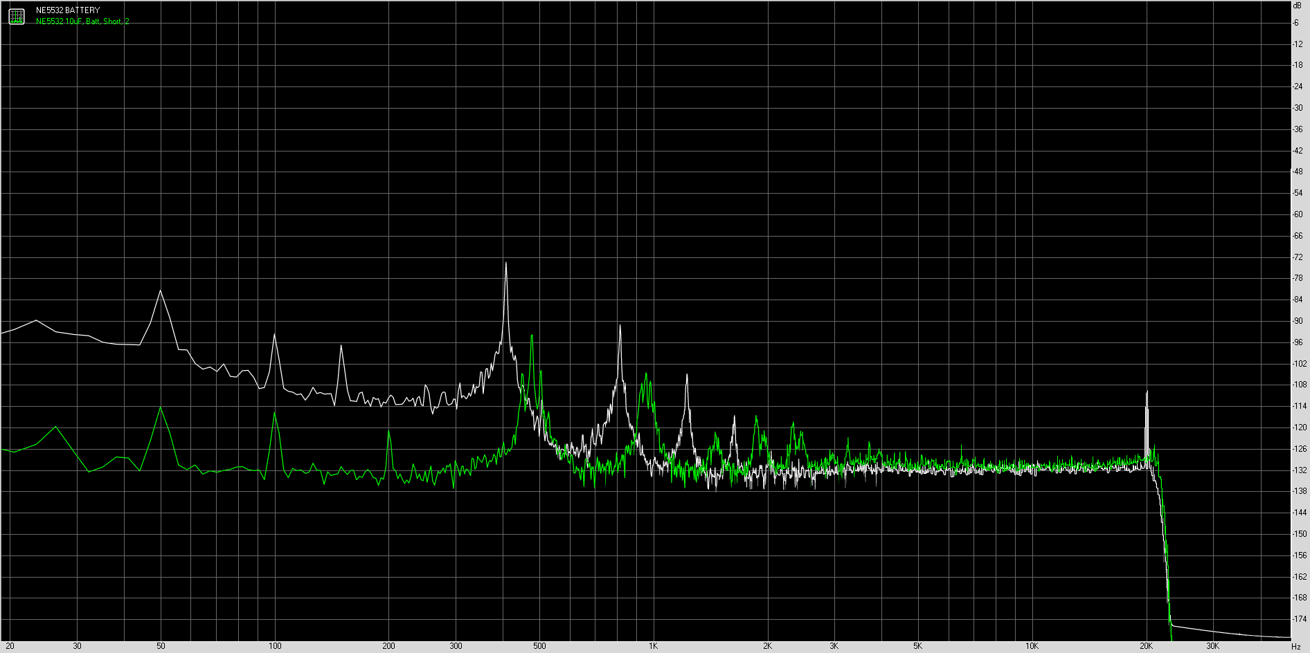

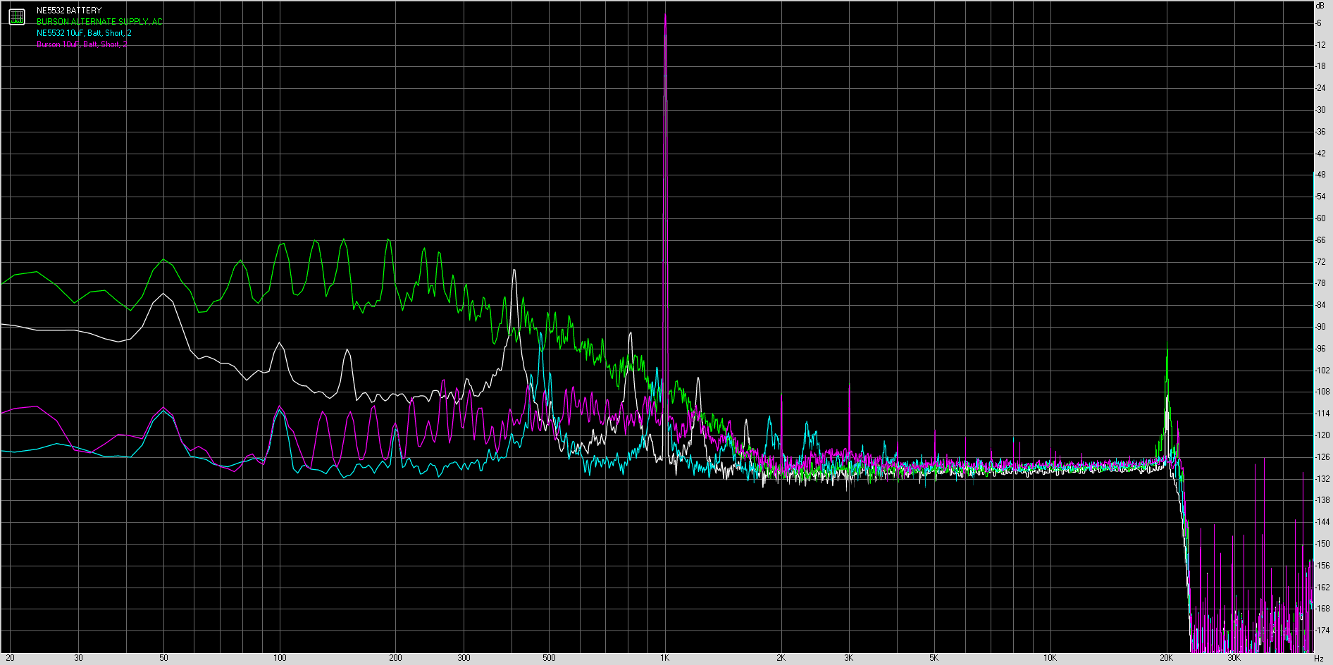

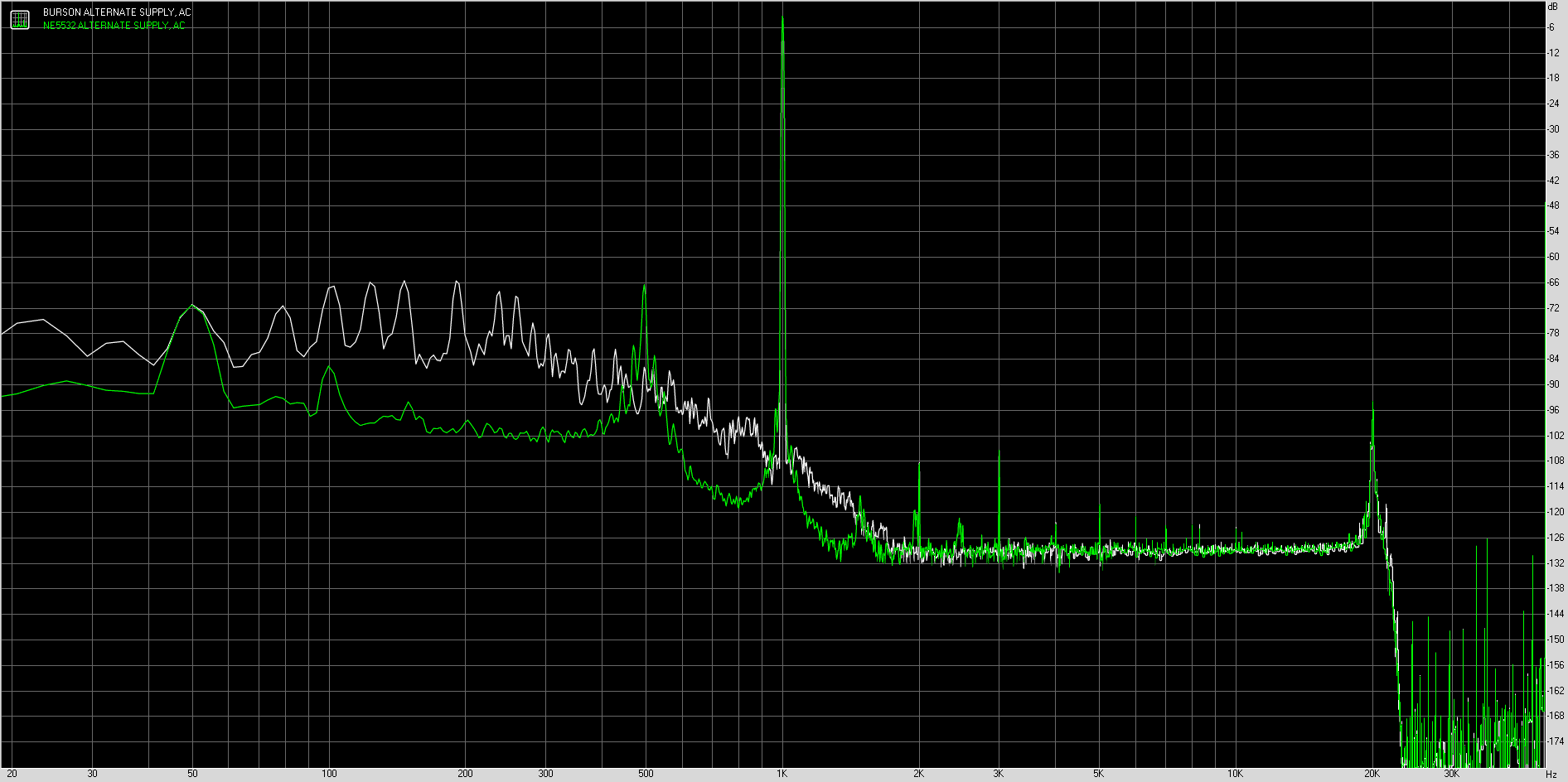

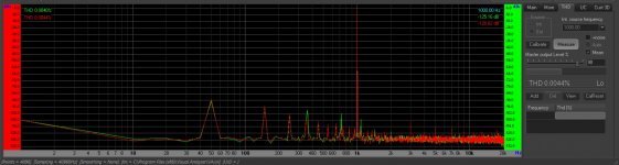

Santa came early and dropped off a Focusrite 2i4 so that I can finally carry out some distortion measurements.

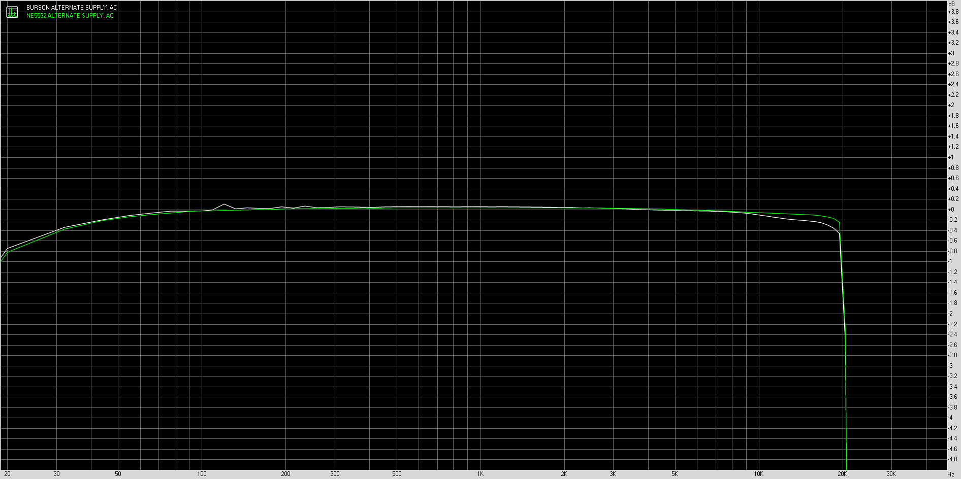

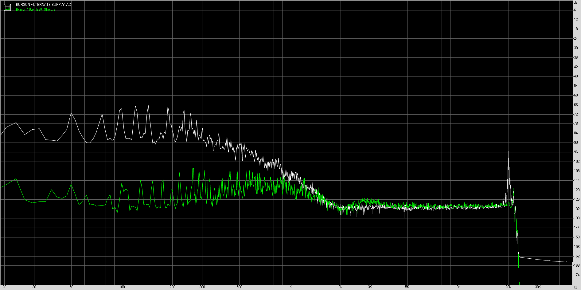

The following measurements were taken with no changes to the test leads (except loopback, obviously) and unchanged local environmental conditions.
The setup was a laptop running on battery power, focusrite 2i4 and 6dB attenuator (input protection).
So starting with the pre-calibrated loopback, we have distortion around 0.0018% and a noise floor of around -120dB:
Post calibration with the NE5532s we have similar noise floor, 0.0040% THD with dominant H3:
And with the Bursons, we have (maybe?) dominant H2 (or is it noise as it is under 2kHz?), THD at 0.0011% with a strange 600Hz peak on one channel.
I'm new to making measurements with the focusrite (this is literally my first go), but I thought I'd share some data anyway.

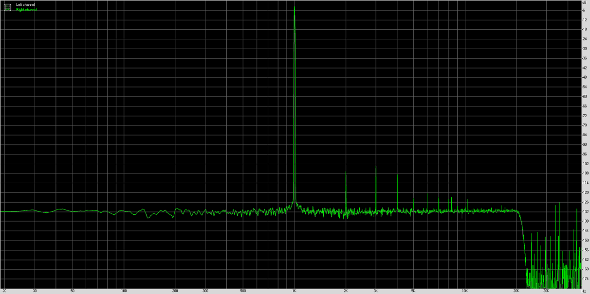

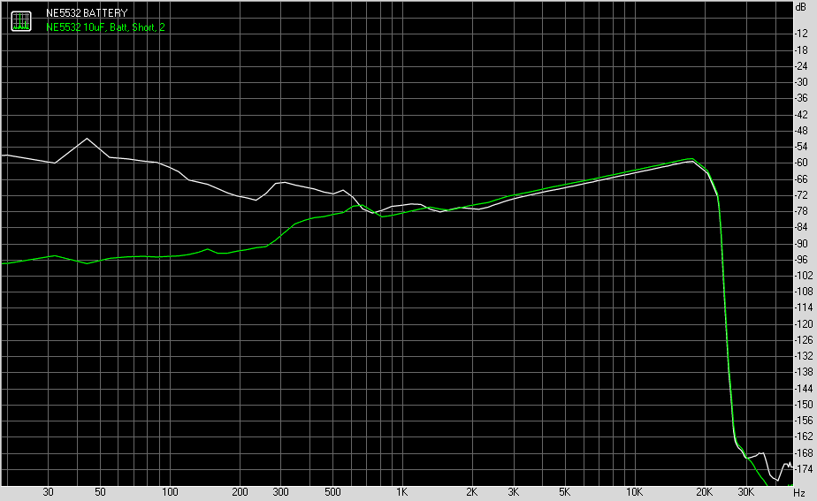

Looking at the peaks they don't seem to match the calculated THD values.
For the NE5532 H2 and H3 seem to be -112 and -104 dB down on the -6dB signal level, which is 0.00068% (ignoring higher harmonics)
and the Burson the peak for H3 is -102dB down from the signal, ie 0.0008%. You have confused a spur at 1.8kHz for H2. That is likely the 3rd harmonic of the strange 600Hz signal.
The wide base of the 600Hz signal signals high phase noise, indicating its a free-running oscillation of some sort, not derived from a quartz crystal timebase. Alternatively that spread of the peak might be due to using an inappropriate FFT window with spectral leakage.
I suspected the peak at 1.8kHz was from something else.

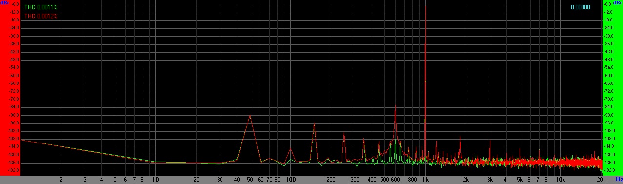

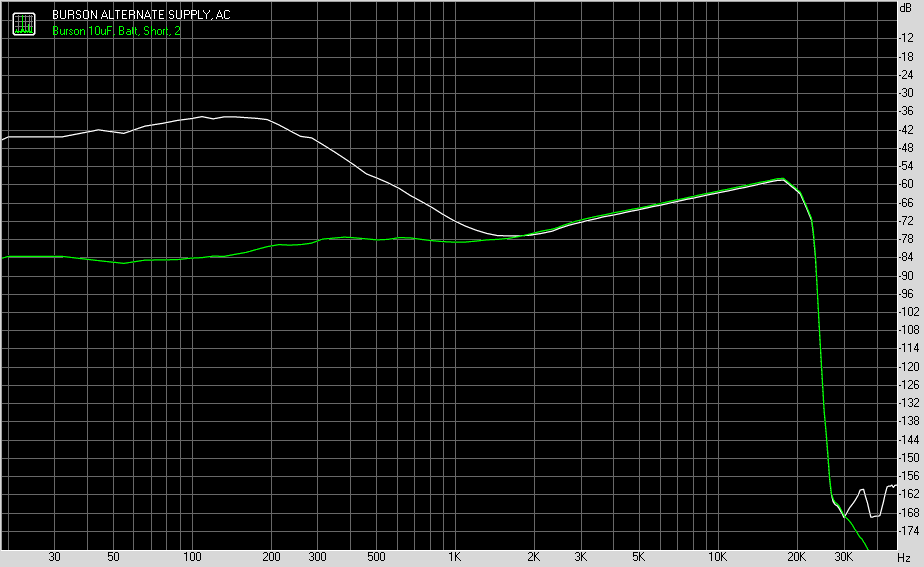

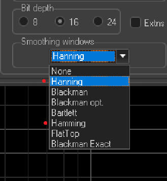

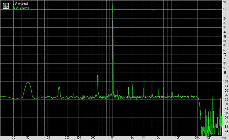

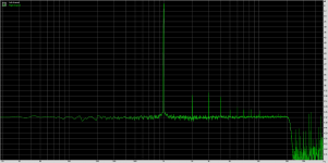

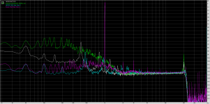

Today I had a go with RMAA to see if it makes a difference.
Here is the loopback:
As you can see, there is no 600Hz bump and 50Hz filtering is good.
Next is a single channel run with the Burson installed:
RMAA puts THD at 0.00124% on this run.
Note the 600Hz peak is there again although it actually measured on RMAA at 550-570Hz. When measuring both channels, the RH channel was considerably noisier than the LH. Something else to investigate.

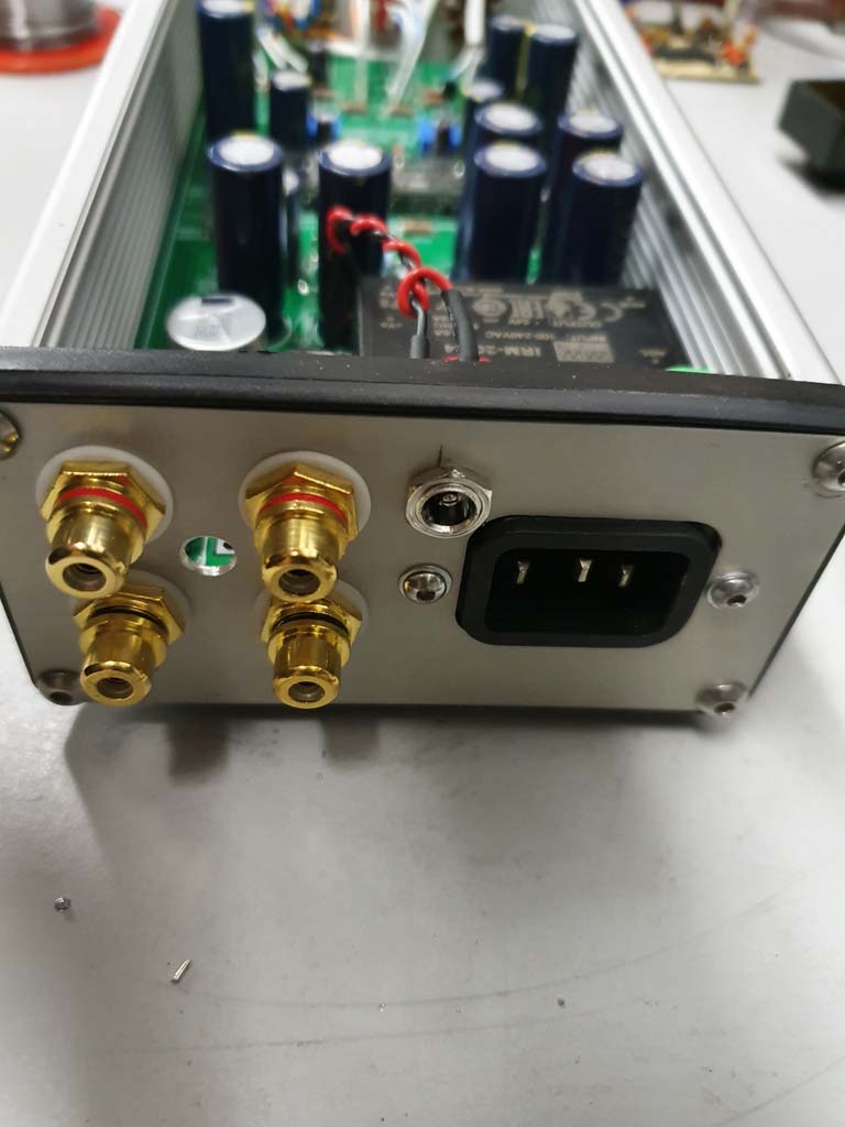

The 600Hz might be coming from the fairly cheap SMPS (which is passing quite high 50Hz noise). I'll have to run the tests again with a different supply when I get a chance.
I believe I had Hanning selected for this one.
OK the Hann window (named after Julius von Hann) has fairly good spectral properties. Its not highly accurate for peak-height though, expect upto -1.4dB peak height error if signal frequency doesn't divide FFT rate.
People get confused by the Hamming window (Richard Hamming as in Hamming distance), and rename Hann as Hanning!
If you want exact peak heights there are flat-top windows available.
For noise floor measurements Hann window is a good choice BTW.
Seems the creator of Visual Analyser was confused too!

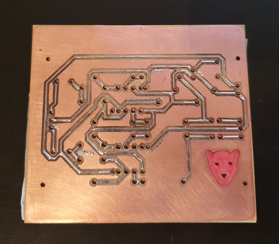

Whilst I await parts for the second project, I thought I would refine the first project into something a little more stable.
In the space of a couple of hours, I installed EasyEDA and fumbled my way around until I created my first from-scratch PCB design. Needless to say, it won't be the best layout or the most professional (or even work!), but I'm gonna have fun anyway.
Just a reminder, this is an inverting, unity gain buffer using 2x NE5532 in parallel to boost current handling. The change in this version is that the parallel happens within each chip instead of half one chip parallel with half the other chip - i.e. now it is one chip dedicated per channel.
I'm using this schematic (similar to the earlier final scheme minus the 'whoops' - thanks Mark!):
Once I came up with a single-sided layout that didn't require extra jumpers, I went about milling the board. (I have an old bottle of FeCl3 but I don't have a laser printer at home to do a transfer..!)
I chose 1mm tracks to make the board machinable, but it still took some fine tuning to get right. The copper layer is only 0.035mm thick, but the PCB itself deviates by perhaps 0.3mm across the height. This means that the cut was a little deeper than perhaps ideal, but nonetheless, it came out ok (for a first attempt).
Once chopped to size and tinned, it was time to stuff. (BTW, good flux makes tinning the tracks so much easier).
Installation of components was fairly straightforward with a little care needed due to the lack of pads and vias. Hot-snot glue provided the mechanical fixing for the connectors.
And yes, I did use tants for the input coupling caps. (I didn't have any appropriately sized PPs).
Once it was assembled and put in the existing case, it was time for the first turn-on test.
It actually works!
Hooked up to a 1kHz sine generator and the oscilloscope, the amp looked like this on each channel:
Time to hook it up to the test rig and see how it performs:
So for the NE5532 I got:
THD: LH = 0.00108% , RH = 0.00121%
THD + n: LH = 0.08697% , RH = 0.08468%
THD + n (A): LH = 0.05716% , RH = 0.05569%
Noise: -71dBA
Cross-talk: -74.9dB
For the Burson:
THD: LH = 0.00107% , RH = 0.00116%
THD + n: LH = 0.16568% , RH = 0.16120%
THD + n (A): LH = 0.06512% , RH = 0.06333%
Noise: -69.9dBA
Cross-talk: -69.5dB
And the THD graph: (No idea what is happening to the Bursons at low frequency, but doesn't look good).
And a reasonable frequency response curve:

(* The ebay boards had awful hum when driven by a plugged in, grounded laptop - even though the amp runs from a double insulated SMPS).
Noise: -71dBA
Cross-talk: -74.9dB
For the Burson:
Noise: -69.9dBA
Cross-talk: -69.5dB

I finally got a chance to sit and read through the excellent Analog.com article: Avoid Common Problems When Designing Amplifier Circuits | Analog Devices which had a very good suggestion regarding supply decoupling:
Many of the examples online and textbooks suggest using 100nF decoupling at the voltage divider which mislead me.
So I replaced the 100nF with a 10uF and the results are as follows:
(White is before, Green is after).
[Noise NE5532]
[Noise Burson]
[Crosstalk NE5532]
[Crosstalk Burson]
[Noise Overlay NE5532 and Burson]
The figures being:
NE5532 100n Noise -72.0dBA Crosstalk -75.7dB
NE5532 10uF Noise -91.3dBA Crosstalk -78.8dB
Burson 100n Noise -69.9dBA Crosstalk -69.5dB
Burson 10uF Noise -92.7dBA Crosstalk -78.8dB
As can be seen, using the correct value capacitor for the voltage divider bypass results in a marked change in the noise levels present in this circuit.

Odd that there's some 400Hz motor-boating with the NE5532? Something's up there. Perhaps the extra decoupling on the discrete opamp is changing the setup. Do you have the full schematic for the test-jig?
