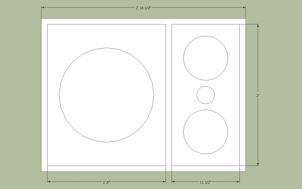

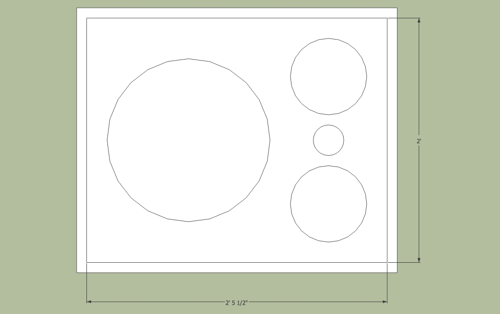

I have built a couple of cheap full-range speakers in the past, nothing fancy... Now I'm building studio for my friend, incorporating three way speakers, custom built into the walls. The room is approx 13 x 19 x 9. I am not at all experienced at this, but I'd like to think I'm playing it safe, because the system will be sealed, externally tri-amp'd with a speaker management processor... I believe sealed designs are safer for the inexperienced builder and the crossover is totally variable, with additional equalization for room tuning... My expectations are modest... I want a bloody loud speaker that doesn't distort at high SPLs. Primary purpose is to impress clients with sheer volume... critical decisions will mostly be made on the powered Mackie two way stand mount speakers... A Genelec or other professional monitor of approximately this configuration will easily work out to 4x as expensive as this system... I don't expect to get anywhere near that level of finesse, I just want a loud, clean system that can serve up enough accuracy to be an alternate reference monitor...
I have already bought the following:
* two pairs of Exodus Ex-Anarchy mid-bass drivers - these will be wired in series (3-4 ohms resistance, if I understand correctly) and be powered by a Peavey IPR 3000 or IPR 1600, depending on advice from the more experienced...
* one pair Tempest X-15 sub woofer drivers... to be powered by a Peavey IPR 3000, for 1000w @ 4 ohms per side.
* I have not bought the tweeters yet, but almost certainly, they will be Morel ET 448, based on their great power handling capability (1000w max)... In the studio, there are untamed high frequencies on a regular basis, and I need the tweeter to be really robust. These will be powered by a Peavey IPR 1600.
The drivers will be crossed over, equalized and protected by a Peavey VSX26. I have measurement microphones and meters.
Some questions:
1) Being an absolute n00b at this, am I making any obvious mistakes? Please remember I am trying to play it safe and keep it simple. I'm not looking for any delicate audiophile quality deal. Just something muscular and honest.
2) Is the IPR 1600 sufficient to power the mid-woofers or is an IPR3000 recommended?
3) The manufacturer (or the guy who answered my mail) suggests that the subwoofer be mounted into a separate enclosure from the mid-woofers and the tweeter... Is this necessary?... I could get a lot more volume for the subwoofer cabinet if I did not have to separate it from the other drivers. Please see attached pics... The one with the walls separating the drivers leaves the sub with a volume of 141L, which will have its -3 dB point @ 18-20 Hz, in room... This is OK by me, particularly since I expect at least 3 dB more efficiency due to 'half space' room loading... However, I'm greedy for the extra volume...
4) This particular tweeter, the Morel ET448, do I have to seal it in a separate enclosure?
5) At this time, I'm thinking cabinet will be made from 1" Bison board, which is a "cement bonded particle board made out of 62 % cement 28 % wood"... Its cost, mass and availability make me think its a good option... Any comments?
6) Any tips to optimize this project?

Your midwoofers are 8 ohms nominal. Wiring in PARALLEL will get you 4 ohms nominal. Series is 16 ohms.
The IPR 1600 is well over what you need to power the mids. Consider something in the 200W range. That will still give you more than enough power to destroy the midwoofers.
Sub placement is not optimum high on the wall. you'll get more output and probably smoother overall response with them near the floor. If you're going for that look, it won't kill the sound, but you could do better.
No the Morel does not need its own enclosure.
Bison board sounds interesting, but don't forget the bracing anyway.
Protect your tweeter with a crossover as high as possible and steep slopes. If the midwoofers are smooth enough up high, try a bit over 2KHz. It will be interesting to see what the Anarchy can do.

That is the lowest powered IPR there is... don't want to mix and match for logistical reasons... Guess I just gotta be careful not to overload the drivers...
I'm looking at it as a 3-way, rather than a sub+sat system... Like "Mains" in any pro studio...
thank you for the clarity...
I was hoping to crossover even higher... lets see how it goes...

The enclosure for the sub can envelope those for the mid and hf drivers, though each driver should still have its own enclosure.
Of course! such an obvious thing and it never occurred to me... thanks!

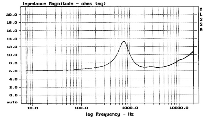

Also please find attached the impedance curve of the ET448 (which, for better or worse, we have already bought)... There is a sharp peak in impedance around 1 KHz... Do you think these factors will become an issue?
Thanks again,

See the audibility of capacitors thread - I tried mine with and without with an amp I trusted and didn't hear a difference. I still managed to blow the tweeter by turning things off in the wrong order. IMHO, any audible effects are worth the cost of blowing tweeters if you don't turn the amp off first or get some other form of turn on/off thump. BTW, the caps i used are AEON and SCR from Zalytron.
Your crossover allows you to get a wide variety of slopes, you can either incorporate the blocking cap into your scheme or not. I would recommend zoebels to flatten both the resonant peak and the rise above 4K if you try to use the blocking cap as a filter pole. Easier to make it big and do all your filter functions actively.
